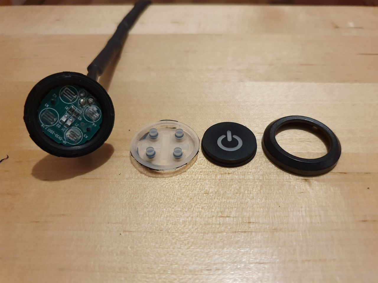

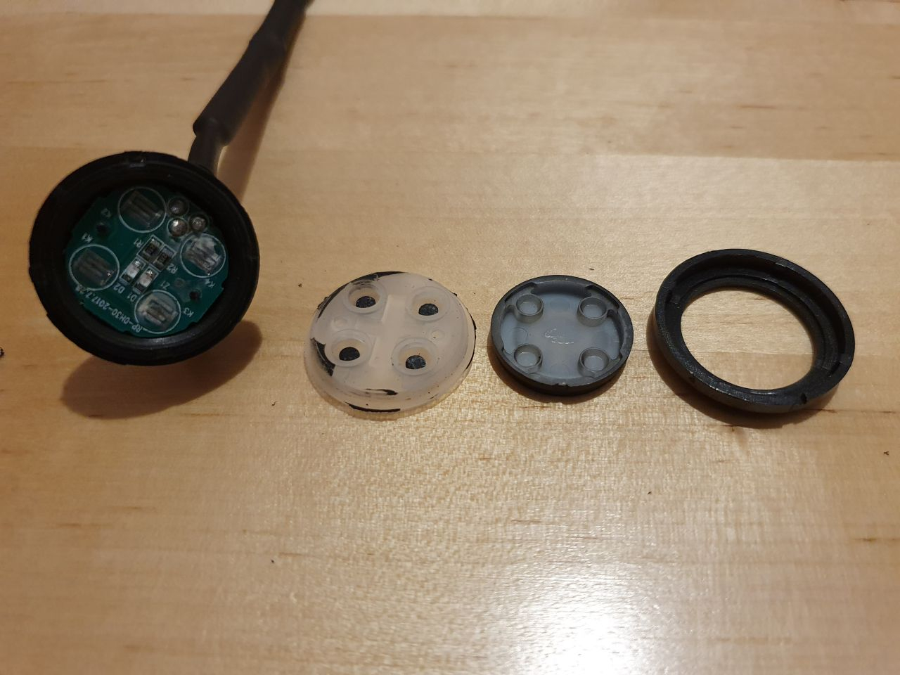

My "Start" button is not waterproof. :(

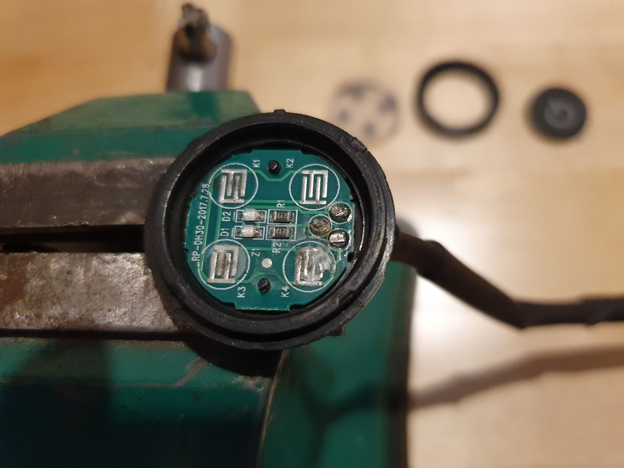

Tromox MIno "Start" button.

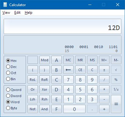

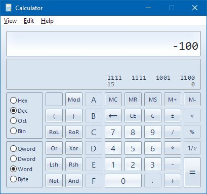

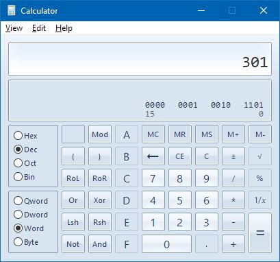

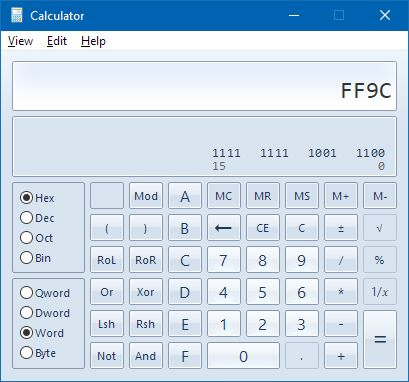

You don't need the third column, it a pure binary file without any comments and structure. At first assume it consist from 16 bit values (two bytes, left MSB and right LSB), then try to convert the value to decimal. Use Windows Calculator at programmer view. Select hexadecimal, select 2 bytes, enter value, then switch to decimal and write the value.
Any value started from F (bit 16 = 1), for example FF 9C, most likely is negative, FF 9C = -100
If you did not get reasonable value, most likely it is 1 byte value, for example:
0106h: 6E : High-Speed Percent (110)
0107h: 43 : Middle-Speed Percent (67)
0108h: 3C : Low-Speed Percent (60)
0109h: 32 : Fourth-Speed Percent (50)
010Ah: 32 : Speed Limit Percent (50)
010Bh: 00 : ???
