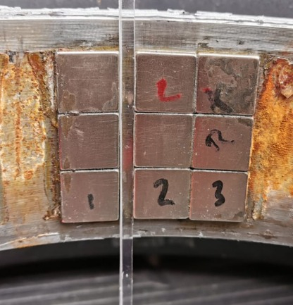

FWIW I tried measuring the height of the magnets, and there was nothing to measure. I was hoping it was a way to tell which ones need to be changed, but, no, you cannot tell from this. You have to actually remove them to see. They can be clean and shiny, but rusty underneath.
They do not need to be standing high. Just that adhesion/cohesion became so weak that the magnets must have been moving as the motor rotated.
They touched because the magnetic forces were stronger than the rust and they rippled as the motor rotated.
The glue I am using, AA326, is a polyurethane methacrylate (slightly flexible so does not fracture with stress and heat) which cures by anerobic process, single component, and a secondary cure using an activator which comes as a 30% acetone solution. So I basically used the curing accelerant as a cleaner, spraying it on then rubbing the surfaces down with a coarse sponge and spraying a further coat. They seem glued on very robust. I suspect if I wanted to take these off then they will have to be chipped off and broken. Many times stronger than the rust!
I have also experimented with cutting out polycarbonate filler to go between the magnets (as they are smaller). I don't think it is needed now but I have already had this problem twice so why risk it? I can make this filler, I have the materials, and this glue is also good to bond polycarbonate to aluminum, so the instructions say.
