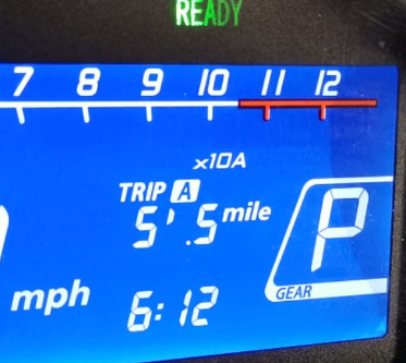

Well, I adjusted all the PID values to try to reduce this torque ripple/cogging, but the values seemed to have no effect at all. I spent an hour trying various combinations, nothing.
And, the start up error, 'bip .. beep', and no 'system OK'. Something is up. No idea what, but I did not realise, is the dash trying to tell me something?
Screenshot 2026-07-17 8.42.18 PM.png (145.85 KiB) 613 mal betrachtet
I also noticed that before when I disconnected the battery (to try to clear errors) with the isolator, turning it back on the alarm gave a shriek. But, no more. I turn the isolator on and .... I no longer get deafened by it!
