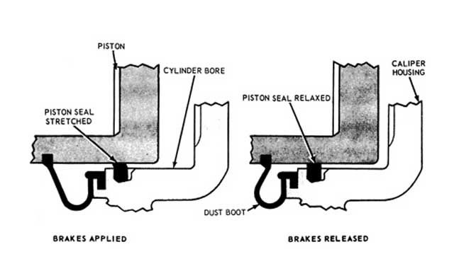

bob2.0 hat geschrieben: Fr 18. Okt 2024, 13:51 I did take the calipers off and they seemed dirty/rusty.
I usually clean pistons on new (to me) bikes, but it must be some deep corrosion that a quick clean up (push pistons out with lever) won't reach.
Design of calipers is very simple so easiest way to make them work is to take pistons all out and clean them + inner side of calipers.
Main work is on rubber seals that retracts pistons back.
Check them and be carefull when putting all back together, I am not sure whether it is a common diameter to be able to buy a replacement. Any youtube video should help.
