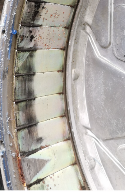

bob2.0 hat geschrieben: Mi 19. Feb 2025, 14:01 I am sad about my motor's magnets going rusty. (In another thread)
Has anyone else had motor problems, or replaced it?
I have emailed Matador about a replacement. They offer a shipped price to UK, but are not replying.
I have emailed QS that I am not happy about the magnets rusting, they just want to sell me another motor.
The problem with just getting another motor is that it will have the same design defect. I would like QS to first agree it is not acceptable.
It makes more sense to me to learn a way how to repair the design fault than just buy another one.
But, maybe it is just me. The one and only me! I always worry about strange things going wrong, and they go wrong!

Zimmermännche hat geschrieben: Mi 19. Feb 2025, 20:50
Aber vielleicht ist ein neuer Motor keine schlechte Idee, denn du hast ja noch eine alte Variante, die meisten von uns haben ja eine Variante wo die Kabel anders zugeführt werden (egal ob QS oder AMR von welcher Marke auch immer).
Korrigiert mich gerne wenn ich hier falsch liege.
I like the new sealing arrangement.
(However, it requires a specialist seal.)
But the issue is not water entry. There is no indication at all of any water entry.
It can only be condensate and water vapour.
It is the magnet plating which was defective. One magnet rusted in the middle of all the others.
The plating on the back of the magnet had been damaged when fitted, then humidity made it rust.
Some of the magnets are fine, others have spots of rust. The one that swelled on the back doesn't actually have any dots, but you can see it, the lower one in the picture.
I am sad because this is bad manufacturing. QS only want to sell me a new motor.

bob2.0 hat geschrieben: Fr 21. Feb 2025, 21:38 ....
Might it be that the rim of the wheel is no longer exactly round?
Maybe somebody (previous owner) hit the wheel hard against a curbstone... :?
