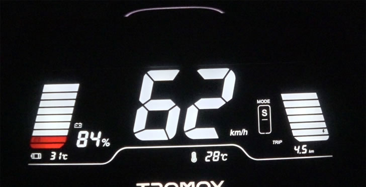

I have met two cases that "Tromox Mino B" can ride faster, but there is no such case with "Tromox Mino".
Maybe they have different firmwares? Maybe you need once again disconnect VCU?
Middle-Speed Percent and Low-Speed Percent calculated from final High-Speed, so they can't be higher 100%.
High-Speed = 46km/h * 110% = 50.6km/h,
Middle-Speed = 50.6km/h * 60% = 30.4km/h.

It looks like "Tromox Mino B" can be without VCU. In that case it has different dashboard: MS01DQ-08100000-0300 (Export, No VCU version). "Tromox Mino" dashboard part number MS01DQ-08010000-0100 (Export version). I suspect "Tromox Mino B" dashboard is the master device for RS485 bus, in place of VCU.
Rear tire 90/80-12, so maximum possible speed for "Tromox Mino B" 58km/h*449mm/410mm=63.5km/h.
