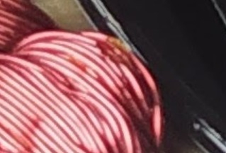

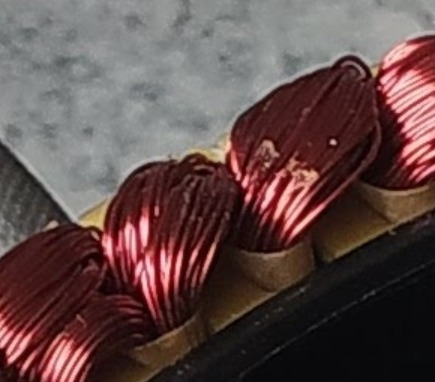

I now mention the 3rd anomaly I have seen in my motor.
I notice now, on the photograph close up at the bottom of page 3 of this thread, these details;
WhatsApp Image 2025-01-27 at 21.32.03.jpeg (54.72 KiB) 1036 mal betrachtet
WhatsApp Image 2025-01-27 at 21.32.31.jpeg (102.77 KiB) 1036 mal betrachtet
I looked again because I also have these features, and I wonder if they are a short, and where the enamel has melted? These photographs are from my motor;
Are these shorts, or another problem? Or, normal?
