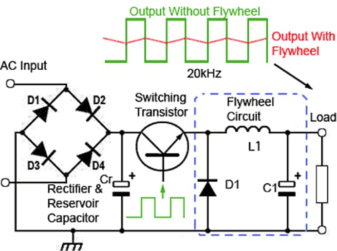

Ok, we could settle this? I am for shure not a pro, but what whould you think if someone is presenting a diagram of an unisolated DC-Buckconverter atttached directly to the mains via a simple bridge rectifier in an open electromobility forum???
You are (and of course me too) confusing the other users. This is no electronic engeneering forum.
Reverse picture search took me to the source: https://www.learnabout-electronics.org/PSU/psu31.php
This is the beginning, the missing part, the whole story: https://www.learnabout-electronics.org/PSU/psu30.php
The important difference is the isolation from mains! There is a Control Circuit for trouble-free and safe operation.
So please kids, don`t try this at home!
