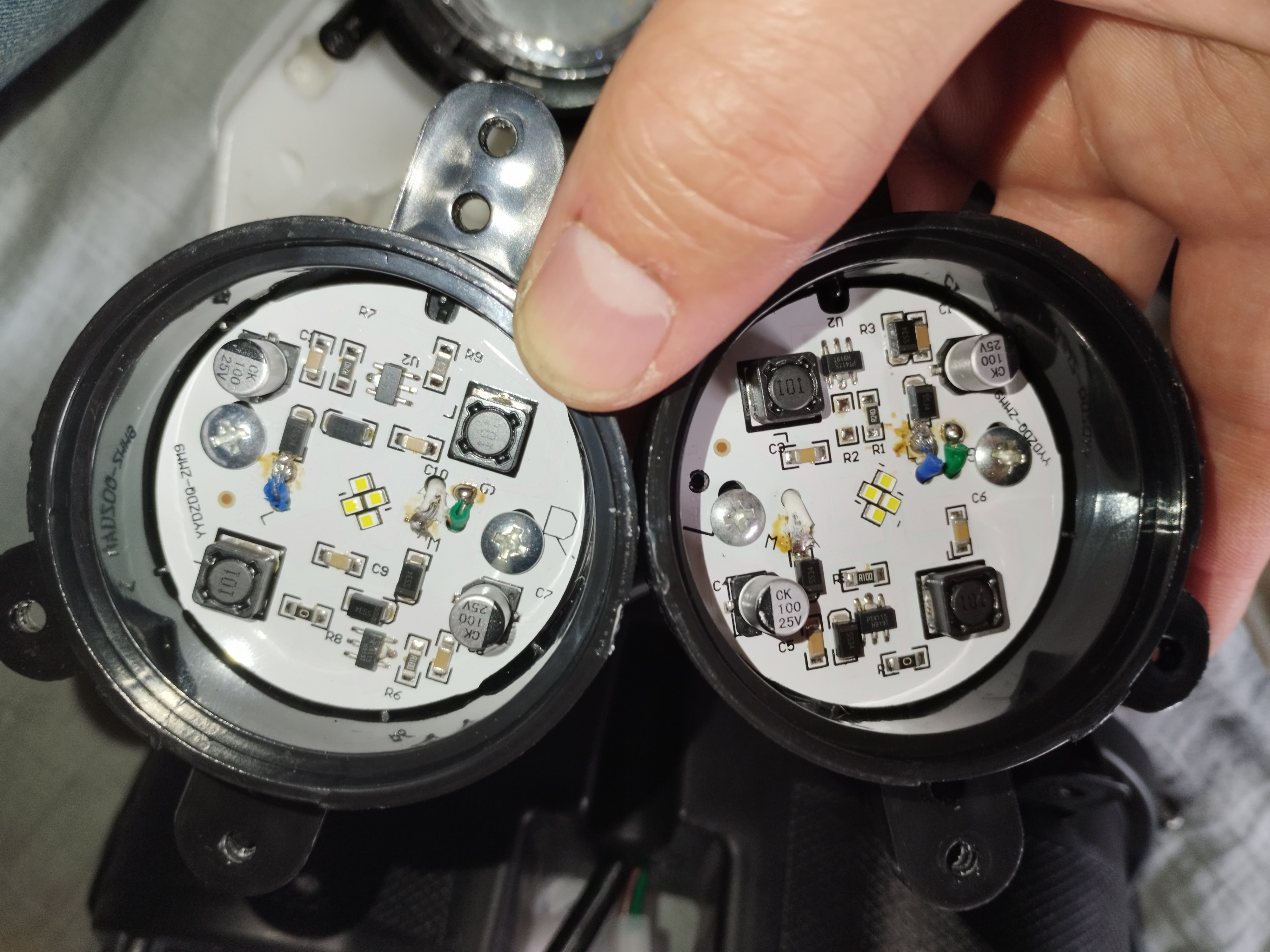

Rings are powered separately, each ring is connected to one 2pin brown connector.
Both lights are powered from one (white) connector where blue wire (12 V) is for high beams and white wire (also 12 V) is for low beams. When high beams is turned on, there is no power on white wire and when high beams is NOT turned on there is no power on blue wire.
So far I am 100% sure :) During winter I upgraded my headlights with bi-led projectors so I do not remember everything, especially original wiring, I noted only new wiring...
Each "light" is a PCB board with 4 diodes. High beams means all 4 diodes on while low beams means only 1 or 2 diodes on. My guess is 2 circuits, one with 1-2 diodes and second with all diodes.
Three wires goes from PCB - black (ground), white and third one I forgot the color, I guess one for low and one for high beam, and all three wires end in small 3pin black connector as you can see on photo. These 3pin black connectors are plugged into opposite connectors that both ends with 4pin connector (only 3 pins are used if I remember correctly) that is plugged into 4pin white "light" connector from controller (where also only 3 pins are used if I remember correctly).
In your case when both lights works on high beams but only one on low beams I guess the problem is losen (low beam) wire in that 3pin black connector (or burned diodes but at first I would check the wire).
Take off side plastics with turn signals, unscrew screw near the key hole + both top side screws. Then ONLY LOSEN bottom side screws, that will allow you to tilt the "cockpit" without falling down. Then you will see the mess of wires. Follow wires from the lights and you should be able to find the problem.

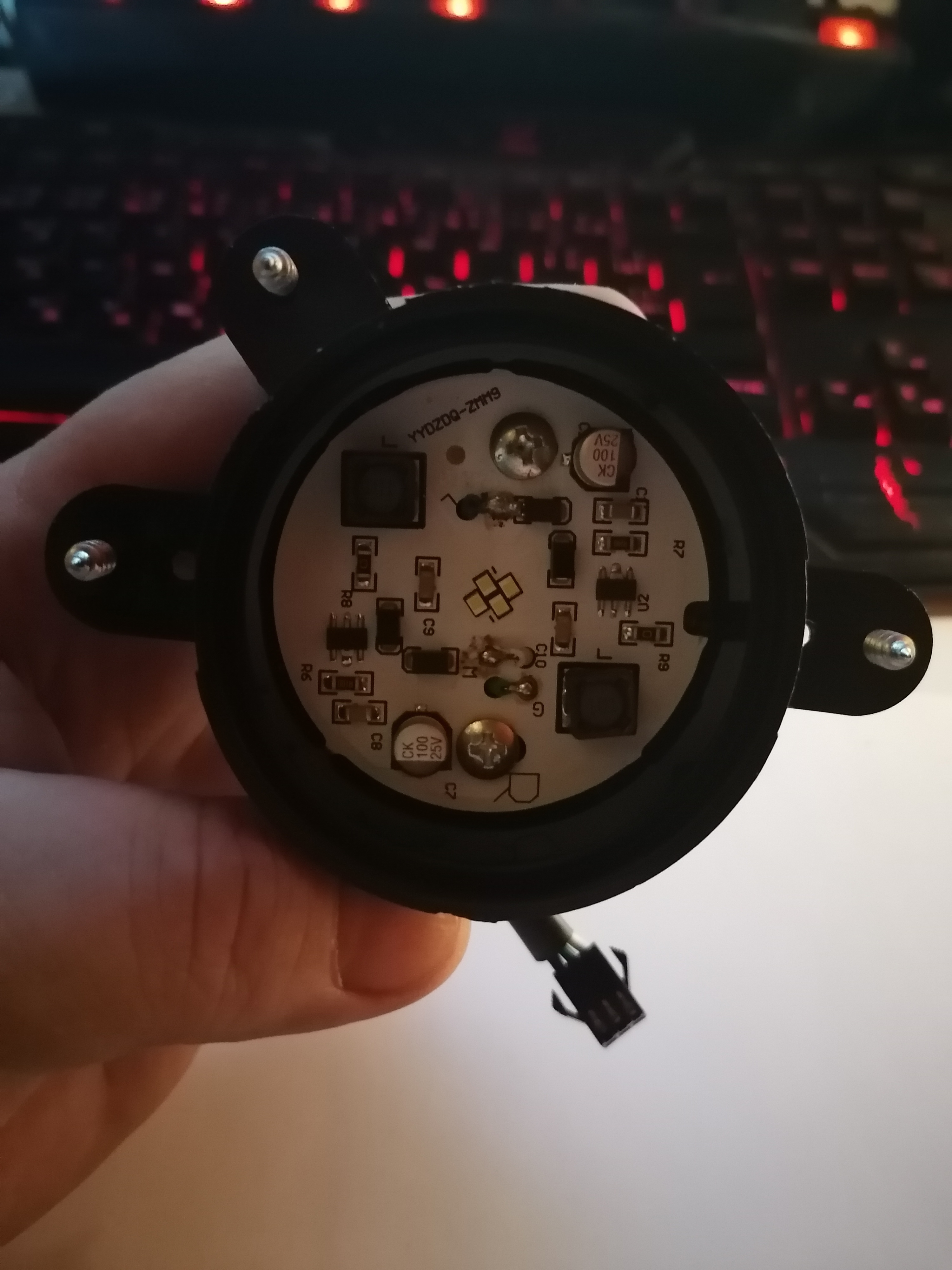

Danke an Miguello80 für das Bild mit der Scheinwerferplatine.
Dank des diskreten Aufbaus schaut es so aus, als ob man sie im Bedarfsfall tatsächlich reparieren könnte :) .
@Zimmermännchen: dass die LEDs selbst kaputt gehen ist eher selten. Meist sind es die Kondensatoren in dem kleinen integrierten Schaltregler der Leuchtmittel.
Bei der Platine für unsere E-Odin sind wohl auch gleich 2 Schaltregler verbaut.
Daher gehe ich mal davon aus, dass einer der beiden Schaltregler einen Hau weg hat.
Du könntest mal ausprobieren die weiße und die grüne Leitung an der Platine über Kreuz zu tauschen und schauen ob bei Dir dann nur die eine LED leuchtet, die jetzt nicht tut. Dann wäre das Problem lediglich in der Verkabelung zu suchen...

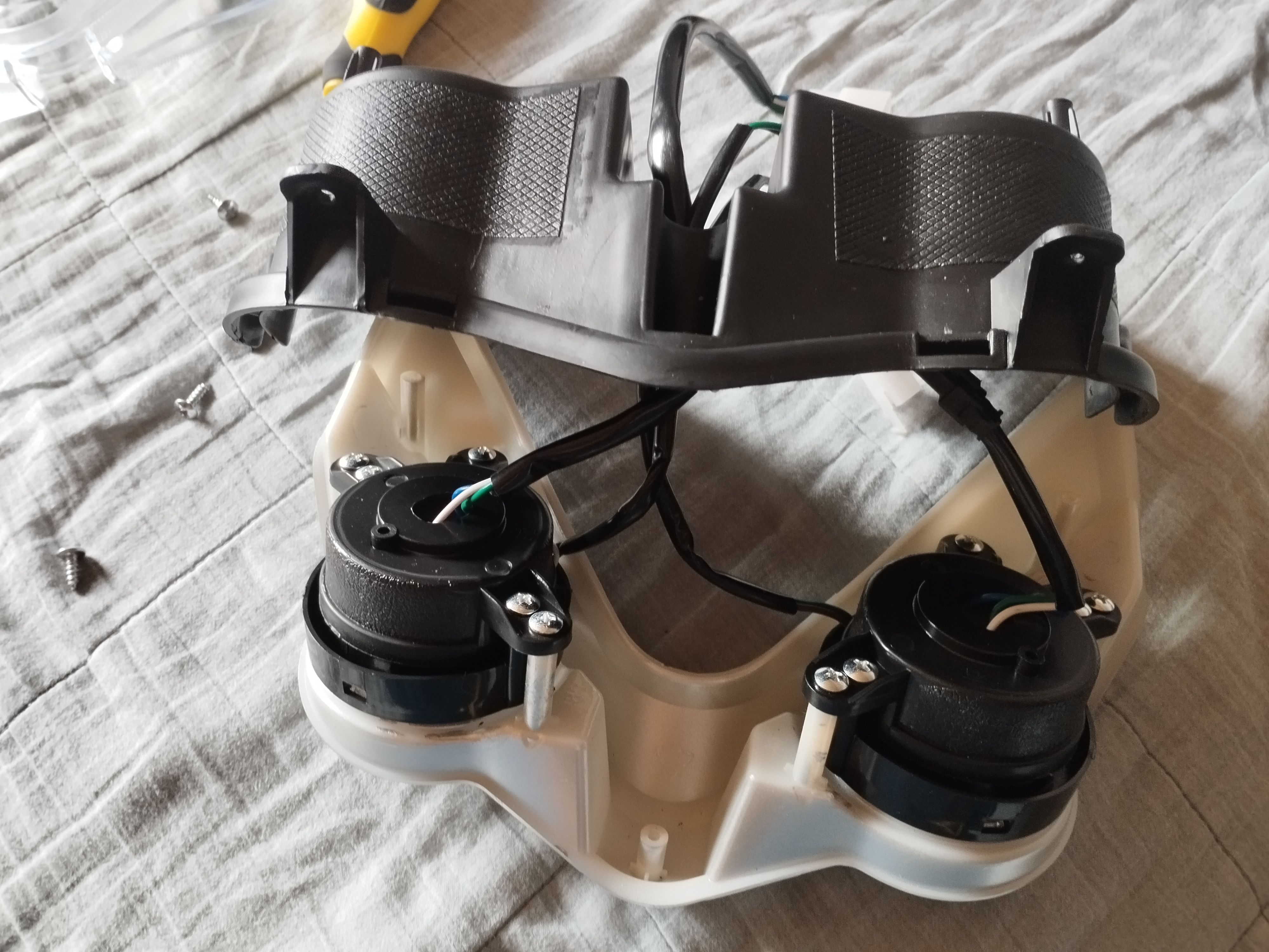

Ich habe die Scheinwerfer gerade einmal ausgebaut, kommt man ja wie immer überall nicht wirklich gut dran.

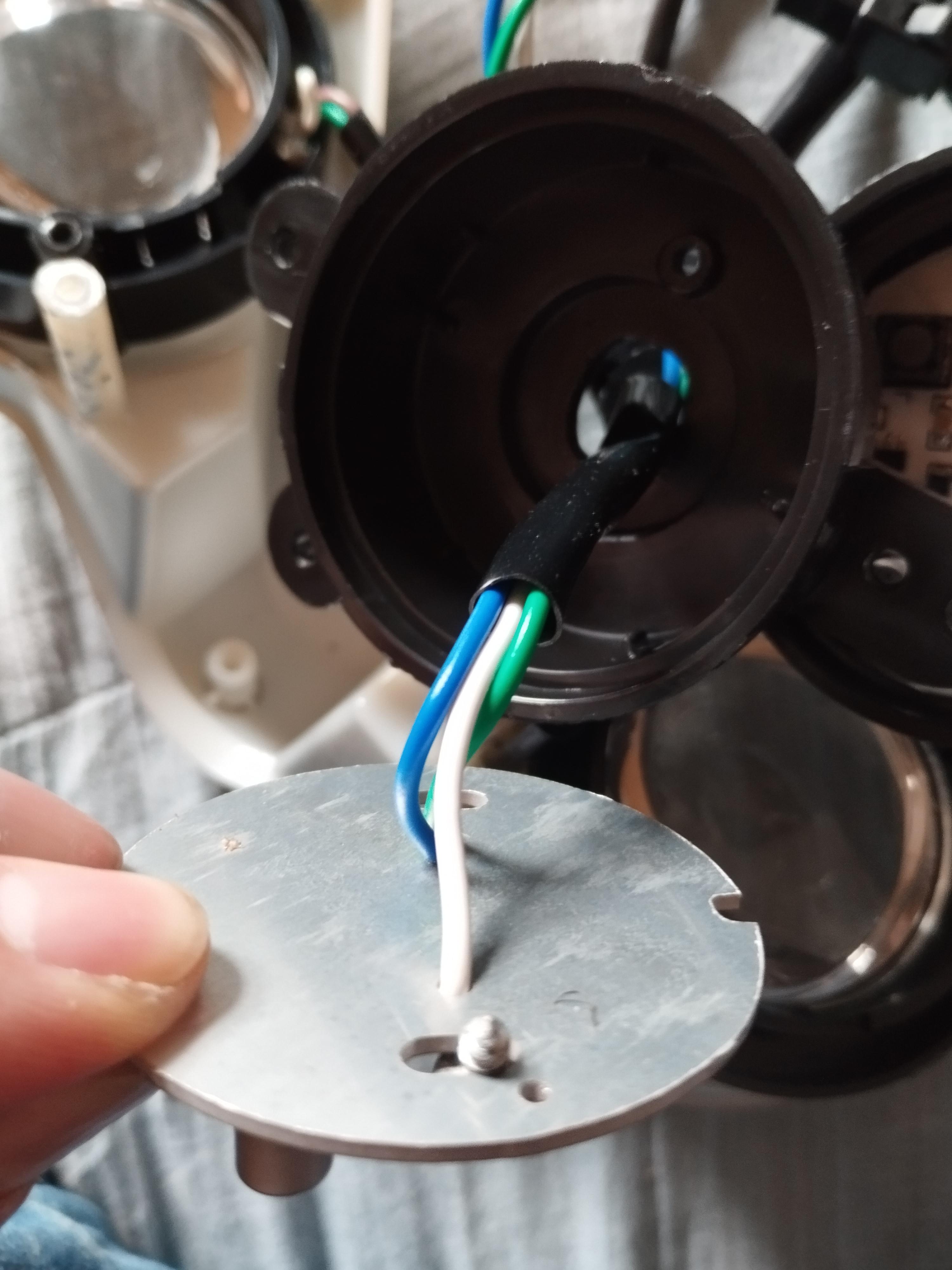

LED-Technik ist jetzt nicht so mein Thema,

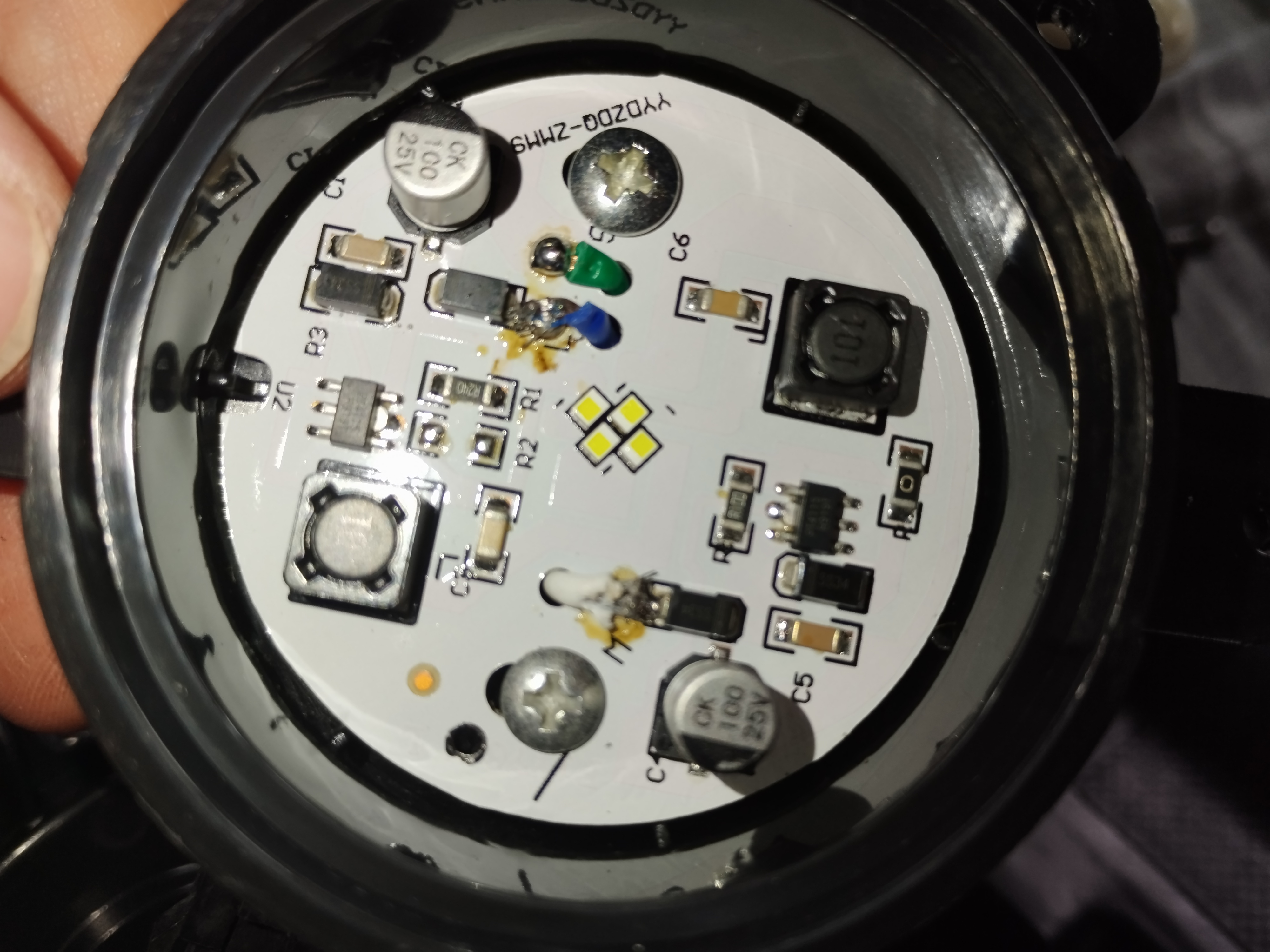

Ich habe beide Seiten aber mal zerlegt.
Wie es aussieht sind beide Seiten unterschiedlich, auch unterschiedliche Platinen und die Kabelfarben führen dann an unterschiedliche Stellen der beiden Platinen.
Sind aber Beschriftungen an den Platinen:
G = ich gehe mal von Ground aus = Grün
L= vielleicht Low? = Blau
M= ???= weiß
Ich denke also:
Grün= Ground/ Masse
Blau= 12V Abblendlicht
Weiß= 12V Fernlicht
Ich teste jetzt mal erstob von den jeweiligen Lötpunkten zum Stecker Verbindung besteht, wenn dem so ist wird die entsprechende Led bzw ein anderes zugehöriges Bauteil defekt sein.

Durchgang aller Leitungen bis zum Stecker ist vorhanden, also überlegen was ich jetzt tun kann.
Sieht nicht so aus als könnte man an der Platine löttechnisch viel machen.
