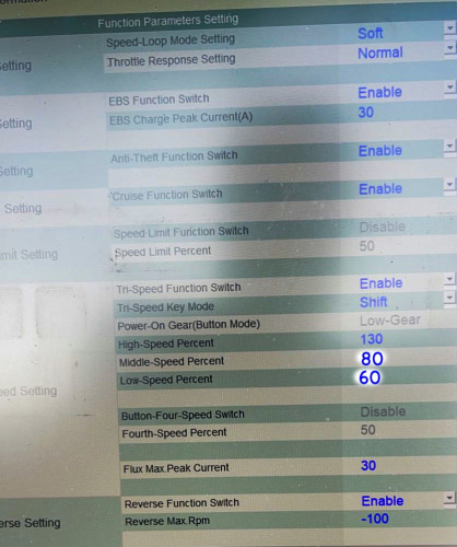

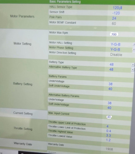

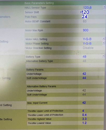

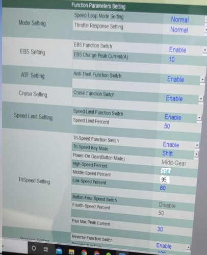

Hi everybody, i'd like to start a thread with settings for this controller on the Mqi + Lite (800 watt) with the Ling Bo software.
First setting :
Mode 3 65kmh on the screen (no gps test)
Second setting :
Mode 3 55/58Kmh on the screen (no gps test)
What do you think about it ?
i'm not an expert, i have this values from 2 different seller, and i don't know if i'm doing something wrong (i don't want to burn the motor!!)
