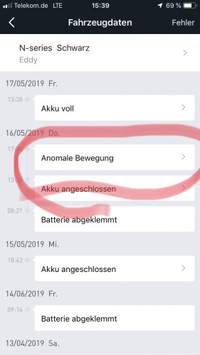

toofii hat geschrieben: Fr 14. Jun 2019, 10:05 Hallo zusammen,
in letzter Zeit bekomme ich keine Benachrichtigung der Alarmanlage mehr.
Nachrichten über Akkuzustand, Abklemmen oder dergleichen kommen allerdings.
Ich nutze die IOS App... Funktioniert das bei euch zuverlässig?

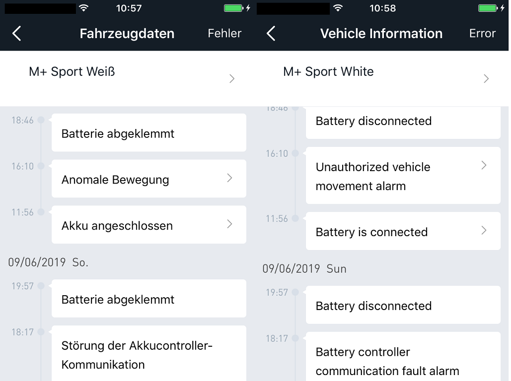

I have an M+Sport, to my knowledge we have the same ECU (PCBA version 2) and possibly the same OTA version (tra01c19) and I have occasionally received an unauthorized motion alert (only with main battery connected) in the Niu App. I have never seen an anti-theft notification in the Niu App, not even after the alarm has gone off or with the alarm off and the ignition in the "OFF" & "Lock" positions, the scooter shaken a lot, laid down on her side, a few hundred meters away from the parking spot.
I'm very curious as to what type of anti-theft notifications you usually received.

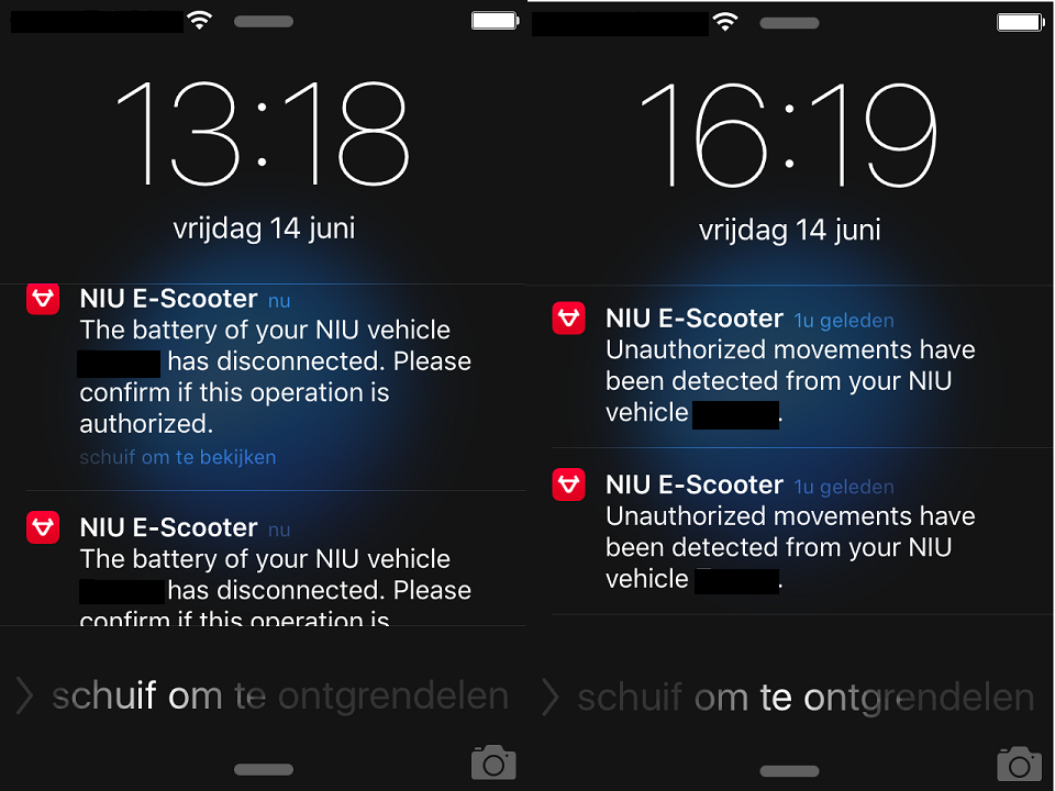

You're right, most likely there's something going on on on the Cloud server.
I noticed last weekend that the notifications were shown delayed in the Niu App.
Normally I got a (push) notification within a minute when the battery was disconnected, and this weekend the (push) notification came with a delay of at least 15 minutes and even almost an hour later.
I haven't used the scooter for a couple of days, will check later in the day if this (still) occurs.

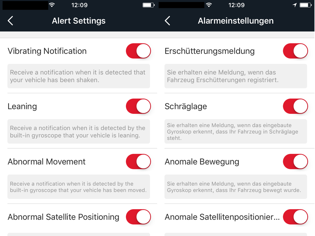

Where do i find the "Alert settings"? I can not see them in my App ( 3.7.2 Android)
Wo finde ich die "Alarmeinstellungen"? Ich sehe die nicht in der App ( 3.7.2 Android)

Hier mal ein Screenshot der „Alerts“

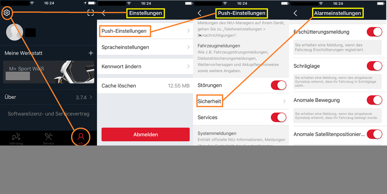

Gunni hat geschrieben: Fr 14. Jun 2019, 15:31 Where do i find the "Alert settings"? I can not see them in my App ( 3.7.2 Android)
See the step-by-step plan below, screenshots are taken from an IOS device, but are almost identical to the Niu App Android version.
Sehen Sie sich den Schritt-für-Schritt-Anleitung unten an, Screenshots wurden von einem IOS-Gerät gemacht, sind aber fast identisch mit der Niu App Android-Version.

toofii hat geschrieben: Fr 14. Jun 2019, 15:42 Hier mal ein Screenshot der „Alerts“
Can you normally reproduce the security message, for example if the ignition key is set to "OFF" or "Lock" and then the scooter is moved or shaken heavily?
Or is that abnormal movement shown alert without any explanation?
Have you ever received any of the other security notifications listed in the alarm settings?
Können Sie die Sicherheitsmeldung normalerweise reproduzieren, z.B. wenn der Zündschlüssel auf "AUS" oder "Sperren" eingestellt ist und dann der Roller bewegt oder stark geschüttelt wird?
Oder wird diese abnormale Bewegung ohne Erklärung als Alarm angezeigt?
Haben Sie jemals eine der anderen Sicherheitsmeldungen erhalten, die in den Alarmeinstellungen aufgeführt sind?

My suspicion is that Niu is trying to get the anti-theft/alarm notifications for the ECU's (pcba version 2) working like the Ngt & Npro which do get a notification in the Niu App when for example the scooter has fallen over; when the scooter vibrates; when the scooter is moved when the scooter is parked (ignition key lock in the "Off" or "Lock" position).
Today I received 2x the unauthorized movement alert in the Niu App, these were the moments when I made 2x crossings with the ferry (about 500 meters each crossing).
It is to be noted that since today the push notifications come twice, while in the Niu App only one notification is shown.
Mein Vermutung ist, dass Niu versucht, die Anti-Diebstahl-/Alarmmeldungen für die ECU's (PC-Version 2) wie die Ngt & Npro funktionieren zu lassen, die in der Niu App eine Benachrichtigung erhalten, wenn z.B. der Roller umgefallen ist, wenn der Roller vibriert, wenn der Roller bewegt wird, wenn der Roller geparkt wird (Zündschloss in der Position "Aus" oder "Schloss").
Heute habe ich 2x den unbefugten Bewegungsmelder in der Niu App erhalten, das waren die Momente, in denen ich 2x Überfahrten mit der Fähre machte (ca. 500 Meter pro Überfahrt).
Merkwürdig ist, dass seit heute die Push-Benachrichtigungen 2x kommen, während in der Niu App nur noch 1 Benachrichtigung angezeigt wird.

Cooper hat geschrieben: Fr 14. Jun 2019, 16:45 See the step-by-step plan below, screenshots are taken from an IOS device, but are almost identical to the Niu App Android version.
Thank you, it seems like the settings are different for the N1S (2018). I only can change "Anomale Sattelitenpositionierung".
On the bottom i now saw a little info icon. But the table that is shown there is only in chinese, so i cannot read it :D

Gunni hat geschrieben: Sa 15. Jun 2019, 17:01
The options are indeed shown in the App on the basis of model and model year.
The matrix shows the following;
Due to the different hardware configurations of each model, the corresponding security push function will be different.
Below is a list of security push types that are supported by each model.
1st row - Satellite positioning
2nd row - Shock
3rd row - Gyroscopic change
4th row - Fallen vehicle
According to the matrix, you should be able to receive notifications of the Satellite positioning and Shock (= abnormal movement).
Die Optionen werden in der App tatsächlich auf Basis von Modell und Modelljahr dargestellt.
Die Matrix zeigt folgendes;
Aufgrund der unterschiedlichen Hardwarekonfigurationen der einzelnen Modelle ist die entsprechende Sicherheitsdruckfunktion unterschiedlich.
Nachfolgend finden Sie eine Liste der Security-Push-Typen, die von jedem Modell unterstützt werden.
1. Reihe - Satellitenpositionierung
2. Reihe - Schock
3. Reihe - Gyroskopische Veränderung
4. Reihe - Gefallenes Fahrzeug
Gemäß der Matrix sollten Sie in der Lage sein, Benachrichtigungen über die Satellitenpositionierung und den Schock (= abnormale Bewegung) zu empfangen.
