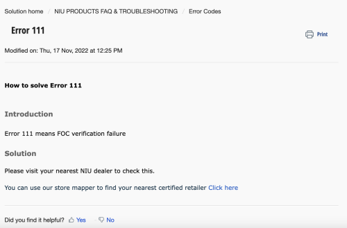

hi could someone help me with error 111 i also have a H1 handheld tool available

i tried to install the foc55.bin. then that happen after

asher123 hat geschrieben:
Mi 25. Okt 2023, 17:54
So you fucked yourself

SURE DID is anyway i can fix this or is the end
Mi 25. Okt 2023, 20:19
Normally it's the end flashing a software which isn't right for the hardware.

Go to a dealer, confess your mistake and hope they can obtain the right firmware for your FOC. If they can't you're SOL and are going to need a replacement FOC.
