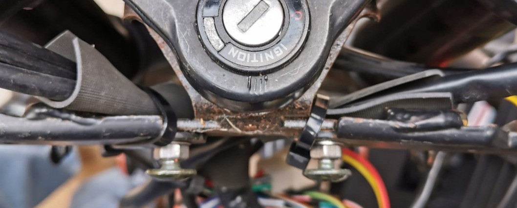

The screws at the top of the backing plate behind the light stick out and might foul on the electrical cables, so I changed that.
I didn't have short enough screws, just used locking nuts for now.
I added protective rubber and cable tied them firmly.

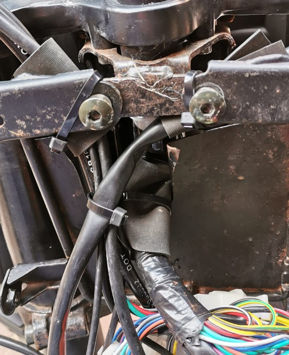

I added protection (where it has been discussed previously) and tied down the other cables too, I also bend around the sharp corners of the bracket, there are very sharp edges there. They should not be a problem, but there is no need for such sharp edges.

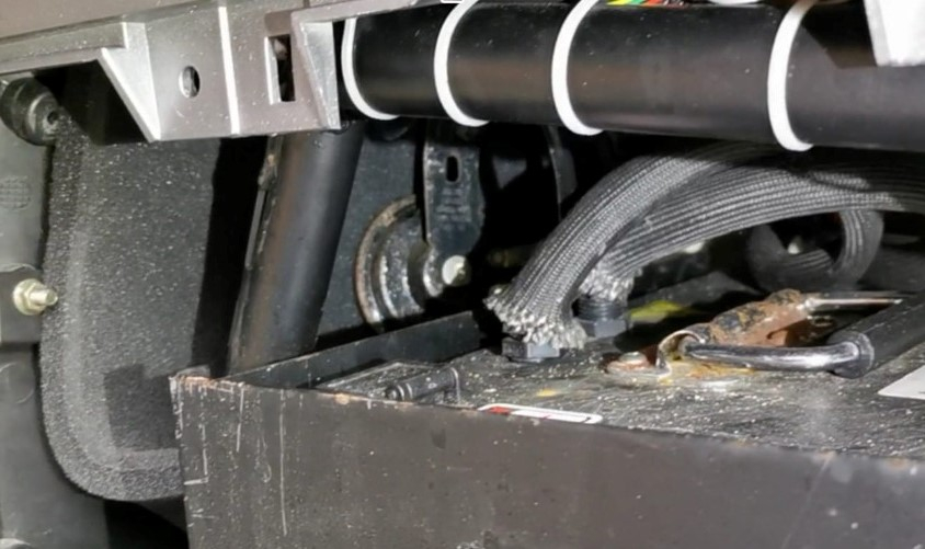

There appeared to be corrosion (minor water ingress?) to the inverter screws and battery case, so I added foam at the front of the casing where there are ventilation holes.
This foam is open cell foam for use as air filter. I had a roll for another motorcycle, it is not cheap foam. However, whether this allows enough air flow, I am not sure.
Perhaps this compartment would be better sealed completely, with a fan circulating air?
Really, motorcycles should use stainless steel fixings. Is there no moisture and rain in China?

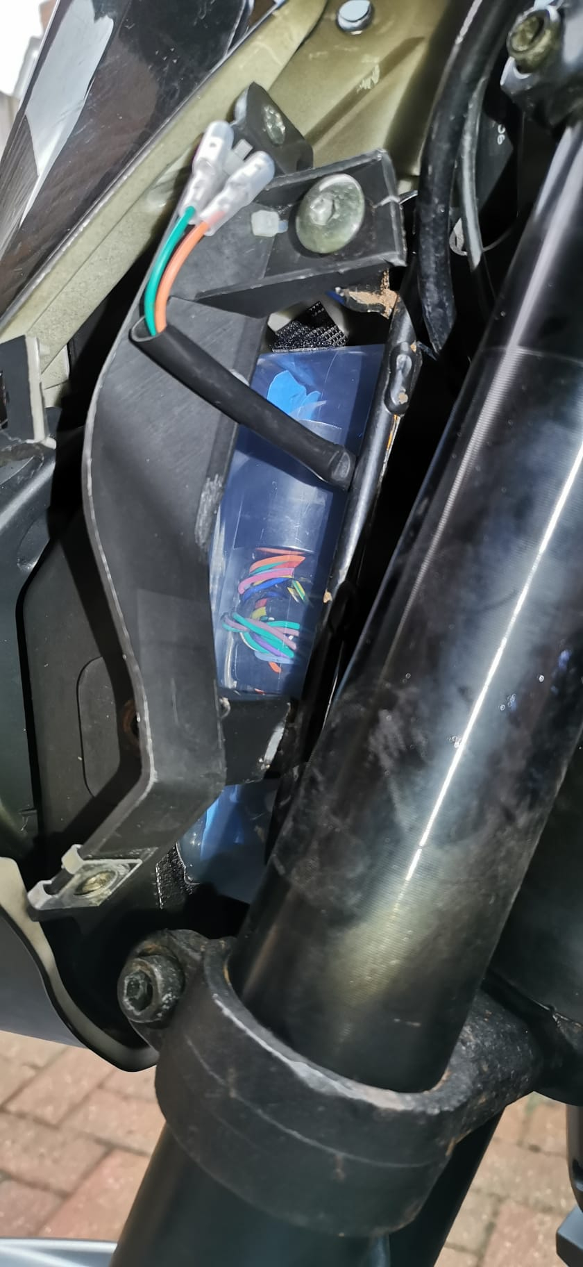

I installed a better quality indicator flasher, which is fully potted and does not die so easily.
