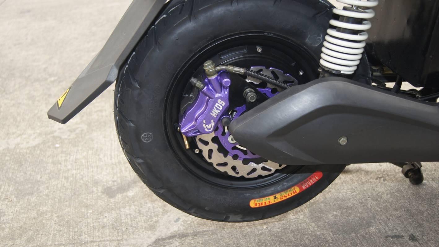

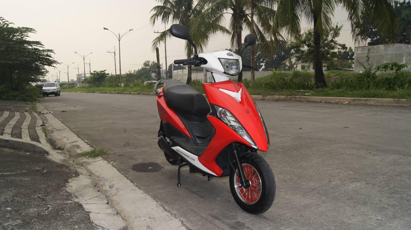

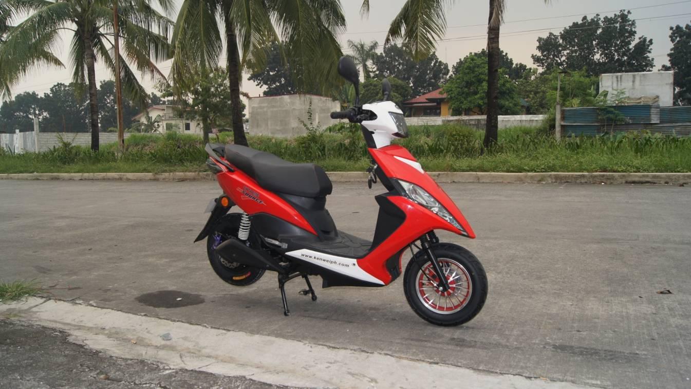

http://www.kenweiph.com/product_.asp?F_ ... ffset=#Y_1
Mein Roller ist: Kenwei Extreme 1800 Watt
