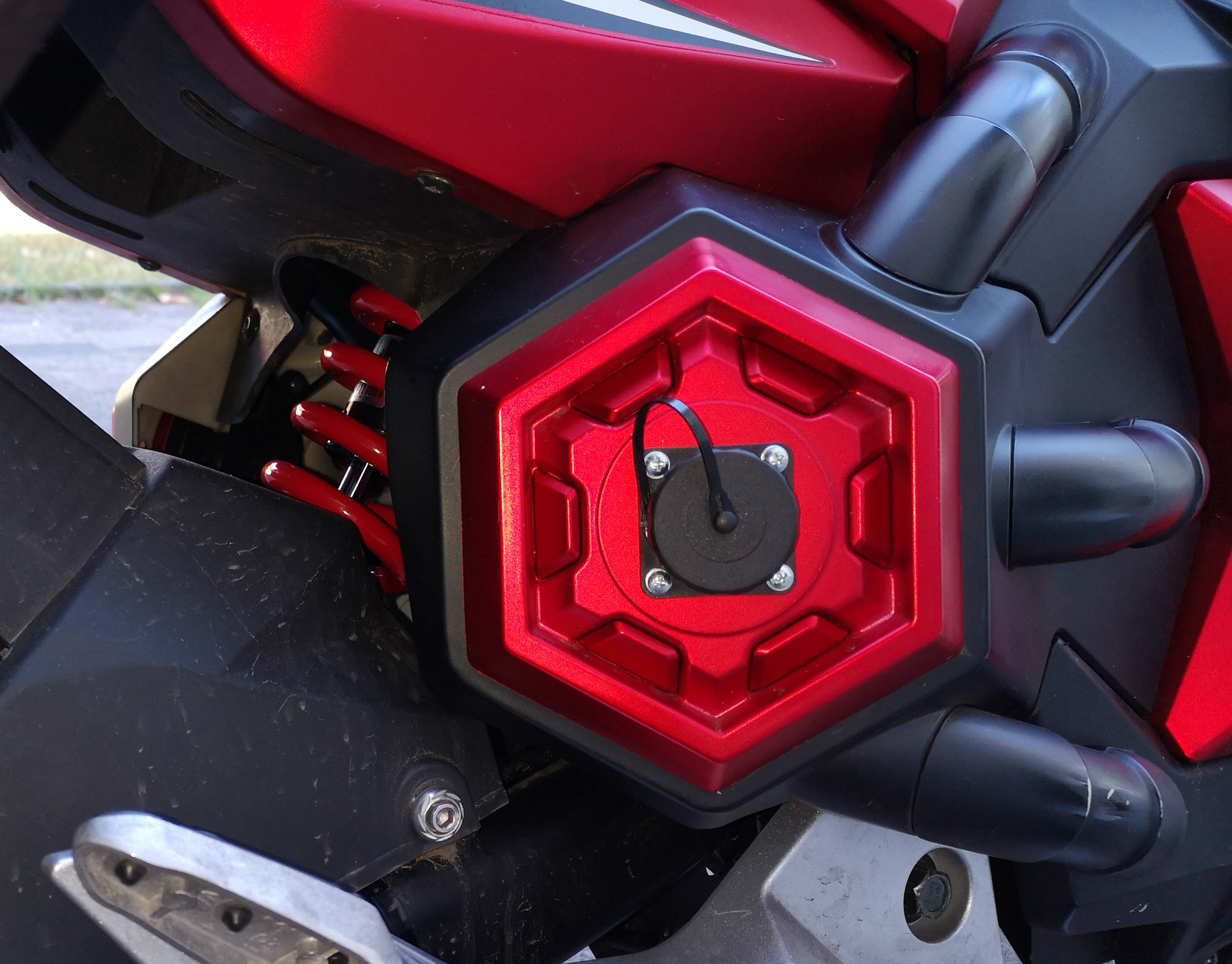

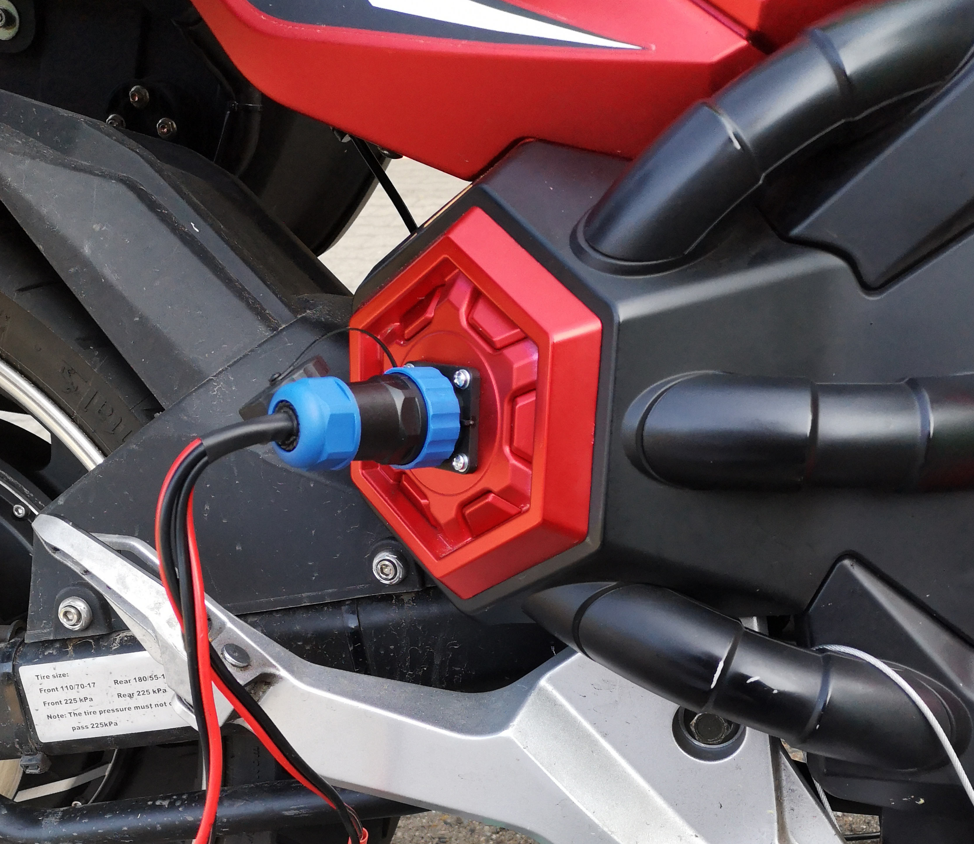

With these powercon connectors you can go up to 20A current. Which might be enough for many use cases.
_____________
But I've choosen these SP28 waterproof aviation connectors (3-pin version), because I'm using up to 40A charging current.
You can get them from amazon too.
