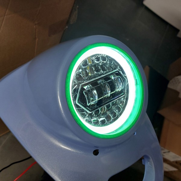

Started my project to 3D-print a mount for an inexpensive 5.75" LED light. The green is not final, I just printed this with cheap PLA filament to check fitment and see how the angle works. Currently it's pointed about 6 degrees from the mounting surface of the front cover. I'll have to mount it on the Unu to check how close that is to the stock headlight alignment.
The LED light is this one from Amazon.de. ~€40.
First test fit:
This is with the "Halo" daytime-running-light on. That can also be orange for when the turn signals are on and there is low/high beam. This is only DOT-approved so not legal for German roads (technically).
Once completed, I'll share all files and info.

Close to the final version. It needed to be mounted out front as the light is partially blocked if I mounted it inside the bodywork. I ordered a set of automotive plugs so I can make my own wire-harness plugs to match the Unu wiring plugs and that will make the installation cleaner and I can incorporate the 1st gen Unu light switch on the right handlebar which my gen 2 Unu did not have.

Sehr schön, wenn selber gebaut wird.
Aber die Variante sieht doch zu sehr nach DIY aus und man sollte in keine Kontrolle kommen :-(
Vielleicht den Halter und den Unu-Lampenhalter in der gleichen Farbe lackieren?
Kann man den Scheinwerfer noch verstellen?
