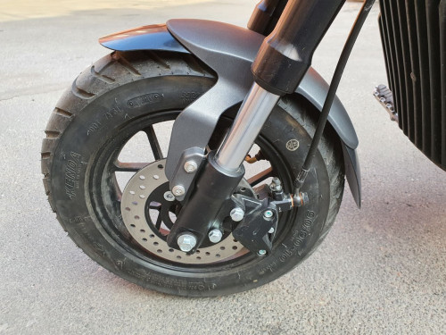

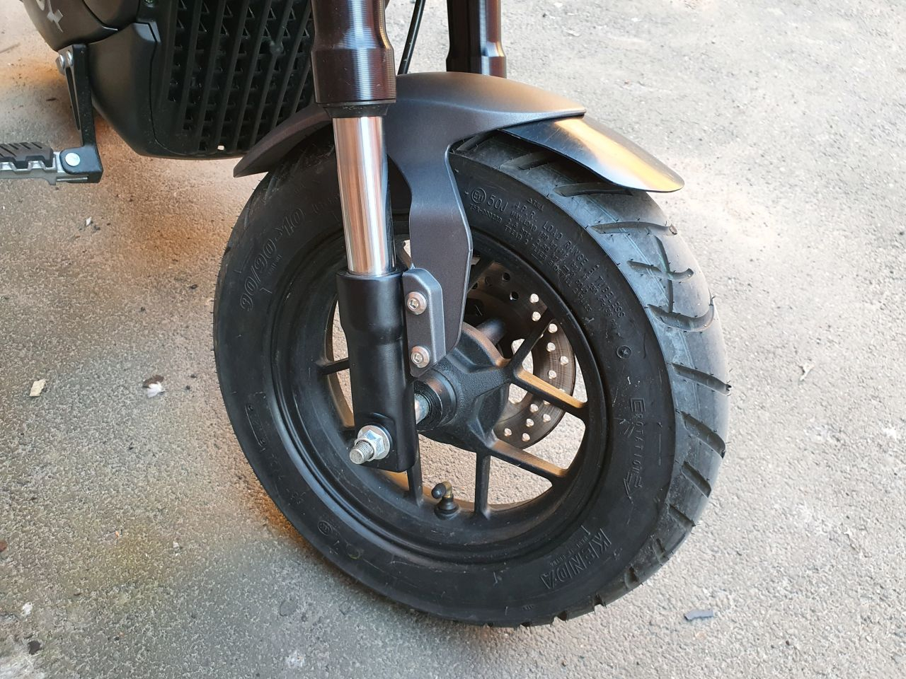

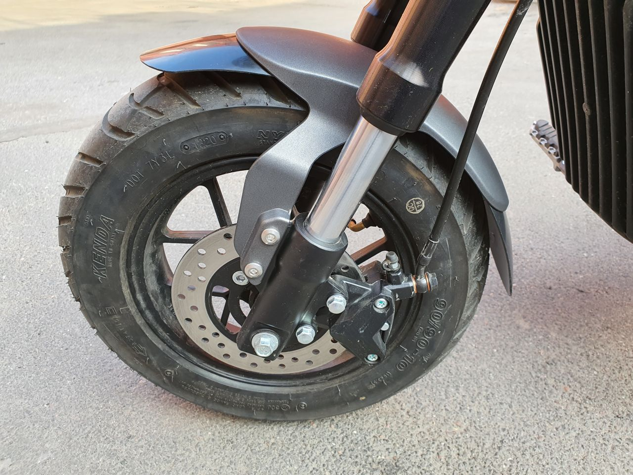

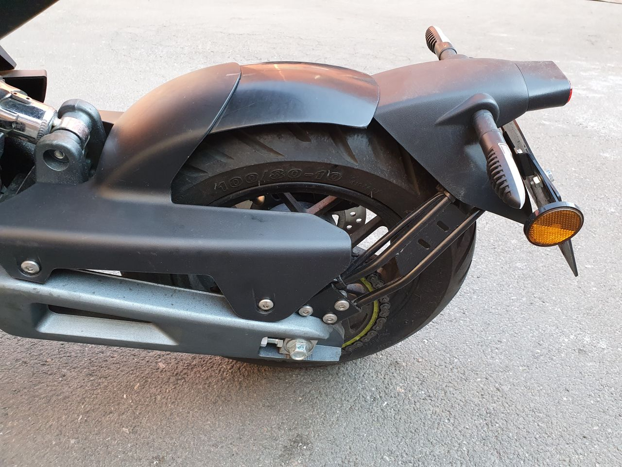

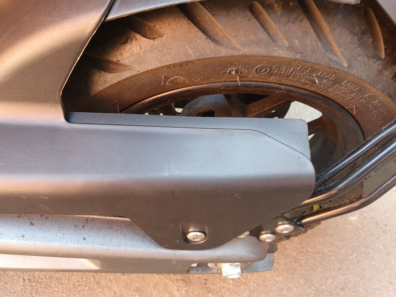

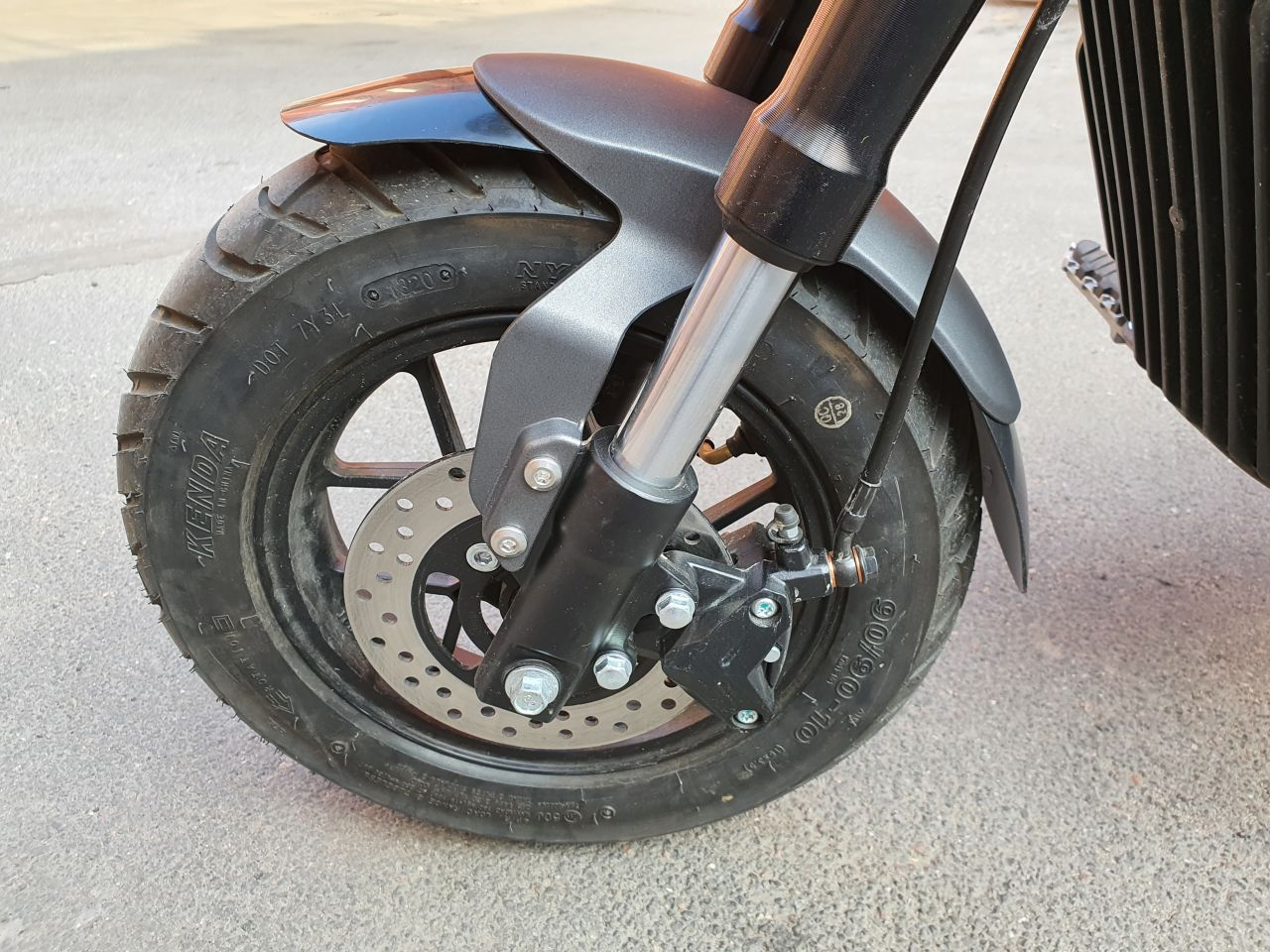

Some mods:
Front mudguard 1 Front mudguard 2 Rear mudguard Additional chain guard
