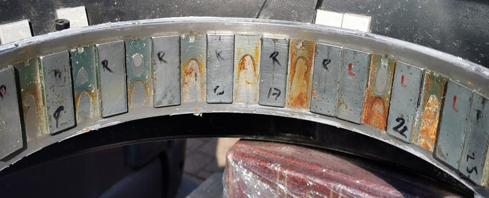

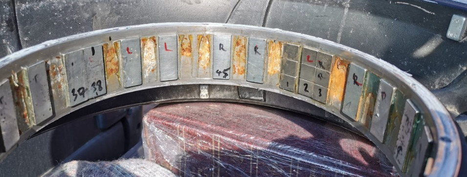

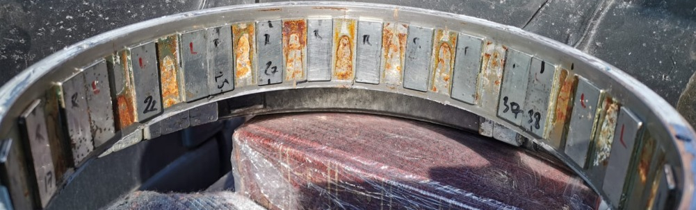

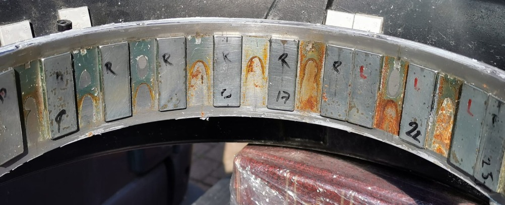

I'm just reviewing photos during and after the repairs so far.
It's painfully obvious now that the magnets either side of that repaired region needed to be reglued too. At least two to the left (as in the photos above) and at least one to the right.
There are also a couple on the far side of the rim that might be suspect.
I'll take a few off and see if I can spot which ones are sound and which ones are dodgy. I guess I might break the ones that are glued on properly and not rusted. We'll find out!
I have more photos if you would like to see what I mean.
bob2.0
Beiträge: 420
Registriert: Di 17. Sep 2024, 14:29
Roller: e-Odin 2.0
PLZ: 116
Land: anderes Land
Re: Dismantling and repairing the motor :o
Beitrag von bob2.0 »
Pictures speak words;-
(updated)

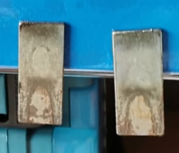

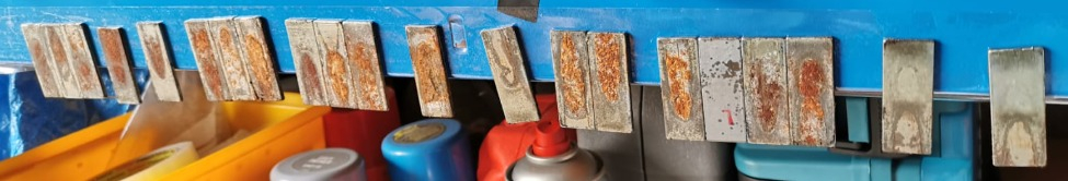

All the magnets I took off were rusty.
The two on the right were the least rusted, it was not obvious but if you look at the lower picture in the last post they are from the left two slots. There is still orange rust showing on the rim.
I figured after the earlier photos of a few magnets removed (I updated them), I decided they all had to come off.
I wish I had bought the bigger bottle of glue!
I have started sanding down the slots to glue them back in.
I will put new magnets into 8 of the slots, I will match what I have done already but on the other side of the motor, for balance purposes.
Perhaps I might do more. I have enough magnets for 16 slots in total. But I worry if so many new magnets might cause the motor a problem when running?

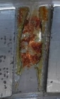

I can now give you a full 'root cause analysis' as I see it.
The issue is that not enough glue was used. Yes, I believe this is all it was. They were saving money on glue.
I will show you that there was only just enough glue to stick the edges, leaving a gap in the middle where the rim curves.
See this example;-
WhatsApp Image 2025-04-03 at 18.33.27.jpeg (59 KiB) 1082 mal betrachtet
This magnet was clean and shiny before removal on the 'outside'. There was no sign of any corrosion until it was removed.
So, what happens is that as the motor cools in a cold environment, condensation may form between the backside of the magnet and the rim (because the rim is the coldest interior surface in the motor so all the condensation collects there first).
This causes corrosion and the magnets lose 'cohesion', that is the strength between the glue and the magnet itself, because the plating that the glue is attached to just gives up.
I have tested the magnets in the slots and whether 'glued in' or just not glued, the force is barely different, it is as if once they are rusted then there is not really any glue left. They are just sitting in the motor.
Therefore, those two that were clunking in my motor simply moved!
The least rusted magnets are the ones that had the most glue. It is very simple. The glue stops water condensing and protects the magnet as an extra coating.

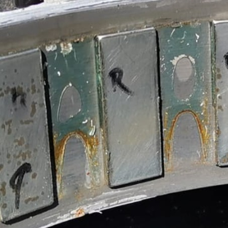

These two slots were the best magnets, showing no obvious corrosion.
WhatsApp Image 2025-04-03 at 18.57.19.jpeg (130.64 KiB) 1077 mal betrachtet
I actually dug into the metal to get them out, you can see a dent in the aluminium they were in strongly and did not 'fall out' like the others.
The reason is obvious. More glue! But it was still not spread evenly, and that gap over time would eventually lead to condensation and corrosion.
