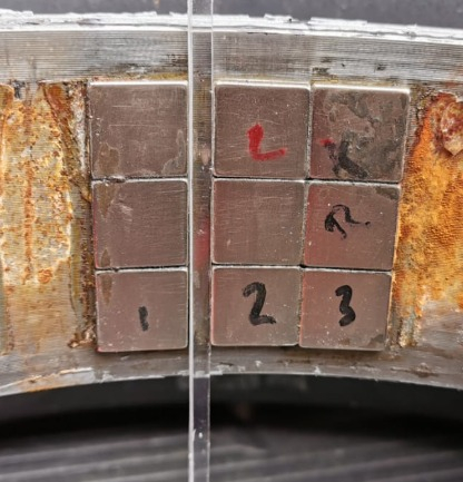

jeff-jordan hat geschrieben: Do 3. Apr 2025, 20:57 So, over all a good research job, that'll help one or the other of us in the future!
I will continue and finish the job. I will see if there is more to figure out and go over any pointers and tips that might help.
FWIW I tried measuring the height of the magnets, and there was nothing to measure. I was hoping it was a way to tell which ones need to be changed, but, no, you cannot tell from this. You have to actually remove them to see. They can be clean and shiny, but rusty underneath.
They do not need to be standing high. Just that adhesion/cohesion became so weak that the magnets must have been moving as the motor rotated.
They touched because the magnetic forces were stronger than the rust and they rippled as the motor rotated.
The glue I am using, AA326, is a polyurethane methacrylate (slightly flexible so does not fracture with stress and heat) which cures by anerobic process, single component, and a secondary cure using an activator which comes as a 30% acetone solution. So I basically used the curing accelerant as a cleaner, spraying it on then rubbing the surfaces down with a coarse sponge and spraying a further coat. They seem glued on very robust. I suspect if I wanted to take these off then they will have to be chipped off and broken. Many times stronger than the rust!
I have also experimented with cutting out polycarbonate filler to go between the magnets (as they are smaller). I don't think it is needed now but I have already had this problem twice so why risk it? I can make this filler, I have the materials, and this glue is also good to bond polycarbonate to aluminum, so the instructions say.

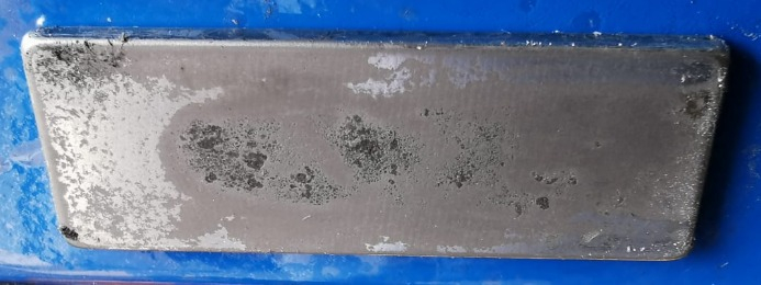

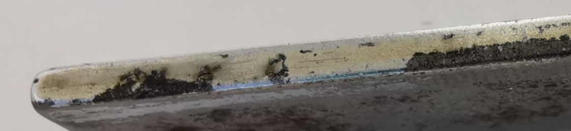

I decided to wet-sand a test magnet with 800 grit and light acid (citric acid) to remove the rust chemically, and see what came of it. Too much sanding would remove protective plating.
We see here clearly this is a zinc second (inner) layer.
Most (quality) magnets are two layers of nickel (a single layer can be too porous), with a copper interlayer to improve the binding of the nickel layers.
This is simply zinc on the magnet, then nickel, which is the cheapest option.
The zinc does bond well to the sintered magnet, but once it is exhausted, the iron has then rusted underneath (now black after reduction to ferrous citrate).
In time it should oxidise to ferric citrate which is more soluble in water, maybe it'll wash off if I leave it a day or two.
Then I can make sure the glue has covered the bear NdFeB pitted areas, and it should be sealed up.
I thought the edges (some of the magnet edges show this grey patina) might be exposed NdFeB but I can now see it is the zinc underlayer. So, it would be good to think about some sort of coating option for the edges where it is exposed.

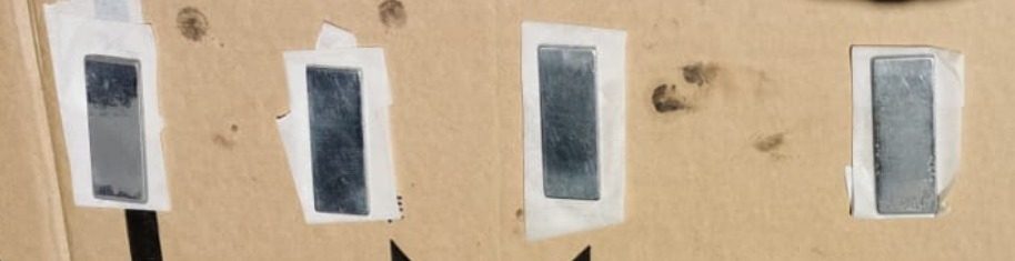

I put 3 coats of lacquer, and cannot really tell if it is covered! Because it is clear and everything is shiny, I wonder if using coloured primer might be better? Then I can ensure a coating.
Of course, the primer might contain metallic particles in its colour, but it would still be less metal than the magnet plating. So, should I just use grey primer instead?
You can just see here on the edge that there is a feature of the lacquer.
There is none on the lower (corroded) face, to paint them I stuck them to cardboard with masking tape. I could therefore coat the edges but the underside is free of coating. This will receive a full coating of glue.
To paint, or to lacquer?
