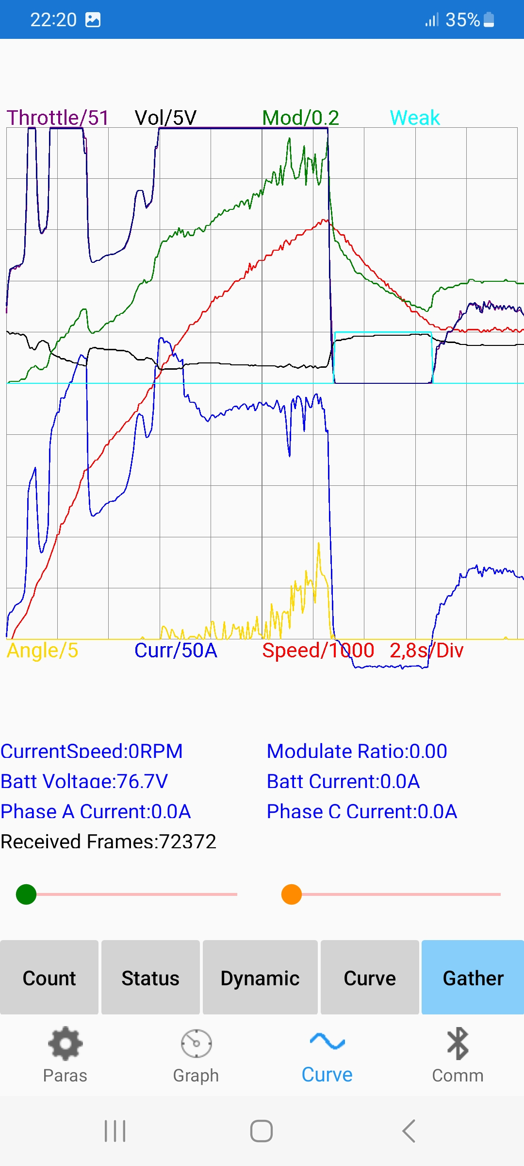

I have measured the set 630Phase amps from my controller. If I set more phase amps acceleration gets slower because the controller overshoots above his save Operation area and reduces the current way to much and then it starts to raise the phase amps again , and repeats this over and over again. You can Herr and feel this Regulation. You can see the reduction of the line current during the start from a standstill as a die in the dank blue line, this line should raise until the set max line value and then it should rest there until the motor reaches top speed.
This could be better with the right ki and kp settings.

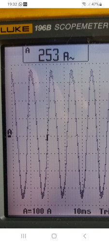

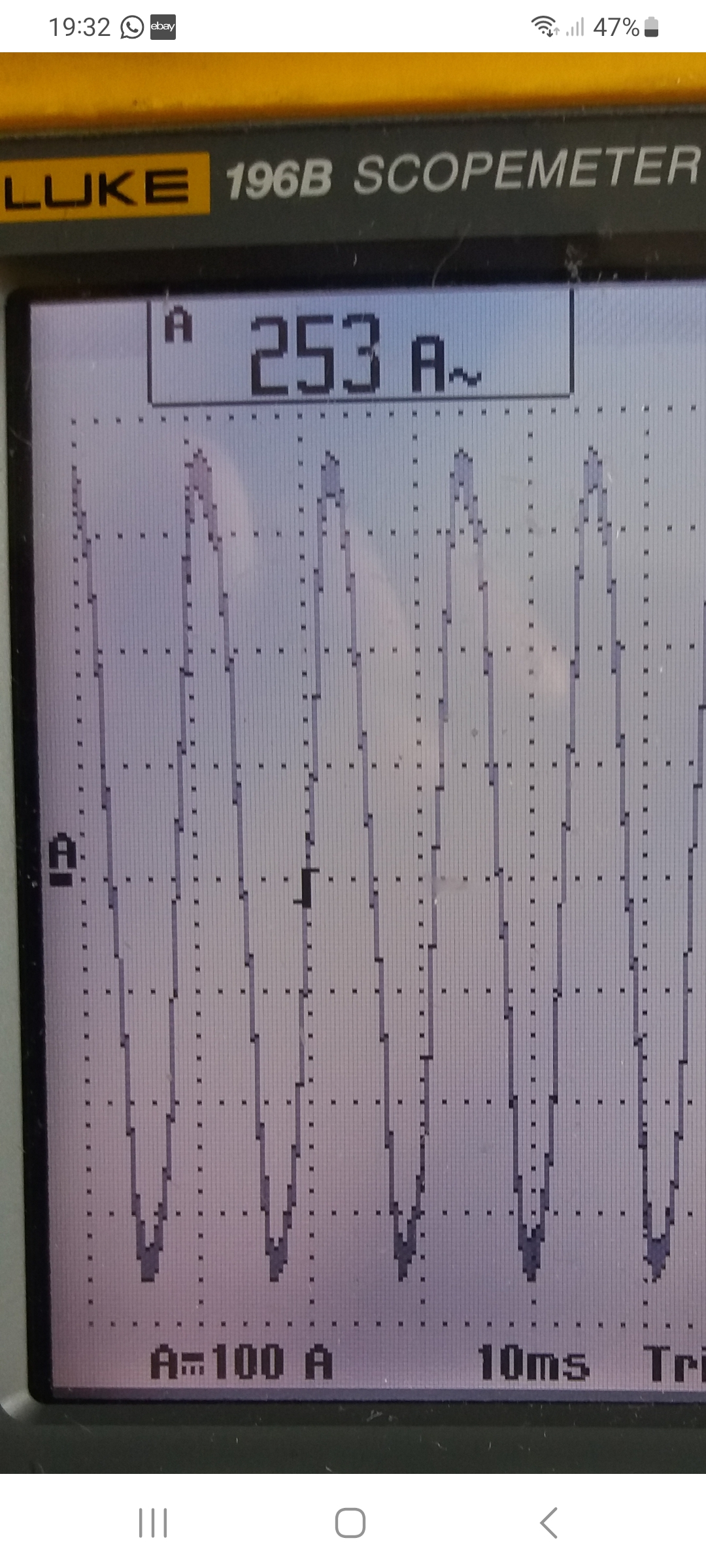

The current waveform looks like AC
I have measured my SVMC72150 with a rogowski current transducer and an oscilloscope
dominik
Beiträge: 3209
PLZ: 79
Tätigkeit: Elektromeister
Re: E-ODIN - Diskussionsthread
Beitrag von dominik »
This measured 250A are the same as the advertised 350Apeak from Sabvoton.
The most Controller manufacturers advertise the peak phase current. [Sevcon not)
The peak is the highest point of the sinewave. It is calculated Ipeak= Ixsqrt(2)
250Ax1,41=353Apeak
Motor power is calculated
P=U x I x sqrt(3)
U is Ubattery/sqrt(2)
80V/1,41=56V
So max RMS Voltage the controller can make is 56V without losses.
When the controller makes 80A phase current at full speed you get 56Vx80Ax1,73=7700W
Battery current is then somewhere around 100 to 110A.
