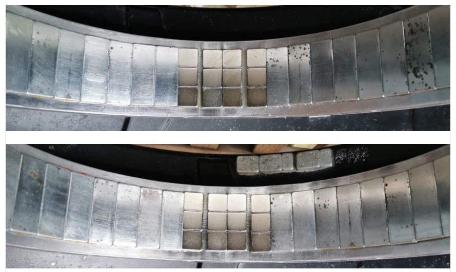

20 magnets more refreshed and glued in, plus 5 slots of 3pack replacements.
At one point, a batch drifted off the centre line by a few mm because I was so focused on jeff's question about polarity and started doubting myself! :oops:
I tried tapping them to see if they'd slide in and were already set enough that I was not going to try too much. With the activator I think they are quite well cured within several minutes.
Total is now 34 slots glued in, 14 to go I have used ~6ml of glue, so a simple calc suggests that is a layer of glue 0.25mm.
In theory, I have enough left in my 10ml bottle. I will try to get it done with what I have.
I have tried to put on just enough that there is a very small amount of excess that just blobs at the edges. Sometimes it hasn't done that (worried if I have used enough), sometimes there is excess I need to wipe up, but for most of the time I seemed to have done OK with the Goldilocks amount of just a small bead of excess around the edges.
Unlike the original manufacture, that's around 'all' the edges, not just one side.
I have developed a method which seems to work well. I don't know how they fit these in the factory. Perhaps they glue them in and then magnetise them?

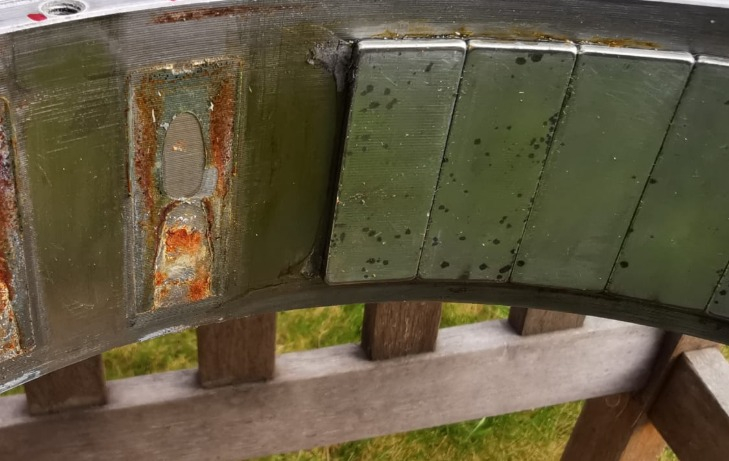

Well, I can say there is no problems with the strength of the glue, except that these magnets are only going to come off as broken bits of rusty dust in the future.
I'll explain my strategy, might be useful to consider if you are in this pickle (though my advice now is to buy another motor!)
See in this image the left most messy slot was a 'key' magnet I left in place, and I removed all the others in the next 7 slots.
I then put a 'spacer' magnet between it and the first one that I glued. I did this to give me more space to sand off that rusty glue so I would not be sanding right up to the edge of a good magnet.

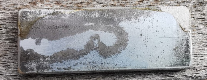

This morning, I removed that rusty slot in the usual way (just tapped it off gently) and in theory the next magnet would just be free to come off.
But, look closely, and there is a little bit of overspill under the corner.
That tiny bit of overspill was enough to hold the magnet firmer and harder than even the best glued magnets I have removed.
The result is that it ripped off a chunk of magnet, clean off!
The ironic part of this is that this magnet was the ONLY magnet I took off that was not rusty at all. So sad! :shock:
Well, it is not the only 'I didn't do that, well' issue. It's been a difficult and haphazard job. Rust does not work in a systematic way, every magnet was different in some way and needed slightly different treatment and preparation.

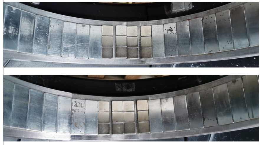

FWIW and a record of my efforts, the motor now looks like this.
You can see how my plan worked out for locating the smaller magnet sets.
I would have liked to get the alignment better, in hindsight I should have made a simple L-shaped tool to set the distance to the edge of the flange, but I don't think it will have a performance effect :? . I am more concerned if so many of the smaller magnets are up to the job.
I spent an hour cutting strips of polycarbonate to fit in the gaps (I don't think it is necessary with the strength of the glue, but who can say in the very distant future), but only managed 3 of the 8 I needed, as the gaps are all slightly irregular sizes. Tomorrow I will try heating the polycarbonate until it can deform plastically in to the gap. But one way or another, I will finish the job there.
It took 9ml of my 10ml bottle. I think I used just the right amount, not too much nor too little and I resisted using less as the bottle emptied. There is only just enough now to wet the sides as I turn it upside down! If I wait a long while I can get enough drops out to fix the polycarbonate fillers.
In principle, if the smaller magnets do not work properly, I could try to find/order some exact size ones and chisel those off. But I think simply trying to buy a new motor might be the better answer if that happens. Custom magnets are expensive. For reference, I measured them as 45mm x 16.75mm x 2.5mm.
I suspect the smaller magnets will give me slightly less performance at slow speed but perhaps higher speeds (less back EMF beyond constant V/Hz). This is me being optimistic, I just want my nice bike back on the road!

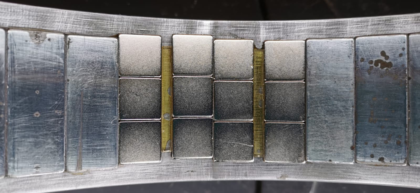

The misaligned 3pack has got me upset.
I'm sad. Those two 3packs on the left were the last two I put in. I guess I was getting tired and a moment's slip up.
The central one is 1.5mm displaced up (in the picture) but it looks worse than it is because the ones on the far left are 1.5mm down.
The left most 3pack is actually in the right place, near enough.
(Also shown are the spacers I've now glued in.)
So, I am a bit sad that I failed to get that part of the job done nicely. I did not see much of an issue at the time, but the poles of the stator are also 45mm, so any misalignment will lead to yet more field weakening of the whole set.
The Hall sensors are ~2.5mm in from the edge, so in theory the field will still be strong enough there to generate the signal. I hope so. The field reverses at the edge of the magnet. :?
This is a worry because the Hall sensors are about 3mm, and the pole faces are 45mm, the full length of the magnets. That means the very edge of the field will be cutting the Hall sensor, but the field reverses at the edge.
(There is no problem with the side plates,. Magnets normally have a 7.5mm clearance to the surface edge, and the side plates have a 3.5mm depth flange, so normally it is a 4mm gap. My misplacements have now reduced that to 2.5mm in places. :( )
So, a lesson if anyone were to be foolhardy enough to attempt this themselves, in the future; make a tool to set the magnets spot in the middle.
