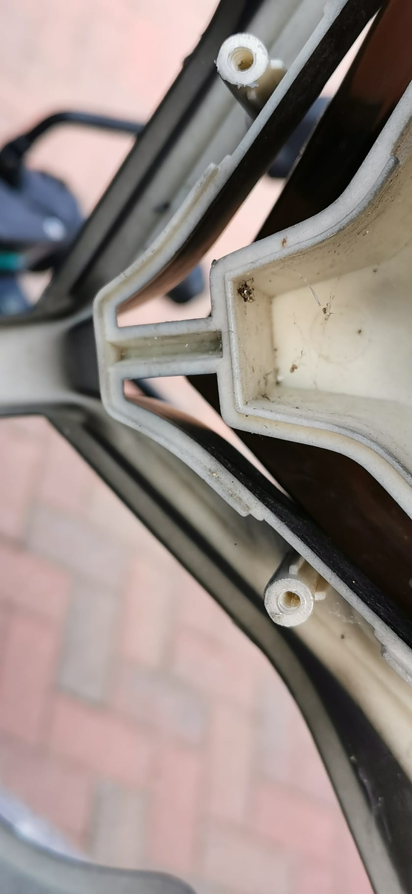

Some more mounting points snapped off. I grease them when I reinstall them and they still snap off.
If they make plastics out of chalk, not sure what else I can do about it. I must admit, the plastics do actually fit together quite well, it is not a bad effort for Chinese product, but the plastic is so brittle. I have used velcro to substitute for some of the broken clips.

bob2.0 hat geschrieben: Mo 23. Sep 2024, 17:52 I did some weatherproofing today, I put the details in the 'tinkering' thread.
Du meinst bestimmt auch diese Clips. Wenn man anfängt die Odin zu zerlegen bricht meistens mindestens einer dieser Clips. Zum Glück hat, ich glaube Jeff-Jordan, hier im Forum die Teile schon nachkonstruiert und die Datei zur Verfügung gestellt.
Ich habe mir gleich mal einen Vorrat in diversen Materialien gedruckt (PLA, PETG, und Resin/Harz) und auch schon welche an meiner Odin ersetzt. Aber eigentlich reicht PLA vollkommen aus. Besser die PLA Clips brechen beim nächsten zerlegen als andere Teile an der Verkleidung.

Thank you for the thought. Unfortunately, it is the actual panels on the bike where the clips have broken.
It would be better if the ones you have there, these pieces, were sacrificial, and were made weak, so that they broke before the Chinesium chalk-plastic.
I think there are now less of those square panel clip openings left than there are that are still there.
(2 on each side of the small panels by the seat, I have none left, they are all gone. The top two clips on the left battery panel are gone. So I think that is 4 remaining out of a possible 10 for the side panels! I have one front indicator panel clip of two still there.)
I have been super gentle. I am well experienced with removing bike plastics, this is just plastic turning brittle in the space of 3 years.
But, with the help of velcro, none of these clips seem to be 'essential'. Unlike some of my sports bikes where I have had to glue or reengineer broken parts.
(Be careful! The backing glue on genuine 3M velcro is incredibly strong. Sometimes I just use 3M velcro just to glue parts together, it is so strong. If you use too much of it, too large an area, it won't come off again without breaking what it is stuck to!)

bob2.0 hat geschrieben: Mi 25. Sep 2024, 19:13
Oh ok, ich verstehe was du meinst. Bei mir ist bisher zum Glück nur ein solches Gegenstück/Loch gebrochen. Das war im vorderen Bereich der Batterieseitenteile.
Und an einem der kleinen Seitenteile/Verkleidungsstück selbst zwischen Sitz und Tank ist mir der Grundhalterung für den Clip abgebrochen.
