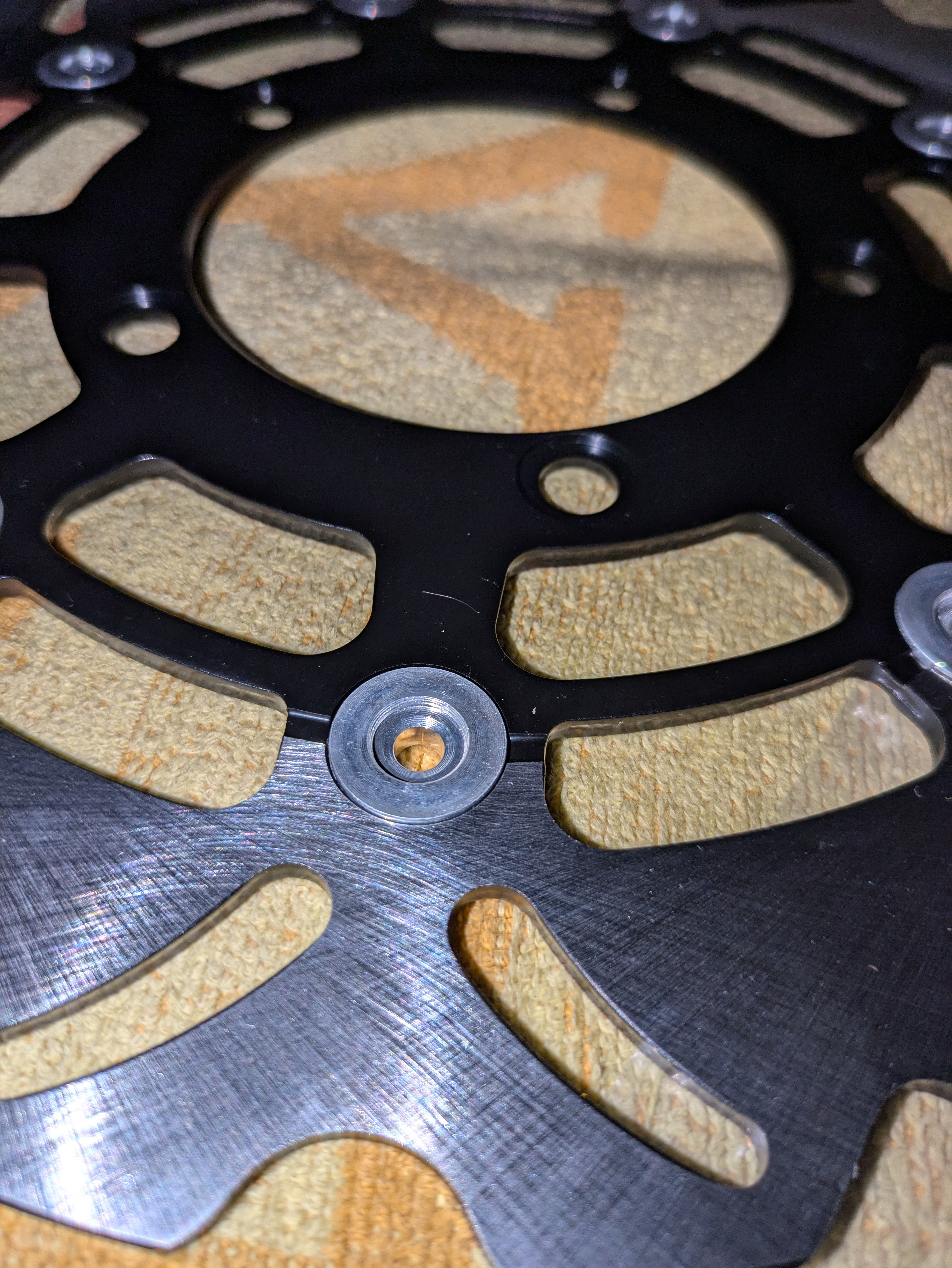

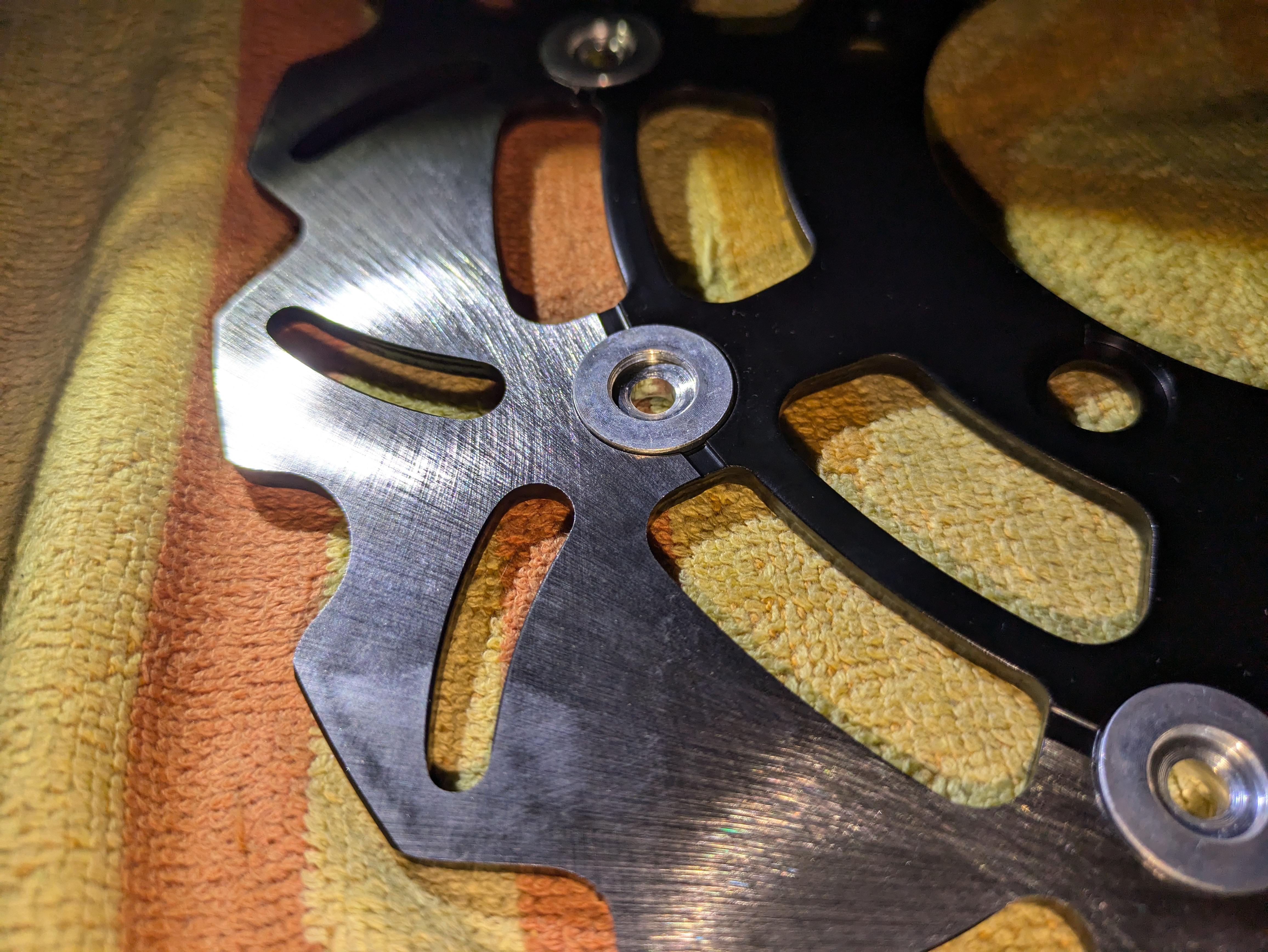

I should wrote "floating" like "sort of floating" instead of (floating). I did not have them in that moment so I did not know exactly how they are mady and how much movement is there to be real floating discs. Tomorrow I will test it more because I still believe that those bobbins / rivets allows outer part to move a little bit.jeff-jordan hat geschrieben: Do 17. Okt 2024, 13:15 Just to let you know: I ordered the discs for the Lexmoto at cmpoparts.com and they arrived here today.
But to avoid false expectations: these discs are no floating discs!
In fact they are solid single piece steel discs, in floating disc design (which is absolutely ok for me and my E-Odin 2).
But it definitelly is NOT a single piece disc, bobbins connects outer part with inner part so two part connected together. Usually each part is made from a little bit different material and even then it is not, this design is used to stop transfering heat from outer part to inner part to lower the risk of warping.
If they will not warp like original discs, I am ok with them, price is good.

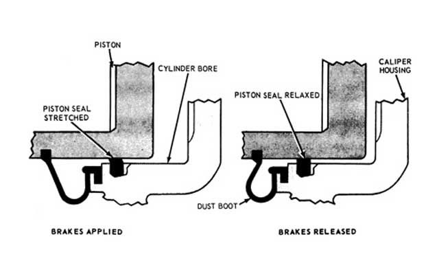

Design of calipers is very simple so easiest way to make them work is to take pistons all out and clean them + inner side of calipers.bob2.0 hat geschrieben: Fr 18. Okt 2024, 13:51 I did take the calipers off and they seemed dirty/rusty.
I usually clean pistons on new (to me) bikes, but it must be some deep corrosion that a quick clean up (push pistons out with lever) won't reach.
Main work is on rubber seals that retracts pistons back. Check them and be carefull when putting all back together, I am not sure whether it is a common diameter to be able to buy a replacement. Any youtube video should help.

That's the idea behind the floating discs.Miguello80 hat geschrieben: Fr 18. Okt 2024, 23:57 ...
But I checked the whole disc with a magnet and it sticks all over the disc (with the same force), furthermore there is no gap between the black and the shiny part of it.
In my eyes the BRDF031 is one piece of steel, with a polished shiny outer ring and a black coated inner section! I can't see another functionality of the rivets, except for decoration.
See for yourself:
