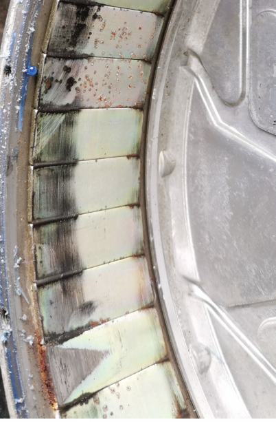

bob2.0 hat geschrieben: Mi 19. Feb 2025, 14:01 I am sad about my motor's magnets going rusty. (In another thread)
Has anyone else had motor problems, or replaced it?
I have emailed Matador about a replacement. They offer a shipped price to UK, but are not replying.
I have emailed QS that I am not happy about the magnets rusting, they just want to sell me another motor.
The problem with just getting another motor is that it will have the same design defect. I would like QS to first agree it is not acceptable.
It makes more sense to me to learn a way how to repair the design fault than just buy another one.
But, maybe it is just me. The one and only me! I always worry about strange things going wrong, and they go wrong!

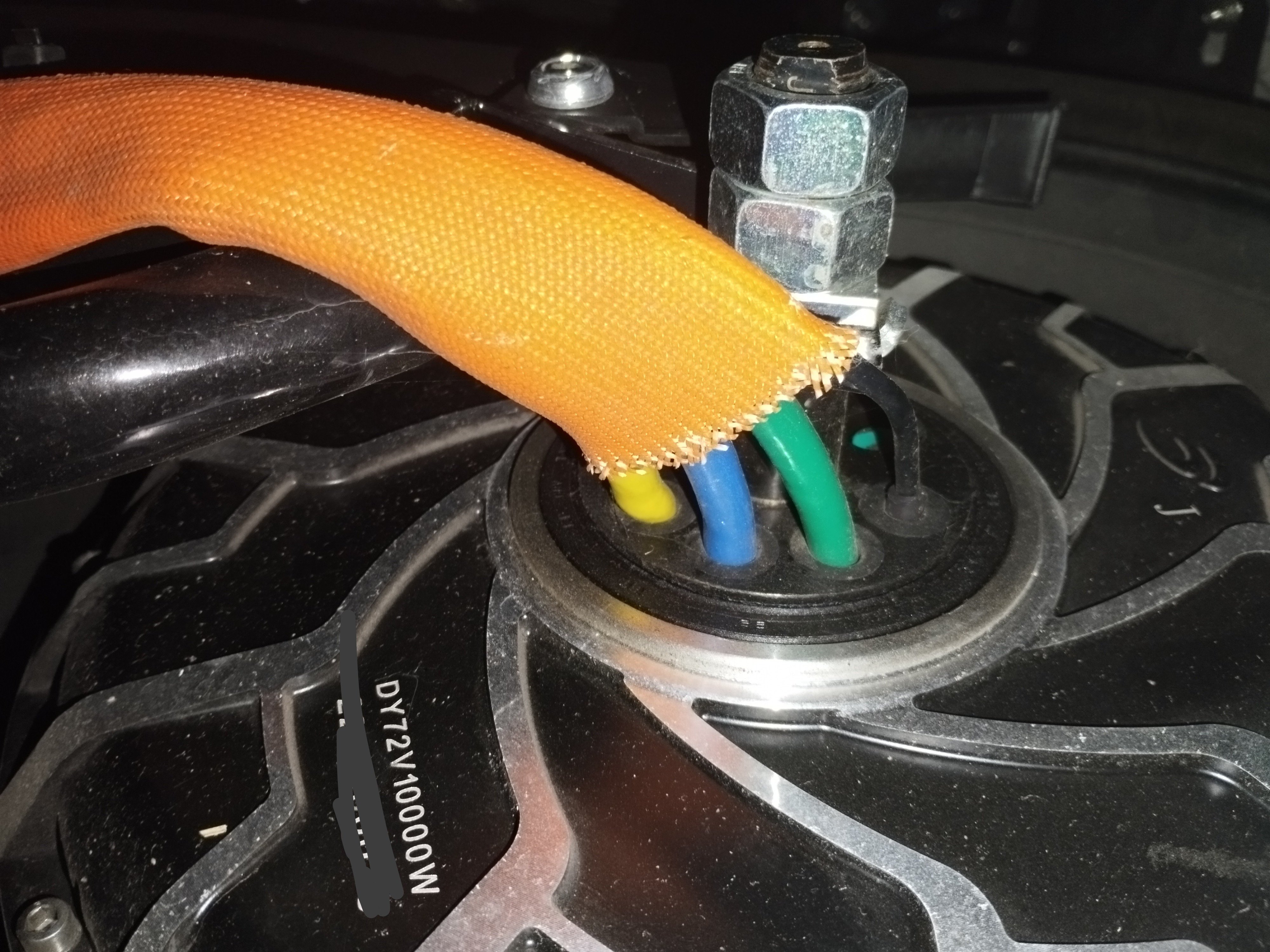

Aber vielleicht ist ein neuer Motor keine schlechte Idee, denn du hast ja noch eine alte Variante, die meisten von uns haben ja eine Variante wo die Kabel anders zugeführt werden (egal ob QS oder AMR von welcher Marke auch immer).
Korrigiert mich gerne wenn ich hier falsch liege.
Vielleicht war/ ist dies die bekannte Schwachstelle wo Feuchtigkeit eindringen und deswegen wurde die Kabeleinführung geändert?
Klar man möchte am liebsten das was man hat reparieren und verbessern, aber das ist leider oftmals mit Schwierigkeiten verbunden.

Zimmermännche hat geschrieben: Mi 19. Feb 2025, 20:50
I like the new sealing arrangement.
(However, it requires a specialist seal.)
But the issue is not water entry. There is no indication at all of any water entry.
It can only be condensate and water vapour.
It is the magnet plating which was defective. One magnet rusted in the middle of all the others.
The plating on the back of the magnet had been damaged when fitted, then humidity made it rust.
Some of the magnets are fine, others have spots of rust. The one that swelled on the back doesn't actually have any dots, but you can see it, the lower one in the picture.
I am sad because this is bad manufacturing. QS only want to sell me a new motor.

Might it be that the rim of the wheel is no longer exactly round?
Maybe somebody (previous owner) hit the wheel hard against a curbstone... :?

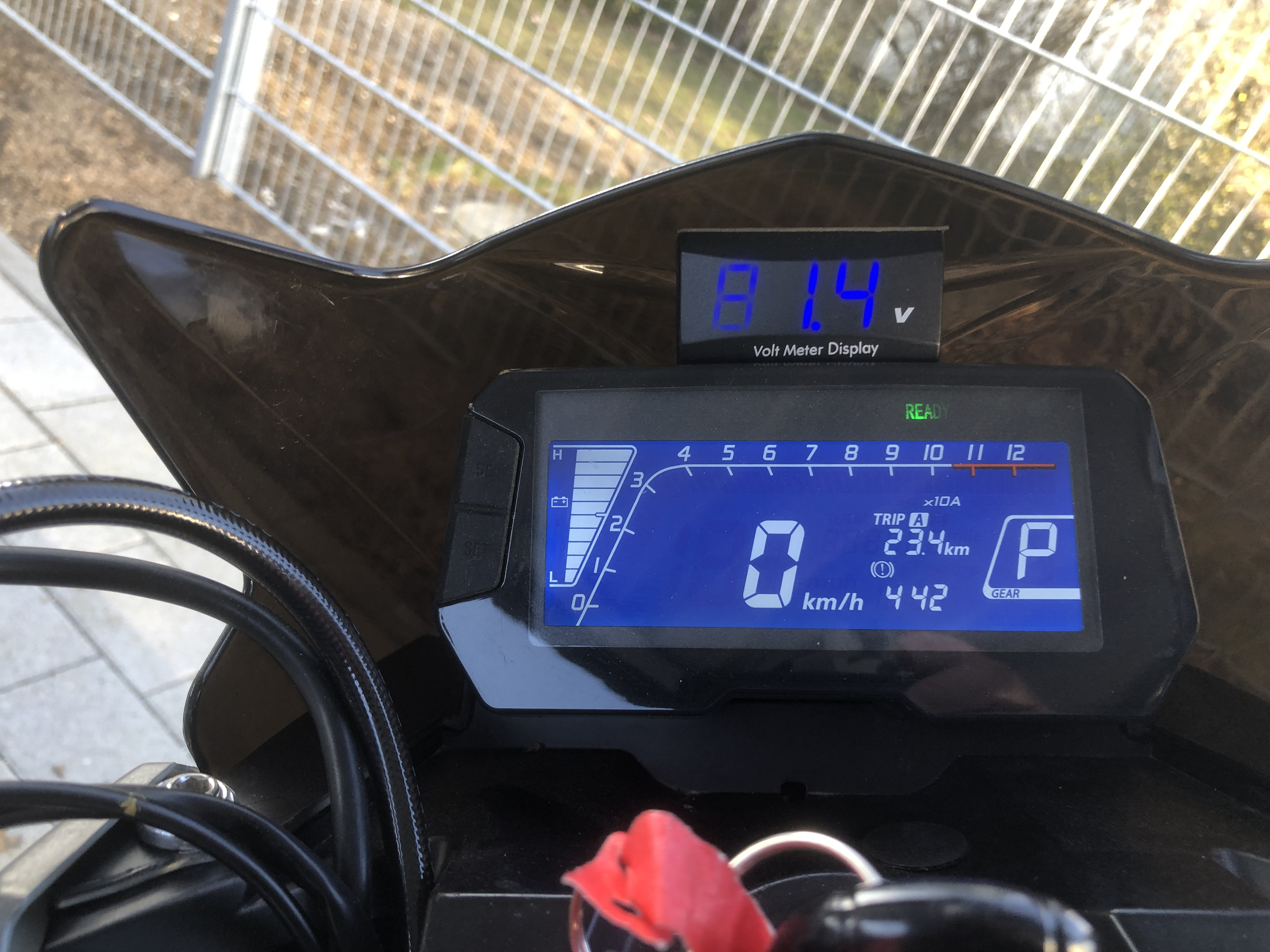

An dieser Odin wurde zum ersten über der Instumenteneinheit, die bei Sonneneinstrahlung unlesbar wird, eine Batteriespannungsanzeige eingebaut, da der Füllstand links sich auf meinen ganzen Fahrten keinen Deut von der ganz voll Position wegbewegt hat:

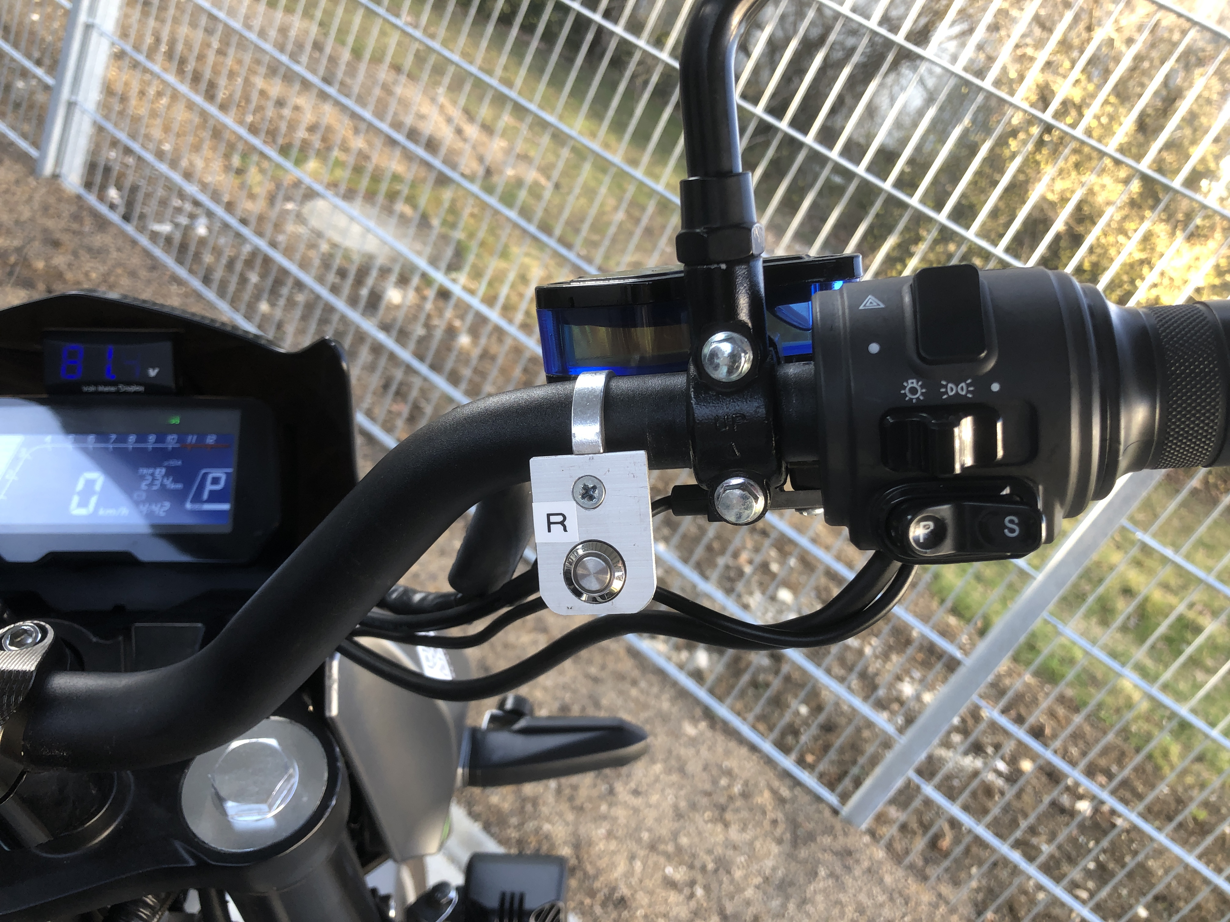

Ebenso wurde ein Druckknopf zum Rückwärts rangieren rechts an den Lenker gebaut, was aber ein Drücken mit der linken Hand benötigt hat, denn mit rechts kommt man da nicht hin, während man den Fahrgriff betätigt. Trotzdem ist das aus meiner Sicht eine unbedingt nötige Institution, welche meine Zero als erstes el. Zweirad NICHT hat. Meinen vorigen E-Rollern hatte ich es jeweils selbst nachgerüstet...

Die Odin hat erst ca 450km drauf und die Reifen sind schon abgefahren?
Ich glaube standardmäßig ist die Rekuperation an den Odins deaktiviert.
Der R-Knopf sollte eigentlich an der rechten Bedieneinheit neben dem S sein, auf deinem Bild sieht es so aus als wurde dort das R zu einem P "umgepinselt" worden.
Das P sollte eigentlich an der linken Bedieneinheit sein.

Zu (1): Warum das denn, wenn man die (R) Taste (neben dem (S)) gedrückt hält, geht die E-Odin 6.0 doch sowieso auf Rückwärtsfahrt und im Display steht statt P dann ein R. Aber vielleicht ist bei dem Teil ja auch das Schalterelement defekt :?: .

Zimmermännche hat geschrieben: Do 6. Mär 2025, 21:17Die Odin hat erst ca 450km drauf und die Reifen sind schon abgefahren?
Diese Odin ist schon über ein Jahr alt und hat schon über 11000 km auf der Uhr. In meinem Bild sind nur Trip-Kilometer dargestellt, hatte keine Zeit, mit der Anzeige rumzuspielen. Vom R den schrägen Strich weggekratzt kann ich nicht ausschließen. Ich weiß nur, dass nach dem Schlüsseldreh, und ohne am Killswitch ausgeschaltet zu sein, die Fahrbereitschaft nur hergestellt werden konnte, wenn man mit gezogener linker Bremse die Wippe auf "P" gedrückt hatte. Dann Rechts auf S die Stufen von 1 bis 3 durchschalten.
Links ist mir kein P aufgefallen, nur Blinker, Lichthupe und Hupe.
Ah ok, dann dürfen die Reifen bei 11000 km auch etwas abgefahren sein. Ich dachte das wären die Gesamte km, da darüber ja Trip mit 23km stand...
Ist bei der Odin 3.0 ja etwas anders, da dort ein " moderneres" Farbdisplay verbaut ist, bei der 3.0 wird auch die Voltzahl neben den Ladebalken angezeigt.
Er scheint auf jeden Fall schon einiges geändert zu haben ( Daten im Controller angepasst: Reku an... ) und wahrscheinlich auch Belegungsänderungen wegen defekter Bedieneinheiten P von links auf rechts wo R war, extra R Knopf.
