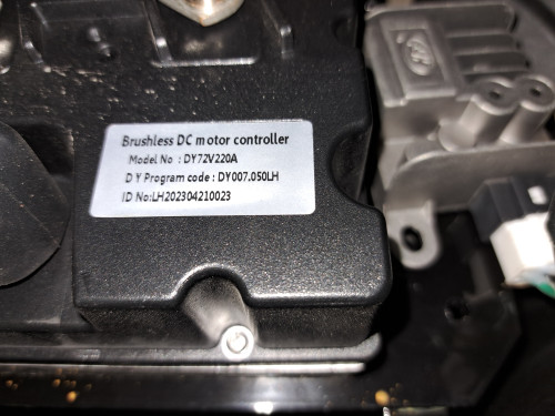

Miguello80 hat geschrieben: Mo 13. Okt 2025, 01:44Hi, are you able to share detailed photos of controller boards ?PO6EPT hat geschrieben: Di 23. Sep 2025, 20:24 Also wenn jemand weiß wie ich meine E-Odin 3.0 wieder zum laufen bekomme oder welcher der richtige Ersatzcontroller mit Link mir schicken kann wäre ich sehr dankbar, ansonsten muss dieser 7100€ Schrott auf dem Schrottplatz.
It is very small chance it would help with finding the solution of problem with impossibility to pair the motor with another (encoder) controller but it can not hurt.
(Yeah, I can not recommend Madatshop either, owner owes me money for returned wrong parts (his mistake)).
I am in contact with few guys in French that tries to make 3.0 motor work with 72680b, also some guy on this forum tried it (sorry, I do not have memory for names).
I believe it can be solved, as far as I know (I could missed it of course) nobody
1. checked encoder wires wiring = compare the factory pinout and 72680b´s pinout, there could be a difference that makes it impossible for controller to control the motor
2. measured signals from motor, especialy from encoder
I have nobody with 3.0 around so I am not able to dive into it, I have an offer of 3.0 motor for free, but it is in France and I do not want to pay lot of money for shipping when there is chance that I am wrong and the motor would be useless for me. But I am still thinking about it...

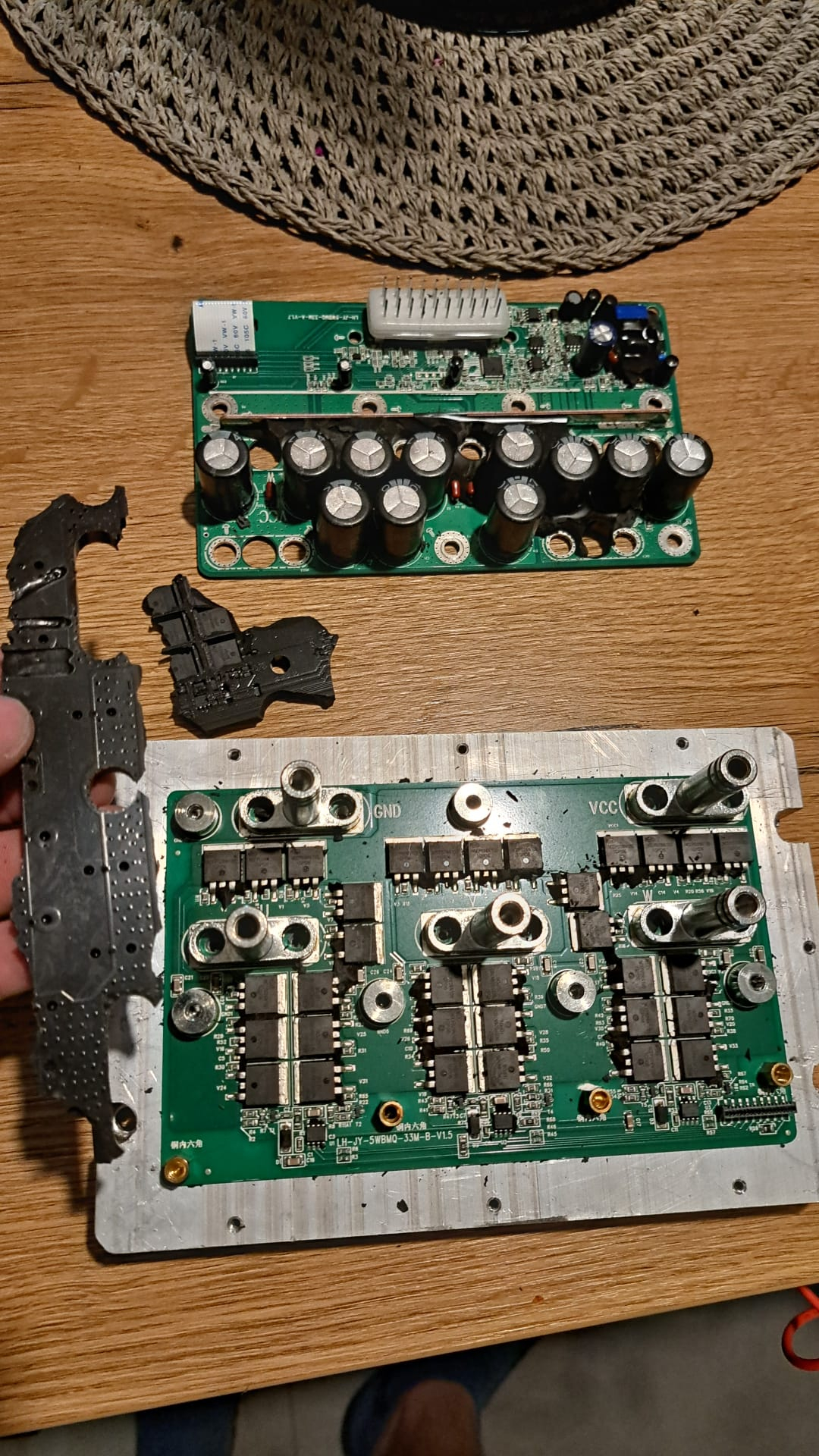

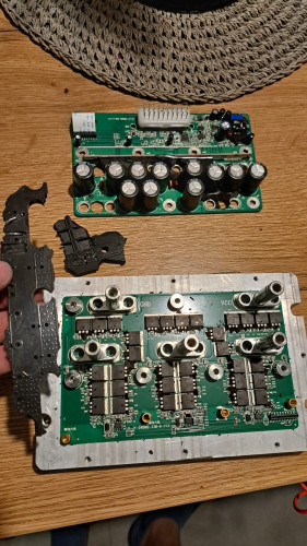

Danke Robert für die Fotos.
Welche Mosfet-Typen sind auf der Platine verbaut?
PS. Schade, dass die "Kühlpads" zerbröselt sind...
