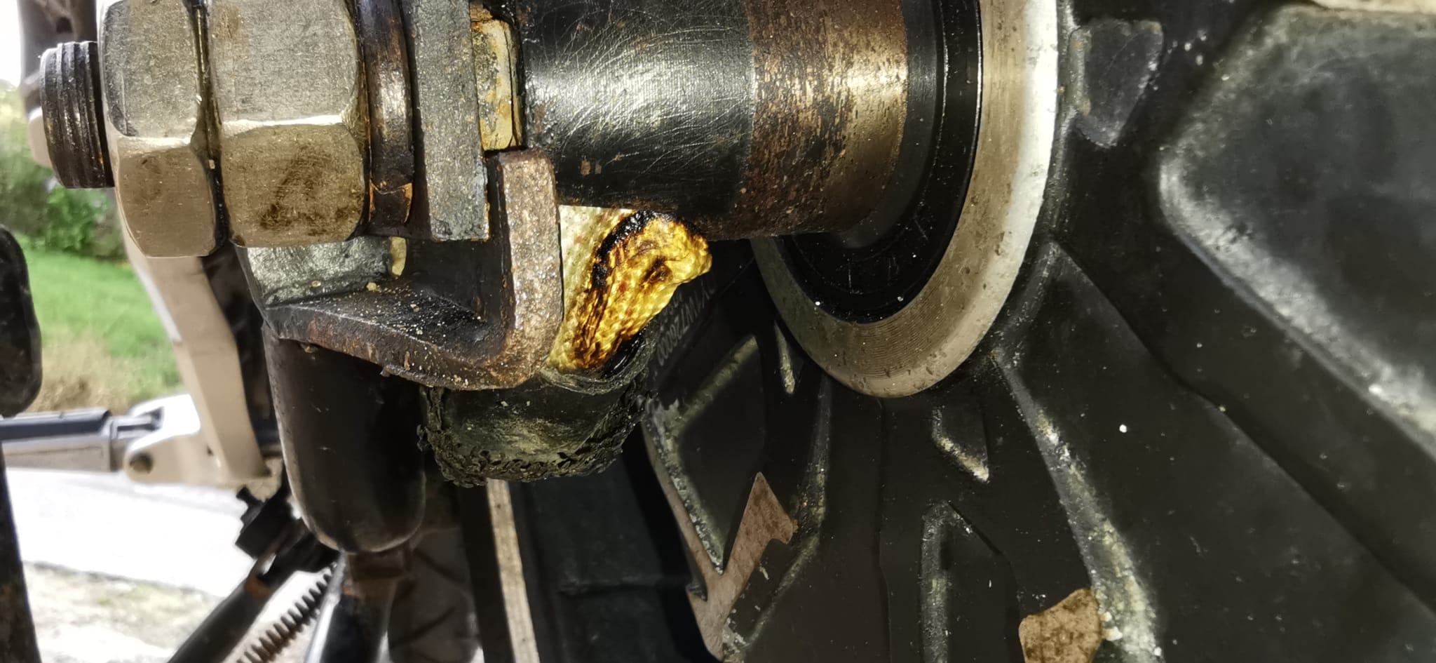

There is a 'hole' in the rear axle where the phase cables go in, I presume this is a route for road spray and dust to pass down the route of the phase cables and make a mess in there.
Mine looks, to me, to be a bit of a mess. The outer protector sheath is creased up, I can't tell how pinched the cables actually are. They have to go around a bend so are going to be pretty tightly wedged in there.
What does your rear axle look like, how do the phase cables enter the axle?
Mine was like this;
and I don't like how that fibre shield is crunched up.
Is it meant to look like that? How does yours look?
I wrapped tape around it to prevent ingress.
I bought self-amalgamating tape specially to do this, and I don't know where it has gone! Grrrrrr... Just electrical tape for now until I find it.
