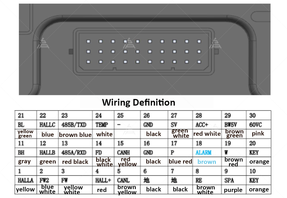

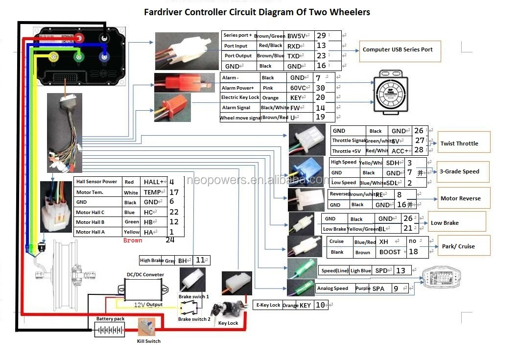

TwisterMax hat geschrieben: Fr 8. Dez 2023, 12:09 Wie schließe ich die Kabel an den Stecker an?
You do not have to take 30pin out but here is how to: squeeze two holders on both sides of 30pin connector, use small screwdriver or something similar to pry it out and wobble, do not pull by wires.
Classic Fardrivers should use white 4pin square automotive connector for diag so try to find it.
This is wiring diagram of my 72680 (upgrade from "72400" = 120A/400A), a little bit corrected by me, pins ARE NOT same for 72530. With 72330 I could not connect to diag.
Pins: 13=Rx, 23=Tx, 16=GND, 29=5V.
I would be very careful with reku. As we know it is turned off by manufacturer and I believe that it is because he knows it can cause problems + some users will want to turn it off or set it in different way so he solved it this way.
Yes, Jeff and some others used it all time, with pretty high values, but also Jeff had to replace his controller, me too. I do not have a proof that it was related to reku but I saw somewhere voltage spikes that Fardriver does not handle as it should. Now controller has new section in settings for % of reku, I did not play with it yet, I hope it will help to handle those voltage spikes better. I would like to use this great function, especially as an engine brake to save brakes, but I can live without it so for safety of my controller I will not use it untill I will be sure it will not damage my controller.

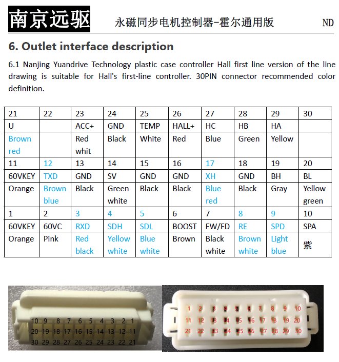

Ich habe gerade mit Schrecken festgestellt, dass sich die Positionsangaben der Kabel in den Manuals von @jeff-jordan und @Miguello80 unterscheiden.
Jeff Miguello
BW5V 22 29
RXD 3 13
TXD 12 23
GND 13 16
Kann man sehen, welche Controllerversion ich habe?

TwisterMax hat geschrieben: Sa 9. Dez 2023, 12:45 Ich habe gerade mit Schrecken festgestellt, dass sich die Positionsangaben der Kabel in den Manuals von @jeff-jordan und @Miguello80 unterscheiden.
Jeff Miguello
BW5V 22 29
RXD 3 13
TXD 12 23
GND 13 16
Also der Controller ist schon mal der DY72V 150A "original-Controller", welcher 1:1 Pinkompatibel mit dem ND72530 ist.
Wie die Pinbelegung von Miguello80s ND72680 ist, weiß ich nicht und ich würde da auch nicht automatisch von der gleichen Belegung ausgehen.
Da ich ja noch den ungenutzten Kabelbaum von meinem ND72530 herumliegen habe, konnte ich die Belegung gerade nochmal nachmessen.
RXD ist Pin#3,
TXD ist Pin#12,
+5V ist Pin#22
GND ist Pin#24.
Hinweis: Die Pins#24, #13, #15, #16 & #18 liegen alle auf GND (ist im Controller durchverbunden).
D.h. meine damals gepostete Pinbelegung für den Kommunikationsport passt.
Und ja: auf die Leitungsfarben im Bike sollte man sich tunlichst nicht verlassen. Lieber mal zum Multimeter greifen und nachmessen.
