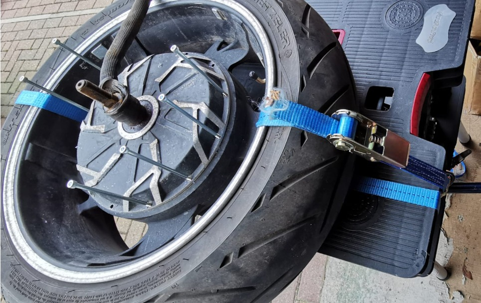

The motor is dismounted and I have strapped it to my fold-up work table.
I have removed the screws and installed guide-bolts.
My hydraulic jack fits perfectly so I can push it up from below.

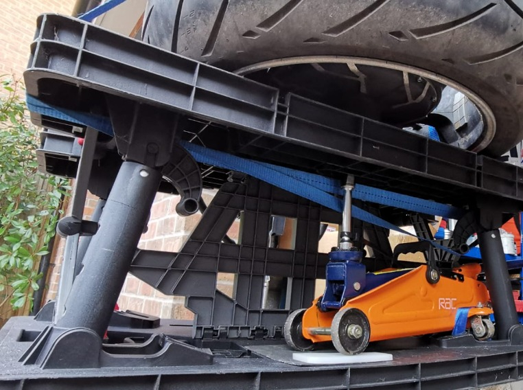

I hope this plan works!
Guide bolts fitted in place of the fixing bolts.
A jack pushing up on the axle.
More importantly is to see if this works, so I can do the reverse when I replace the stator. I want to control it as it gets sucked in to the motor.

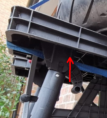

Don't know.... will it work with this platform when the force of the jack moves the legs out of their seats?

jeff-jordan hat geschrieben: Sa 25. Jan 2025, 09:45 Don't know.... will it work with this platform when the force of the jack moves the legs out of their seats?
Good question.
Thanks for thinking it through with me.
I wasn't expecting that much force, once the stator is finally coming out, but I don't know, so thanks for that. I will strap that up too. Easy to do.
Beiträge: 20645
Re: Dismantling and repairing the motor :o
The force can easily approach the region of >500kg for getting the stator moving! I set it on the ground with the to be pushed out axle resting on the concrete floor. Then with all my weight (>100kg) I stepped on the rim side resting on the ground, and with other leg I JUMPED on the side in the air. That was just marginally enough to push the stator out enough so I could grab the other axle (with the nuts on it) and finally pull it out...

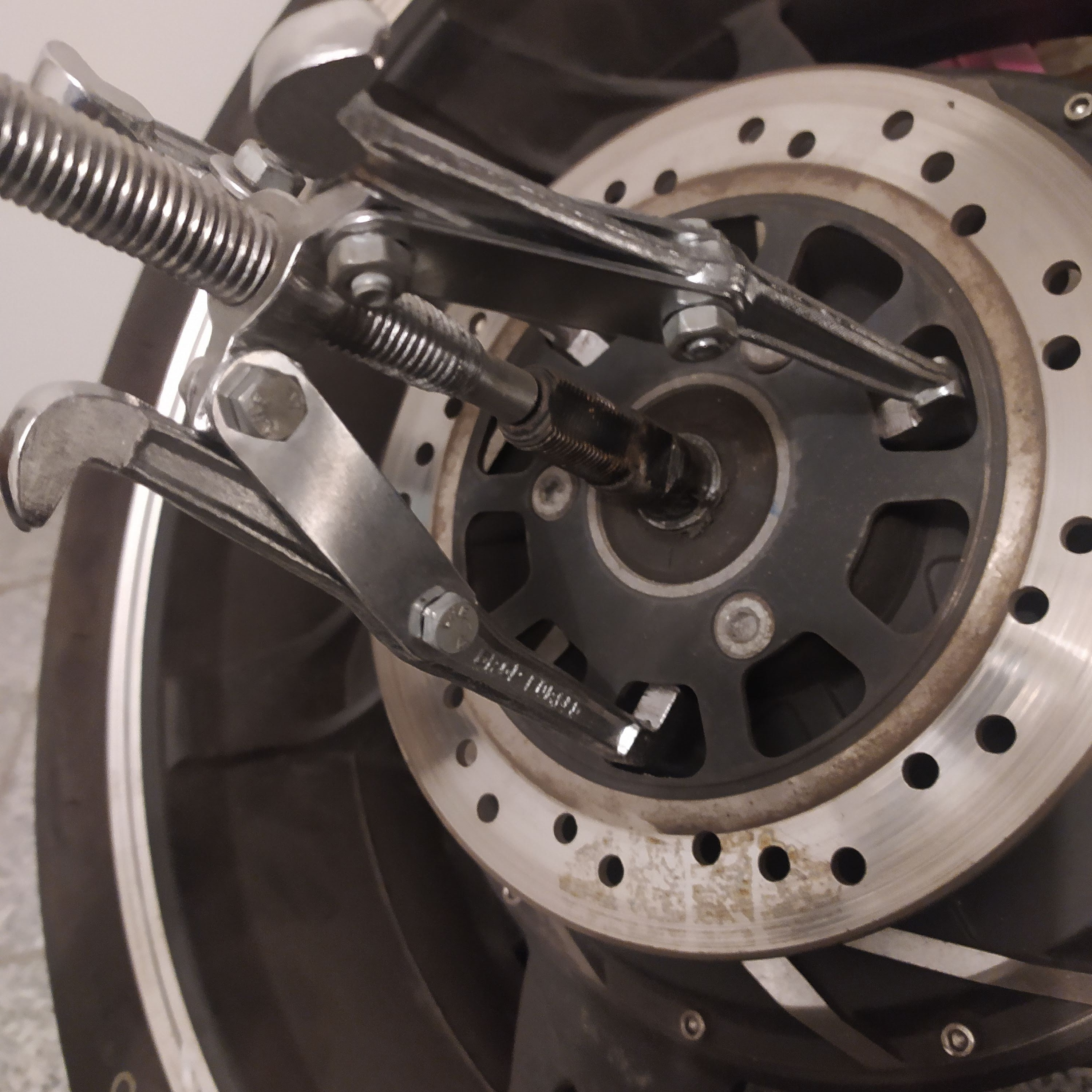

Hi Bob,
why don't you look at the photos that jeff-jordan linked to you on the first page? The cover is connected to the motor. With a puller you can simply push the stator out.
