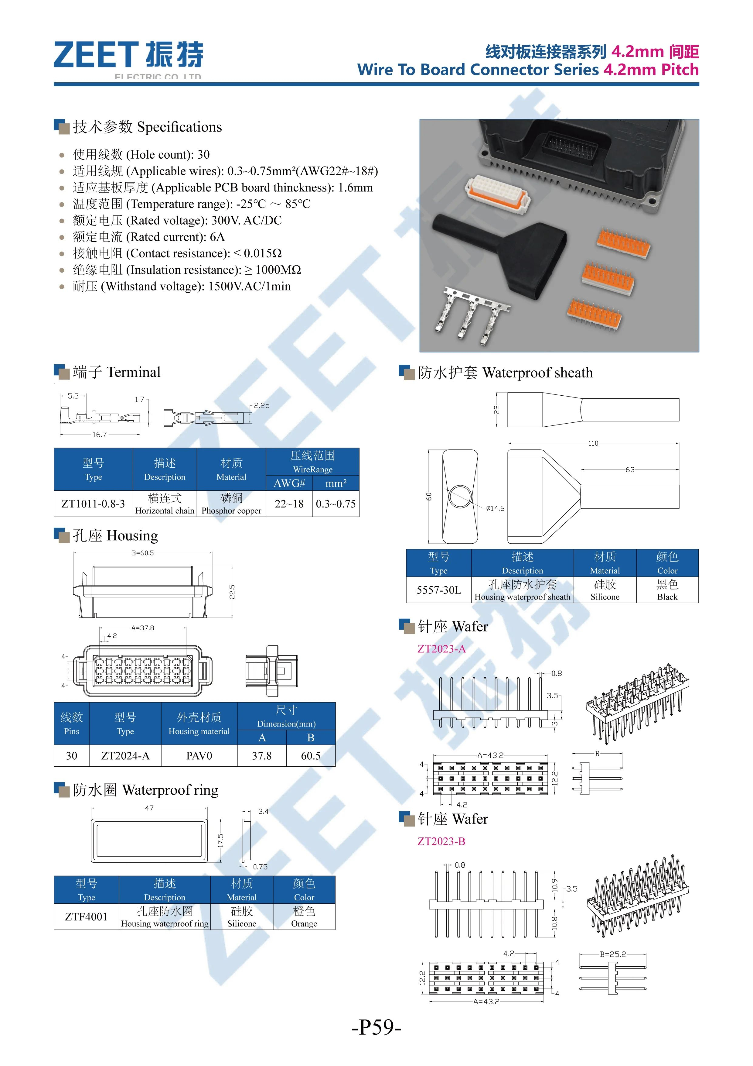

I found out which 30P connector is used in the Lingvo controller, ZT2024-A.

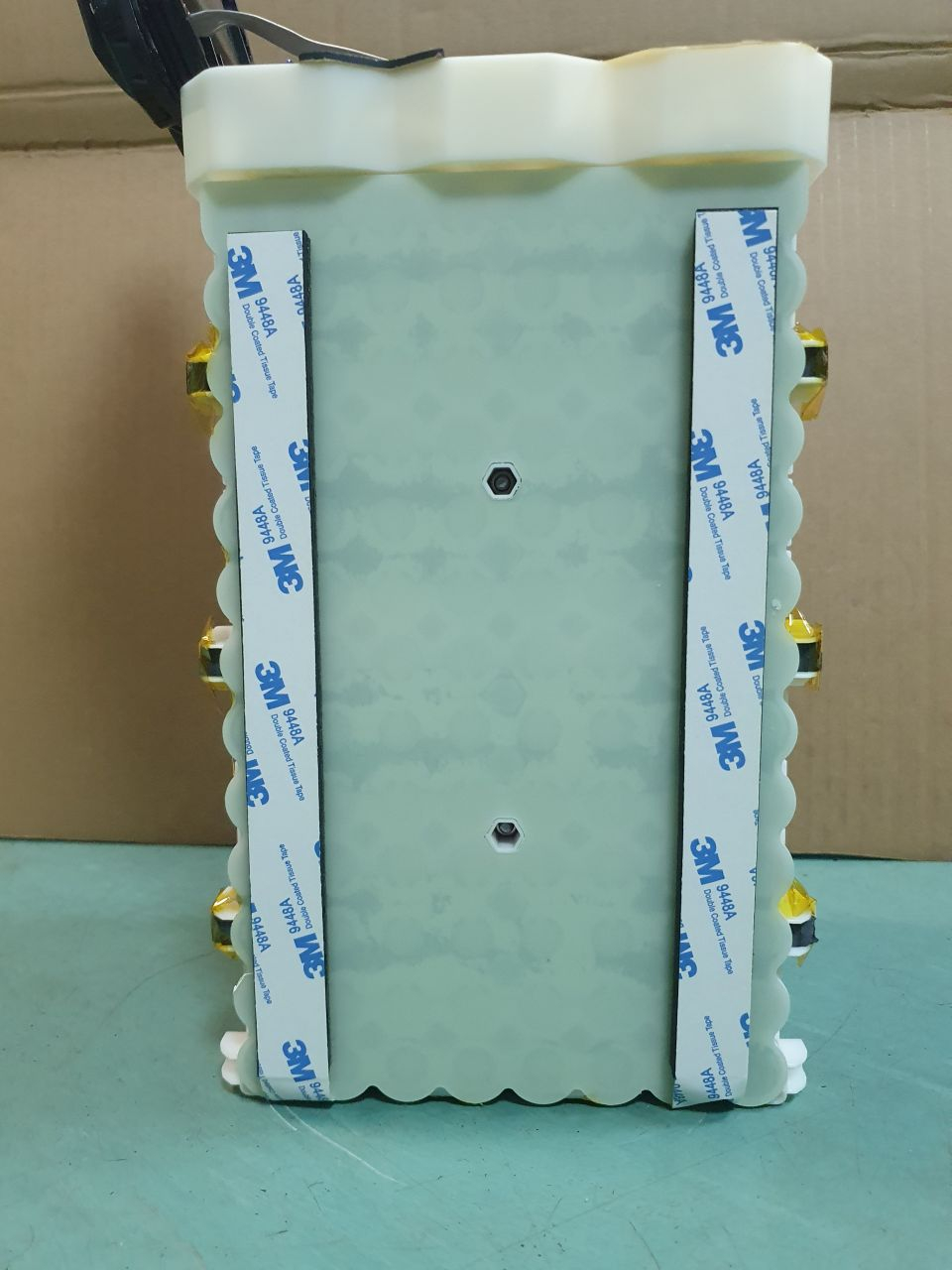

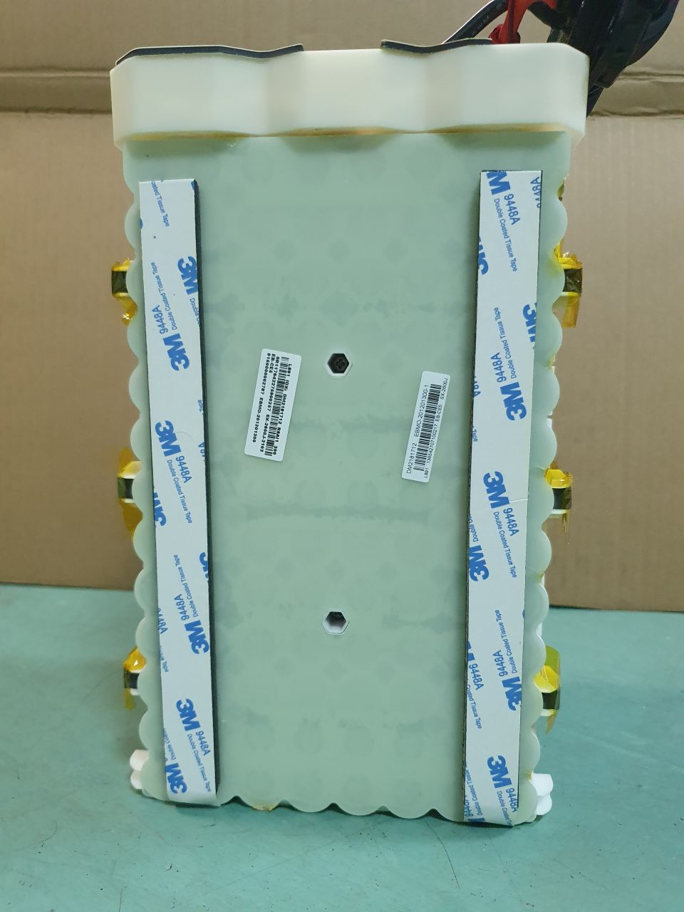

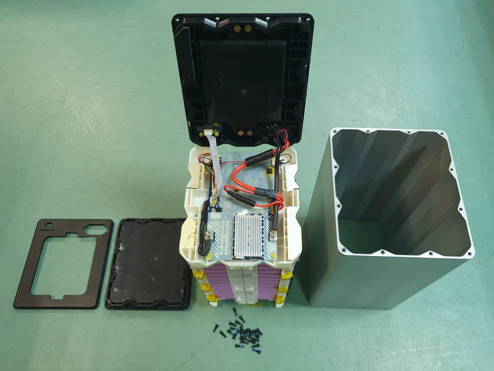

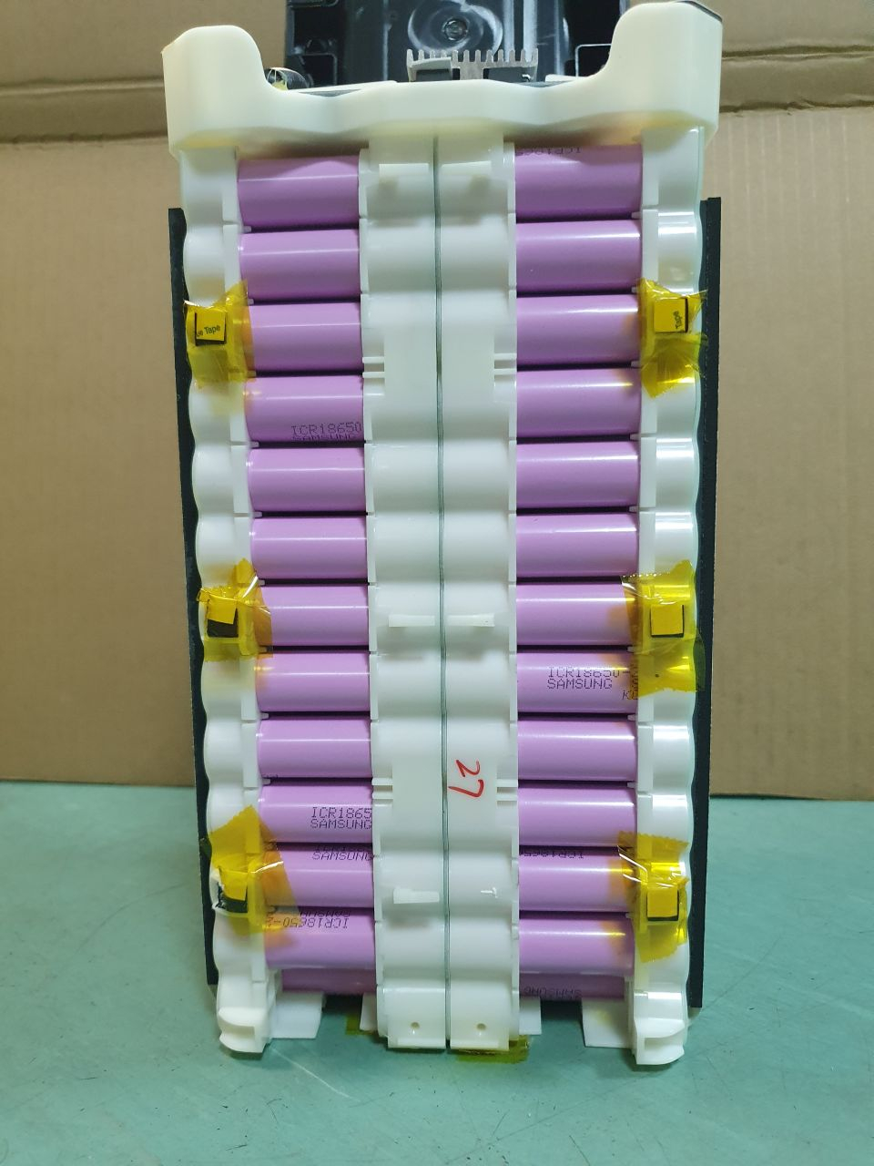

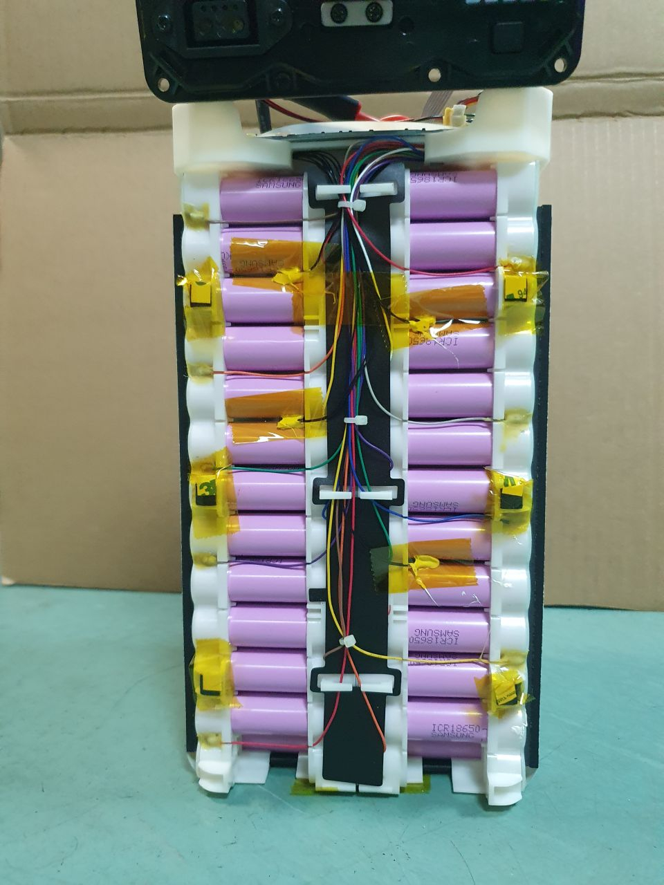

Tromox Mino Battery (what's inside)
Configuration: 204 Samsung ICR18650-26? elements (the end of the marking is not visible under the holders), 17S12P.
