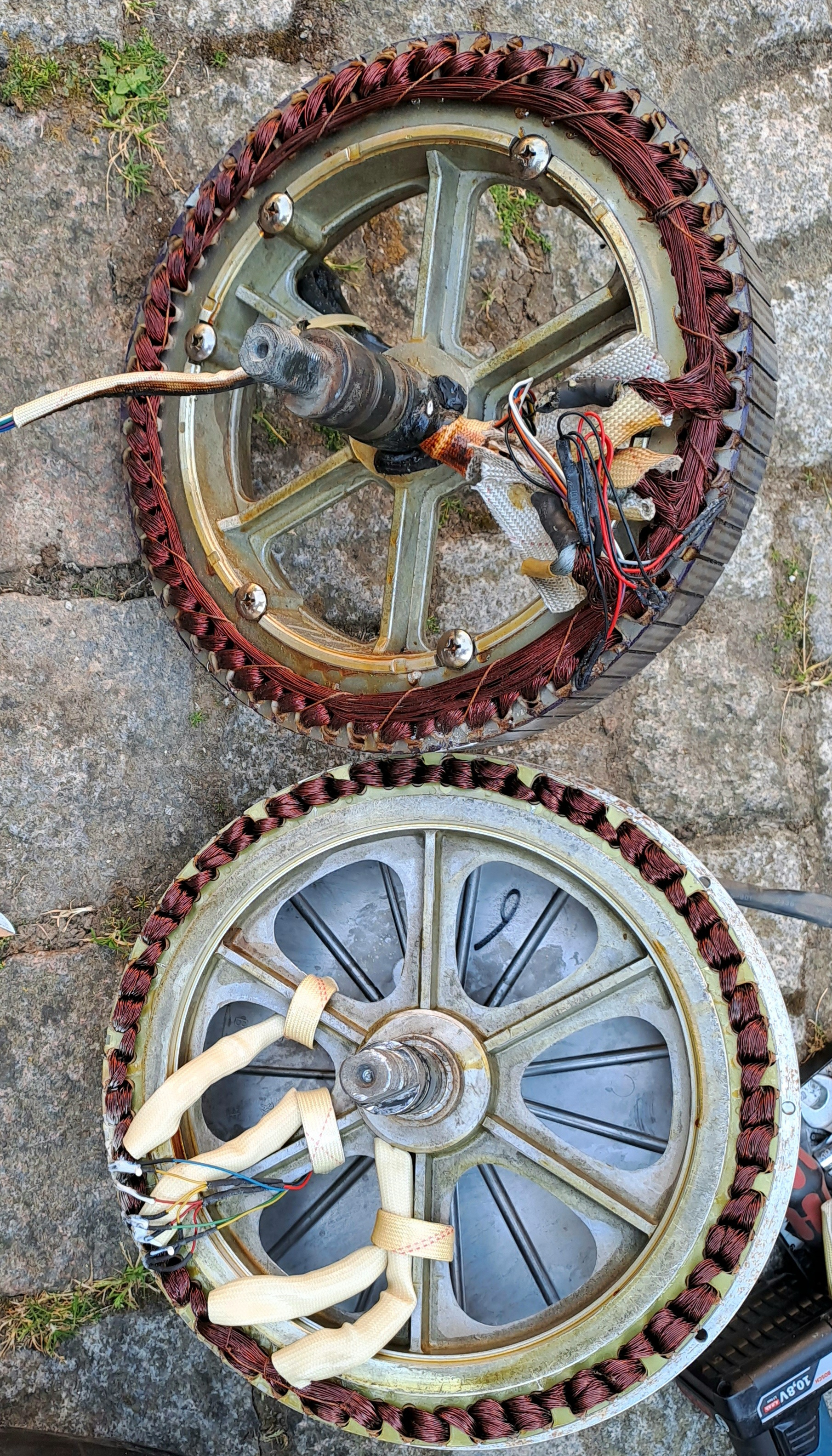

As it was easy to open my QS60V5000W motor, there was only little sealing at the cover, I opened the second and good motor I had just to have a look insight.
The one with less copper was sold in an 8kw scooter and had slightly bigger magnets 45mm instead of 40mm in the 5kW QS

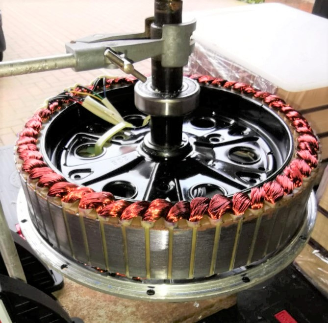

bob2.0 hat geschrieben: Mo 27. Jan 2025, 20:27It makes me wonder more if there is a bearing tolerance issue, and the axle has sagged a bit, and is running tilted.
Worn-out bearings made one of my 5kW erider Motors go zingzing ever stronger, so I replaced it with my second motor and took it apart. I took the stator to a friend with a big lathe in his shed, and stuck the stator in there, gripping the axle. And lo and behold, the stator itself was off-center by about 1 mm, and who would have believed it, the highest point had the scratches from the hitting magnets!
We turned away the excentric shape, turning it into a true centric stator. After that came the coating with clear coat to inhibit corrosion, a set of new bearings and seals, and I put the motor back together. The now even, though slightly larger airgap gave the motor audibly and feelably more grunt, so that was a 100% successful endeavor :D

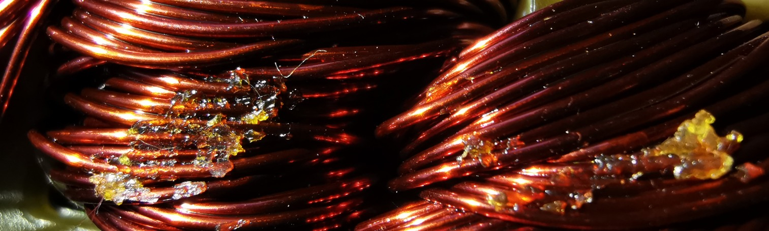

I now mention the 3rd anomaly I have seen in my motor.
I notice now, on the photograph close up at the bottom of page 3 of this thread, these details;
WhatsApp Image 2025-01-27 at 21.32.03.jpeg (54.72 KiB) 966 mal betrachtet
WhatsApp Image 2025-01-27 at 21.32.31.jpeg (102.77 KiB) 966 mal betrachtet
I looked again because I also have these features, and I wonder if they are a short, and where the enamel has melted? These photographs are from my motor;
Are these shorts, or another problem? Or, normal?

Can you turn it easily, without the laminations bending and twisting? I guess you did!
I will measure both the magnet radial position and the rotor.
I think there will always be both, neither magnets nor rotor can be perfect radius. Then the largest part of the inner may touch the smallest part of the outer.
(Perhaps it is easier to make an accurate air gap with axial flux motors?)
A bigger gap will mean faster? But only a little extra gap. It is field weakening without the waste of current?
Beiträge: 20642
Re: Dismantling and repairing the motor :o
We were VERY careful with the turning, only taking 1/10th of mm off at a time, then a little more. Only the most outward lamination loosened slightly.
The slightly bigger gap caused more torque, not more speed. Possibly because it increased the "hunger" of the magnetic field, more than was lost in field strength.
