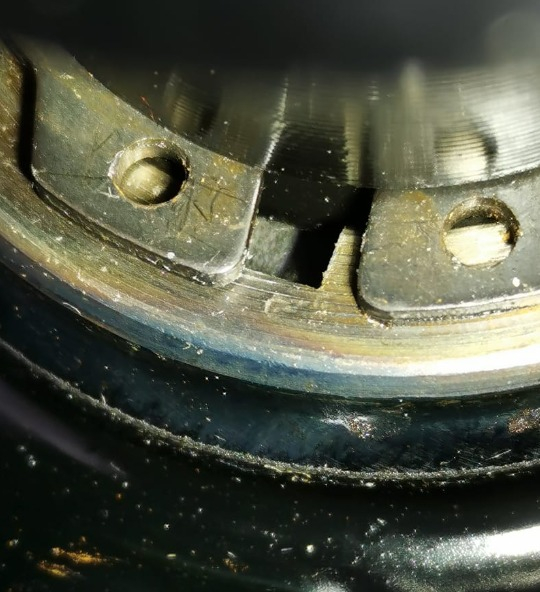

bob2.0 hat geschrieben: Di 28. Jan 2025, 15:57 I guess maybe a woodruff key? I can take the circlip off to see what is underneath it on the shaft, if you like?
I expect something like such a woodruff key. But there must be some kind of anchor point at the stator package. I guess that's the weak spot.
It would be really nice if you can have a look underneath it and take some pictures where shaft and the steel sheet of the stator are fixed together.
Then I can estimate what it takes to fix the issue.... or just to leave it as it is now (currently without recu).

I have lost my circlip set (again!) but I could rotate it around.
There is a woodruff key in there, or at least, some sort of detent, not quite sure.

Thank you bob for taking that extra picture.
Curiously, my special pliers for the circlips dissipate regularly too.
MEroller hat geschrieben: Di 28. Jan 2025, 16:56 ...What is clonking during torque reversals are the flat spots of the axle ends rocking back and forth in the fork of the swingarm, due to losened nuts. ...
That's what I first thought too, so I checked all the axle nuts and tightened them as tight as I could... but it had no influence at the "tschack" noise.
