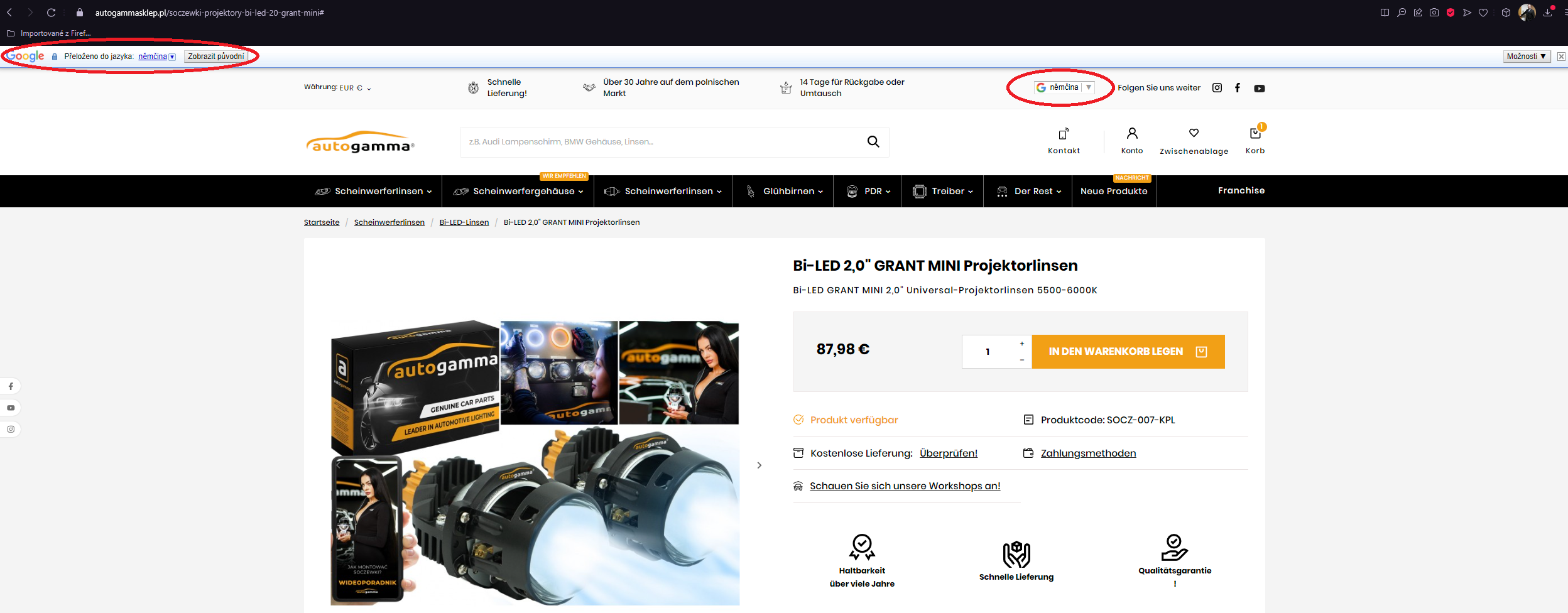

Ok, so translation problem...
When I open this page in Opera GX browser, it offers automatic translation of whole page using Google Translator.
It does not do it on this page so I thought it is implemented in webshop... I just added the Google Translator add-on but it does not work as I am used to from Firefox, I have to figure it out.
In Firefox I have Google Translate Element add-on that allows me to switch whole page / web into another language (this I use for this forum, easier than copy paste into translator, only for reply/answer I have to use non-translated page).
Autogamma uses chat box so during work hours you can ask directly. Or via Facebook (https://www.facebook.com/Autogammasklep) or e-mail sklep@autogamma.pl.
