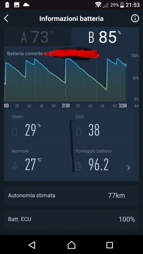

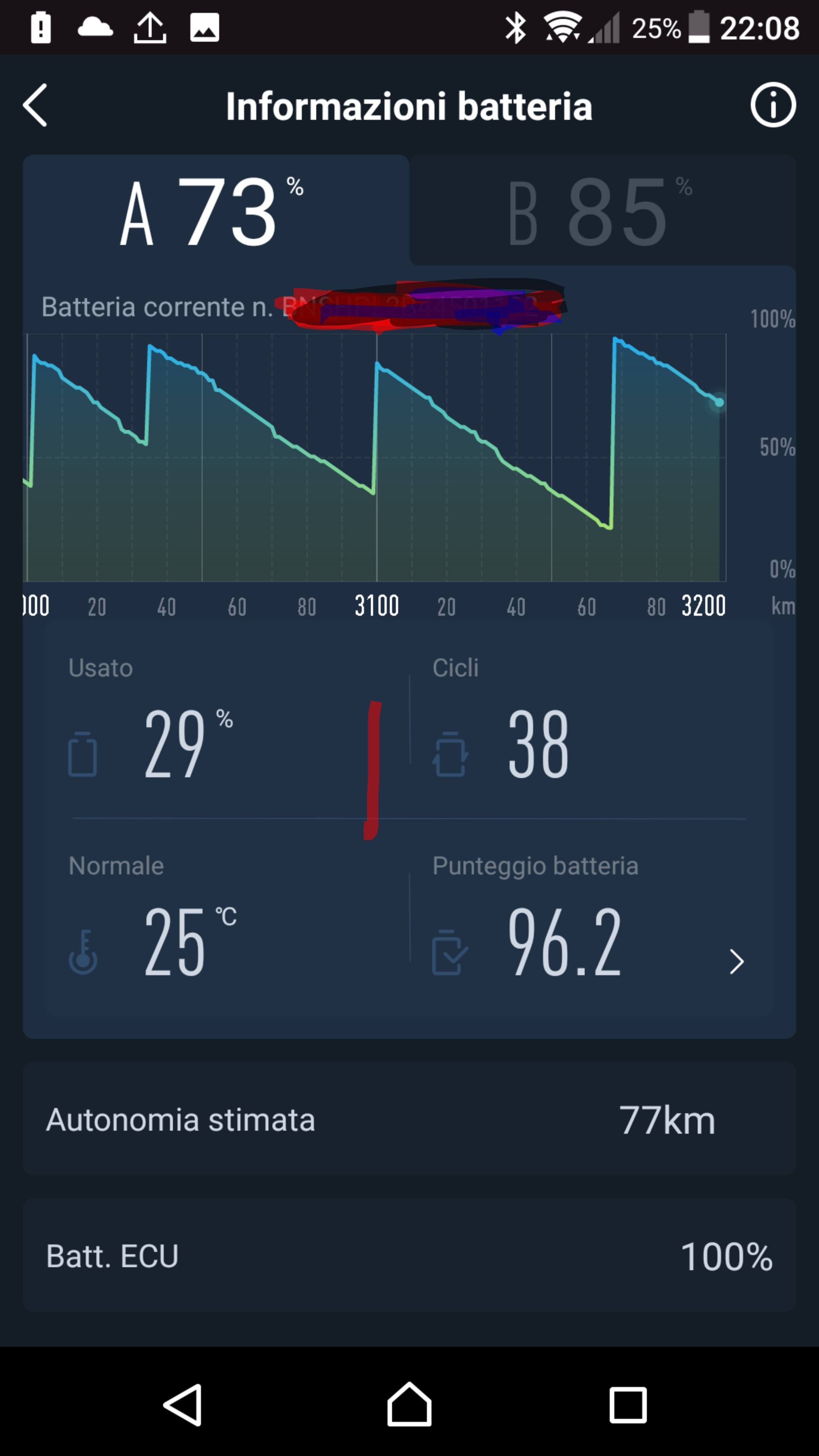

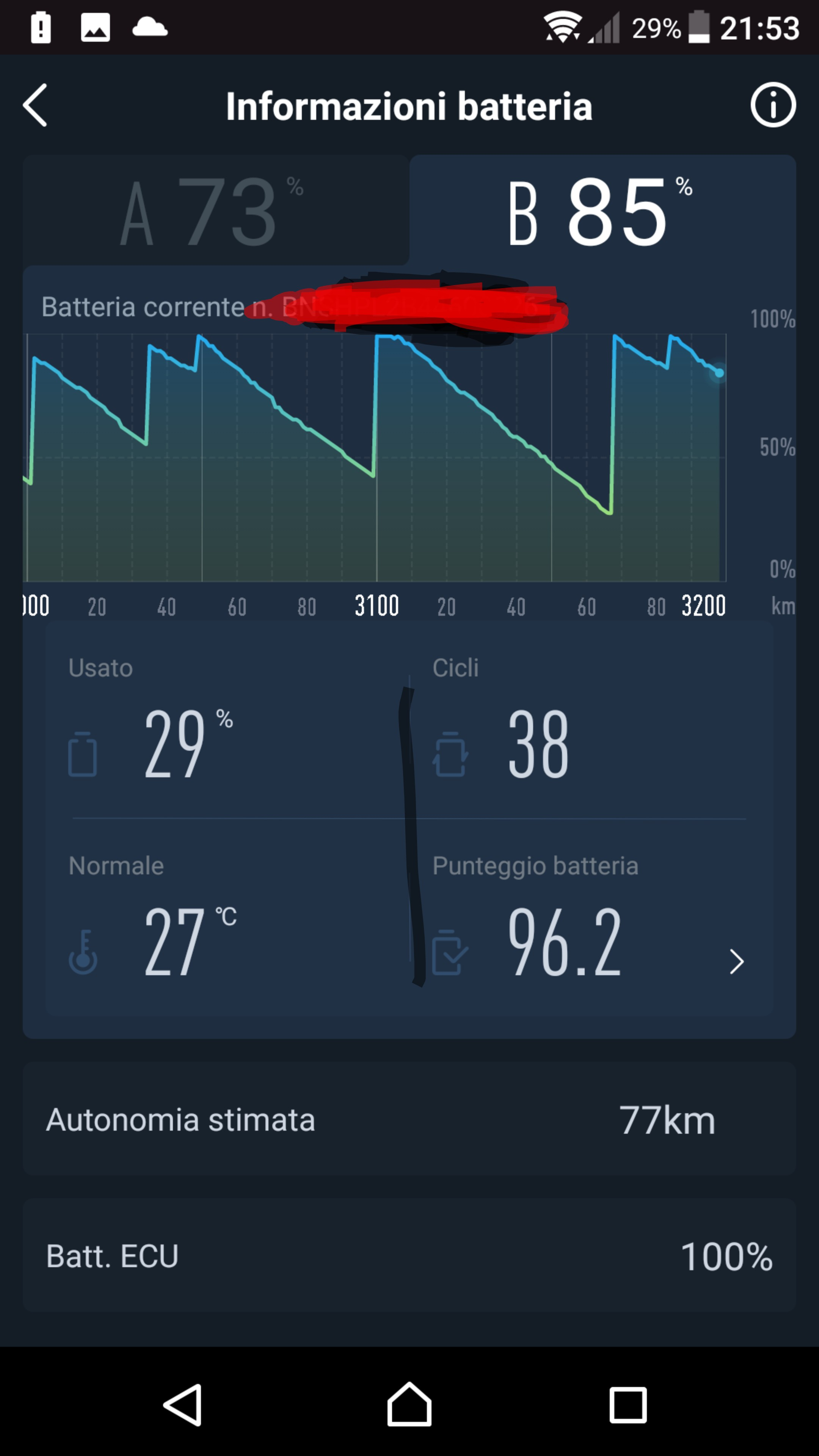

Idem, battery B higher (not correct). This after installation of 3.9.18, before was ok.

Are the values shown in your app the same as shown on your dashboard?

Yes
