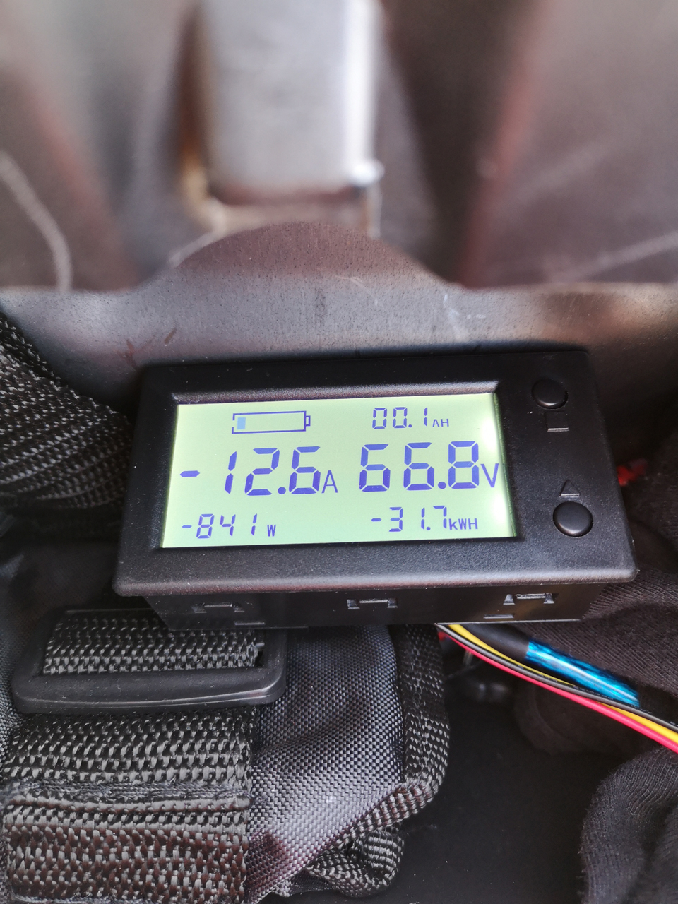

as Didi mentioned: the adapter in your link is to configure the controller. And yes, I've got it and it works to configure the controller and monitor the actual status of the bike (like voltage, current, rpm) with the MotorNet App via bluetooth. But it doesn't allow you to get the real remaining capacity of your battery. There is no communication between the controller and the battery. In fact the bms inside our Odin battery is very dull (jbd-hp32s001) and has no bluetooth or "intelligence" on board to determine the remaining capacity.
For the monitoring of the battery, I use 2 different coulomb-meters. One that uses a 150A shunt (which is not easy to install), and one that uses a hall-sensor ring.
Both coulomb-meters show nearly the same values of the remaining battery capacity and it's way more reliable as the estimation of the speedometer (which is derived from the battery voltage).
But I'm soon going to try a third one (a newer model), that's similar with the one using a hall-sensor, but with bluetooth (& App) too.

I've ordered it last sunday.
Usually it takes ~ 22 days between ordering and delivery from China to Germany.
But that's highly depending on the Covid19 status of the Shanghai region in China :? .
My version without the bluetooth function is already installed inside my tank box (because these devices are not waterproof), as you can see here:
So as soon as I got the new one, I don't need to open the lid of the tank box.... just look at the App :) (of my waterproof smartphone).
.... hopefully ....

Sorry for not posting here that I've already installed the bluetooth-version of the coulomb-meter and that I developed my own android app (which connects to the coulomb-meter), so that I can see the actual energy required per kilometer, the average energy per kilometer, the remaining energy inside the battery and a predicted remaining range (and serveral other infos).
The "standard" WBMS app, that comes with the coulomb-meter, provides less information (battery %, remaining capacity, amount of used energy, voltage, current), but it's still usefull... and much more reliable than the 10 bars shown at the speedometer.
I've seen your request for showing how it is assembled inside the e-odin, at the other thread.
Unfortunately I made no pictures while installing the coulomb-meter at the first time... so I made some pictures "afterwards".
I have to add some informations and as soon as the package is ready (expect it this week*), I'll post it at the other thread.
At least the "basic" way to install the device :roll: .
