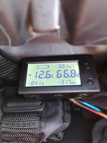

Sorry for not posting here that I've already installed the bluetooth-version of the coulomb-meter and that I developed my own android app (which connects to the coulomb-meter), so that I can see the actual energy required per kilometer, the average energy per kilometer, the remaining energy inside the battery and a predicted remaining range (and serveral other infos).
The "standard" WBMS app, that comes with the coulomb-meter, provides less information (battery %, remaining capacity, amount of used energy, voltage, current), but it's still usefull... and much more reliable than the 10 bars shown at the speedometer.
I've seen your request for showing how it is assembled inside the e-odin, at the other thread.
Unfortunately I made no pictures while installing the coulomb-meter at the first time... so I made some pictures "afterwards".
I have to add some informations and as soon as the package is ready (expect it this week*), I'll post it at the other thread.
At least the "basic" way to install the device
