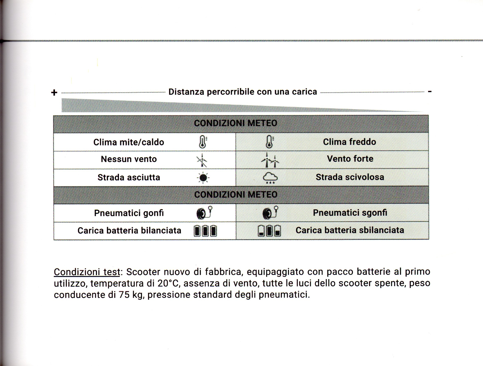

However, they invite me to test the scooter "on the same journey" in D1 mode (50km / h maximum). Although it may be a stretch that I travel at 50-60km / h for the most part, there are also many heavy vehicles that travel the same road and as often happens, they do not keep very far when they have to overcome a snail on the 70km / h limit. that gets in the way at 50km / h. I decide that it is too dangerous to go so slowly as it is not a car and I travel a route with fewer stops and restarts in the open countryside on wider and less busy SP or SS, as indicated in the manual I help to maintain a better autonomy since it was a mild day, little wind and plain.
I know that it's in Italian, but I think that we have the same Manual and we can read the one that we have with us.
