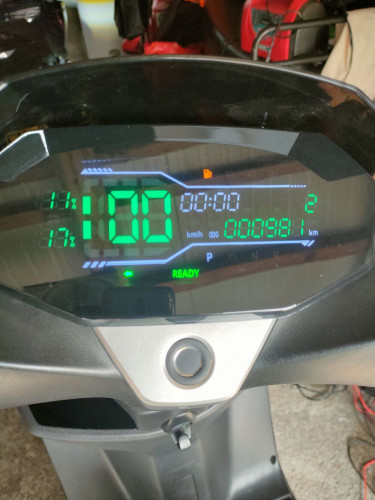

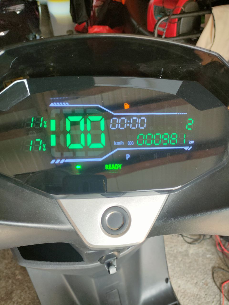

In the end, as always, I cover 3 trips (round trip) with a total of 57km since the "reserve" light came on at 981km:
(90km advertised at the sale, 53km registered ... and the other 37km? to the fairyworld?)

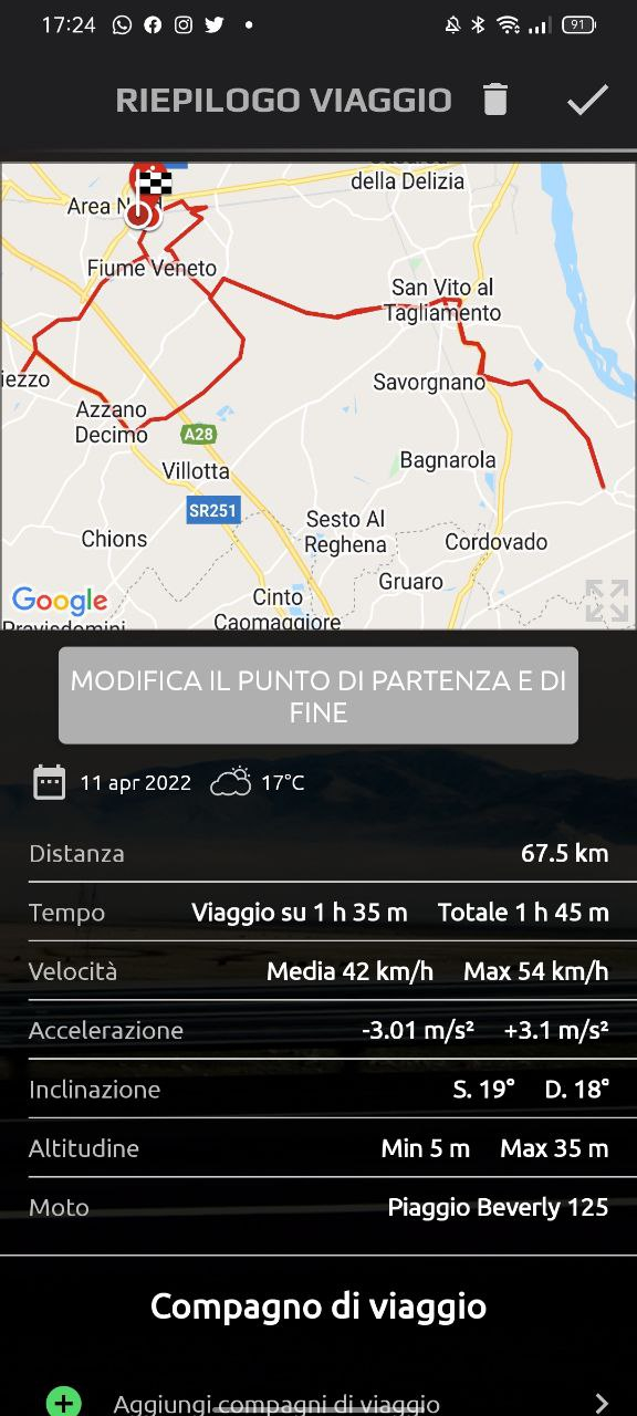

To demonstrate that I am taking these measurements seriously, I use a Yamaha app that tracks the route and records the maximum-minimum-average speeds etc ..
I start driving with the D1 mode only and travel 72km in 1h and 46min crossing the localities of San Vito al Tagliamento, almost at the height of Cordovado to return towards Azzano Decimo and finally to the starting point:
I report everything to the workshop by also sending the videos I recorded during the ride to testify the kilometers traveled and the travel time (if someone is able to use the calculator it makes [space] / [time] and calculates the average speed, put the case that a bad faith is assumed).

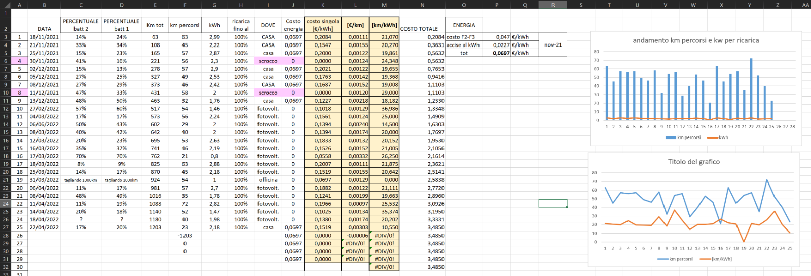

By the time had carried out 25 recharges, all documented and looking at the data of routes and recharges (ditto the kWh consumed to recharge it) I do not notice alarming variations, however the data collected are still few to be able to observe something:
There is a huge difference between the declared / advertised autonomies and those recorded during use, namely:
- mode D3: declared 90 [km] to 85 [km / h], measured 57 [km] (taking into consideration the first test communicated), therefore the 36.66% difference;
mode D2: declared 110 [km] to 70 [km / h], measured 57 [km], therefore the 48.18% difference;
- D1 mode: declared 135 [km] at 55 [km / h], measured 72 [km] (last test) at 42 [km / h] on average, therefore the 46.66% difference.

Currently i have done more than 25 charges as you can see from the screenshot of my excel page.
