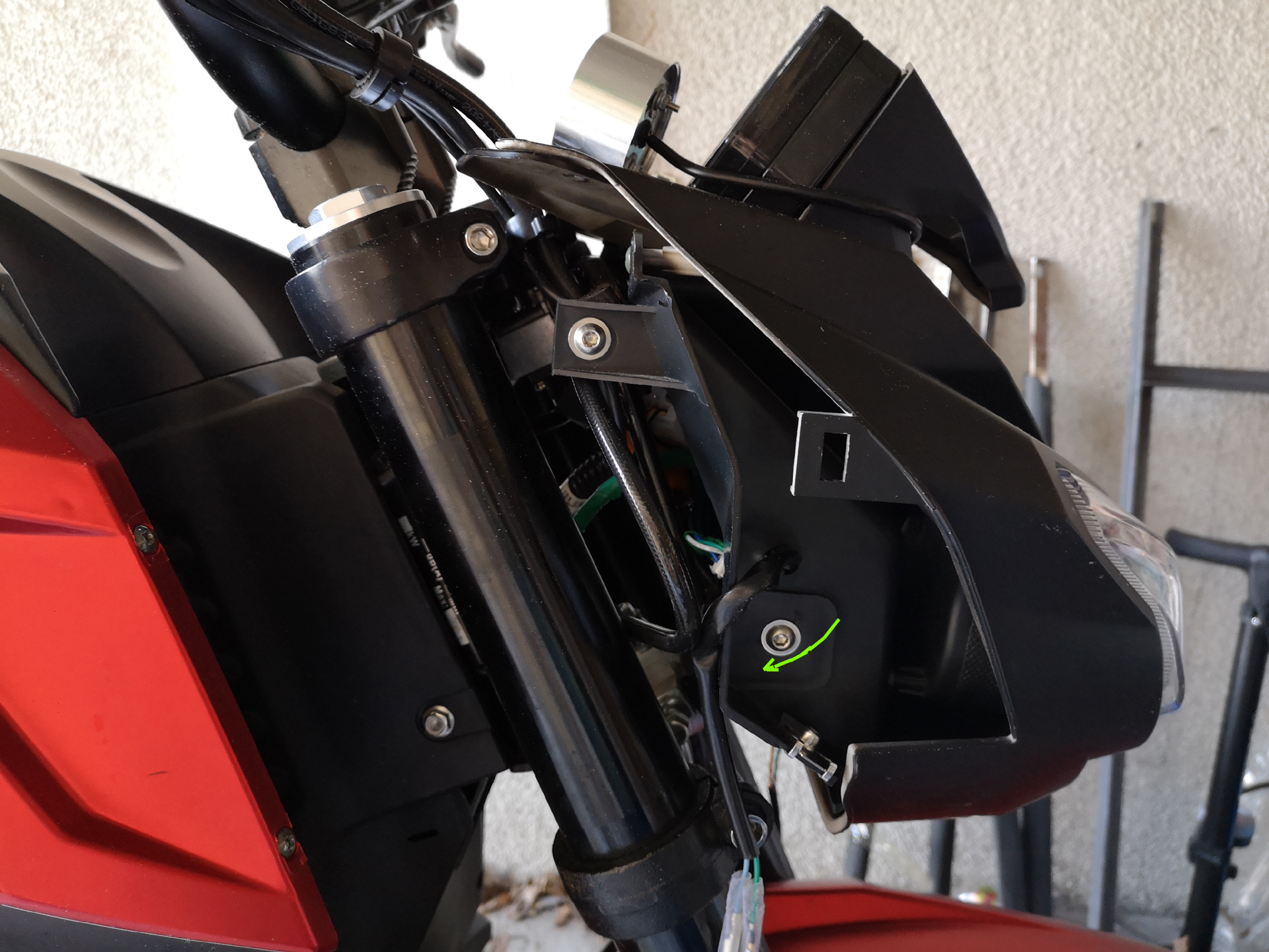

Bei meiner E-Odin 3.0 scheint mir der Scheinwerfer zu hoch zu strahlen.
Weiß jemand, ob und wie man das einstellen kann? Bisher konnte ich keinerlei Einstellungsmöglichkeiten finden. Und der ganze Aufbau wurde, bis auf die kleine Verkleidung vorne, komplett zusammengebaut geliefert.

Hilft Dir vll. viewtopic.php?p=255851#p255851 weiter?

Hallo Pfriemler,
der Hinweis war sehr hilfreich - vielen Dank.
Wie dort beschrieben, werde ich das vermutlich ähnlich hinbasteln müssen.

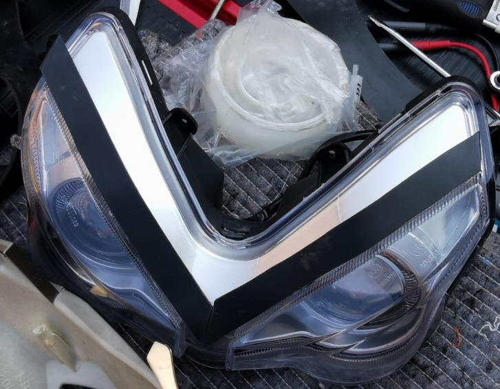

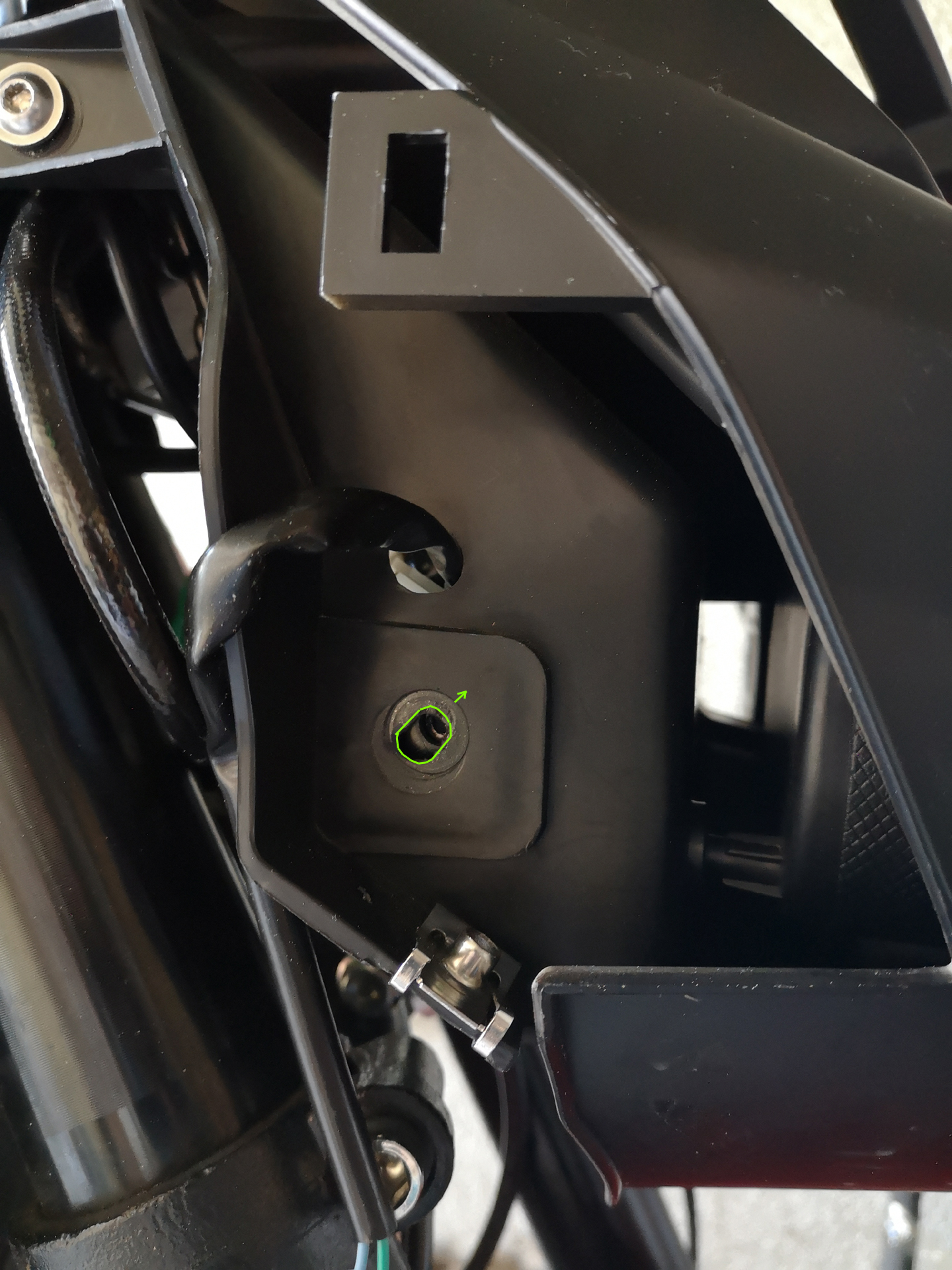

My bike has had a new rear shock which I think set the headlight too low.
I tried the repositioning of the mounting screw but it was too far down. So more adjustment was required.
I had to dismantle the headlight back to the light itself to make this change.

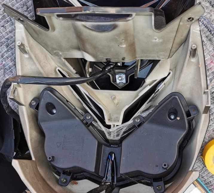

I removed the back plate from the headlight which is the part that the mounting screws go in to. This was not too difficult, but mine was broken due to some past time when the bike has fallen. I repaired it. There are two features at the top of the headlight behind the speedometer that needs a flat bladed screwdriver to carefully free.
.. I then removed the 6 screws around the light, and installed spacers (actually a nut) under the upper middle two screws to raise the beam. I reinstalled the lower 2 screws, leaving the others off.
To lower it, then this could be done on the lower screws.
I calculated the angle needed, then made a simple calculation on the thickness of spacers needed, based on the distance between the top and bottom screws.
before I reinstalled it, I added a filler at the top of the bulb, to avoid a gap above the light bulb. Otherwise, water and weather intrusion.
I used a strip of double sided 2mm gel tape (the sort shown in the top of image), and then cut a strip of 2mm rubber sheet of the same size as the gel tape and stuck that on the other side, so it looked like this. it is what I had. There may be simpler adhesive tapes to do this.

I like to see when anybody thinks out of the box and goes his way. At least I am not alonebob2.0 hat geschrieben: Fr 20. Sep 2024, 19:04 My bike has had a new rear shock which I think set the headlight too low.
Here you could save time if you have read one Jeff´s old post about widening bottom holes. You did it your way so you can be proud of yourself

I did try that way but there was not enough movement possible. It would have been preferable.
At first I just put a cable tie through the hole and this held it at the furthest end of the bracket. The top plastic was already bending. This still did not raise it enough, so it had to be more dismantling. I did see that and wondered how.
I have thought since whether it might be possible to drill a hole from the front to those screws and mount the light on springs. Then, it can be adjusted from the front. The holes could be filled with a cap. But this is complicated and I think it would not take more than 20 minutes now I know what to do, if it needed it again. It is just the mounting/backing plate you have to be careful with, but it is not difficult.
