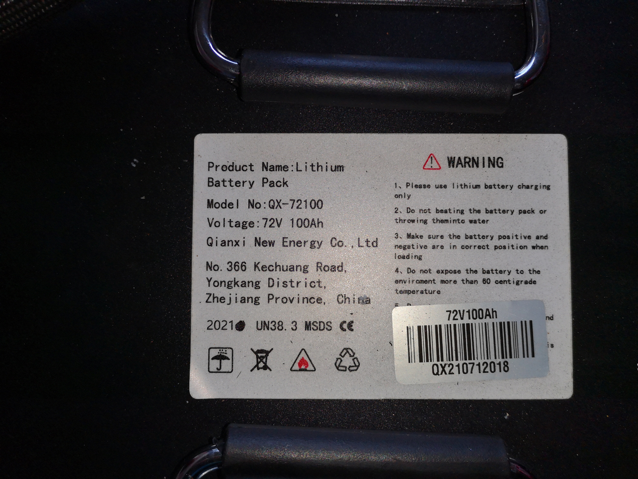

Not to forget: there is an easy way to determine whether your battery is a 100Ah or a 120Ah model. Just look at it's label :mrgreen:

Label says 100Ah.
It does not have that bar code though. Maybe it was a prototype 120Ah? :D
