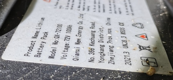

My question to you is whether I have a 120Ah capacity, because it seems very good to me if that was 7.2 kWh. BUT when I charge it up it uses 1kWh per 10%.
So, it's either doing about 14 miles/kWh (which seems very high) but charging up at 70% efficiency (which seems very low).
Or, it's actually 120 Ah (it says 100 Ah on the battery itself), doing 11 miles/kWh (seems about right) and charging at 85% (seems about right).
Do you have a way to calculate how much charge goes into your battery, and what your efficiency is when riding?

Maybe you really have a 120Ah battery (or something in between, maybe a good 100Ah with about 110Ah real capacity).

Not to forget: there is an easy way to determine whether your battery is a 100Ah or a 120Ah model. Just look at it's label :mrgreen:

Label says 100Ah.
It does not have that bar code though. Maybe it was a prototype 120Ah? :D
