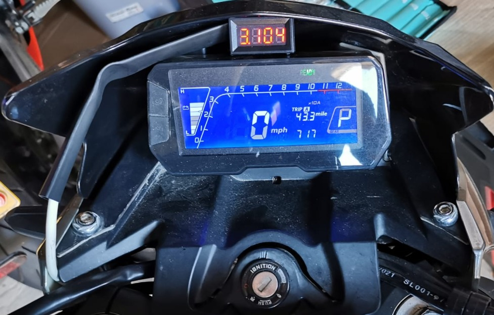

I wired it up, to get an idea of what it would tell me.
It turns out this is way out anyway, the meter seems quite a low impedance for a voltmeter, maybe 100kOhm. OK for reading a battery directly (li or LA) but not a high impedance divider like I put in.
So, if I want to change the scale then maybe I will rig up an opamp with a trimmer so that I can tune the scale to where I want it.
I still have come to the conclusion that the 'bob' unit is a brilliant innovation for NMC cells. 1 bob = 1.05 V. On this scale, if the leading digit is '4' then it is a fully charged cell, if it is '2' then it is too low and should not be used. '3' means 'ready' and the digits after it are an approximate percentage. It's, dare I say, brilliant! Slightly troublesome from an OCD-engineer's perspective, but I can get over it.
As it is atm, this reads 3.5 at fully charged, and it'll be discharged by 2.5.
As for whether it is useful or not, all I can say so far is that it is very distracting! You keep watching it for changes and the voltage dips and returns. Eyes are needed for the road, not for watching interesting electrical experiments!
