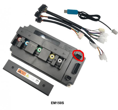

In this place?
My motorcycle does not have the wiring that goes in the red
didithekid
Beiträge: 6968
PLZ: 53757
Re: VOTOL-EM-150s controller
Beitrag von didithekid »
Exactly, this is anti theft. The 16-pin connector in the middle is communication/swiching and the lower 6-pin ist motor-hall/temp.
You can order the wiring harnes of VOTOL Controller at the same shop:
https://de.aliexpress.com/item/10050039 ... 03677%21sh

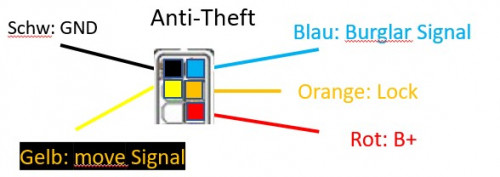

ColorCode of the alarm wires:
Maybe, the alarm function has to be activated in the VOTOL-Software page 5 (port settings).
