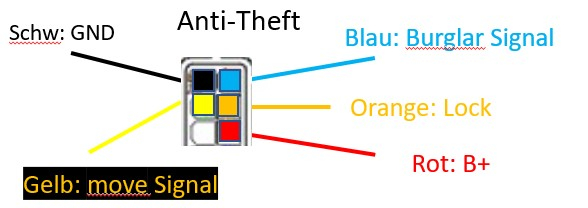

the VOTOL 150(s) has an anti theft wiring in the 8-pin-socket (5 pins active), which is open (without connector) on Your foto on page 1.
There are chineese anti theft alarm devices to connect to this wiring. May be this set fits:
https://de.aliexpress.com/item/10050035 ... 70106%21sh
My (alternative) fardriver controller does also have five (active) wires to connet an anti theft alarm device. (chineese standard?)
Greetings

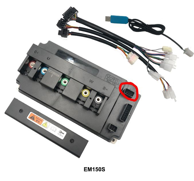

In this place?
My motorcycle does not have the wiring that goes in the red

Exactly, this is anti theft. The 16-pin connector in the middle is communication/swiching and the lower 6-pin ist motor-hall/temp.
You can order the wiring harnes of VOTOL Controller at the same shop:
https://de.aliexpress.com/item/10050039 ... 03677%21sh
ColorCode of the alarm wires:
Maybe, the alarm function has to be activated in the VOTOL-Software page 5 (port settings).
Greetings
