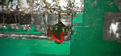

Some picture of the inside.

That's exactly the problem that Sylvio has.... and it seems to be the same bms (look at his picture).
His battery still has some charge (about 77.2V), but couldn't be charged anymore.
Neither using the fast charging port, nor the anderson connector.
When you connect a charger to the battery, the voltage rises immediately to 84V, and the battery doesn't charge. Of course any "intelligent" charger switches off the current delivery then (believing the battery is full).... just to notice that the voltage at the output then drops below 84V, so the charger sets it's output again to 84V... and that repeats continuously (without any current beeing delivered into the cell packs).

I have the same BMS with the same problem. The circuit board can be removed relatively easily from the silicone. But be careful, I solved it with a piece of wood.
In my opinion, the cables must be soldered to connection 19 and 9a. There is exactly half the battery voltage then.

Mine is clear, some components are fried :)
First try to unsolder every one and solder new in place.
Really hard to unsolder even with a good soldering Iron.
Hard to find the same reference too ...
So I will replace the BMS by a New one, with bluetooth,...

Woah, sorry, but this looks awfull!
You have bridged the FETs with solder over the traces between source and drain. So it may work with no or little load.
It seems like you don`t know what you are doing.
Trust me, it would be a better way to remove the BMS completely, because due to the (accidentally?) bridged traces it wouldn`t be able to cut off anyway.
I bet these traces will melt or burn under load.
Please don`t post such pictures in an open forum and don`t try to convince others to do the same!
Kids, don`t try this at home!
SCNR!

Unfortunately I didn't do anything to these photos. They are original. I simply removed the silicone and the first burnt components.
But everything is original, 100% made in china... the terrible welds and the wire brigde too...
