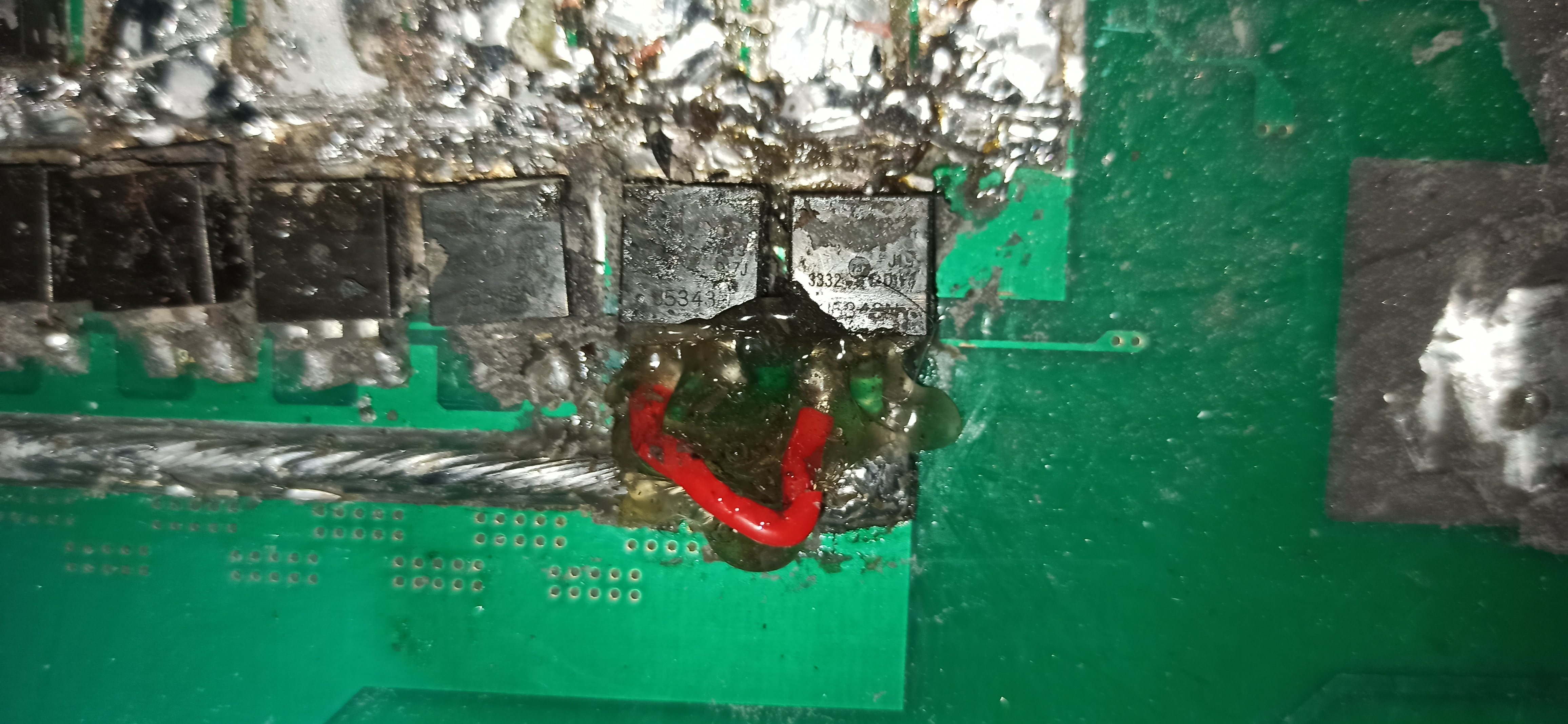

Mine is clear, some components are fried![]()
First try to unsolder every one and solder new in place.
Really hard to unsolder even with a good soldering Iron.
Hard to find the same reference too ...
So I will replace the BMS by a New one, with bluetooth,...

You have bridged the FETs with solder over the traces between source and drain. So it may work with no or little load.
It seems like you don`t know what you are doing.
Trust me, it would be a better way to remove the BMS completely, because due to the (accidentally?) bridged traces it wouldn`t be able to cut off anyway.
I bet these traces will melt or burn under load.
Please don`t post such pictures in an open forum and don`t try to convince others to do the same!
Kids, don`t try this at home!
