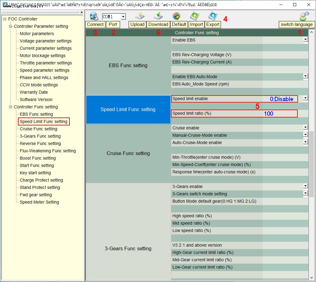

I wrote a tutorial for scooters Vastro Geco/NOD E-Run (Ugbest)
Tutorial for hacking maximum top speed in firmware for electric scooter with controler LingBo LBMC072122HK2X
(Vastro Geco E-Grace, Ugbest A9 UR8 I9, NOD E-RUN, NIU, Golden Motor and HK2X familly...)
This operations apply to standard LingBo HK2X controlers (not locked or specific), in order to remove software limitation of maximal speed, which is dependant of motor and battery.
Required tools :

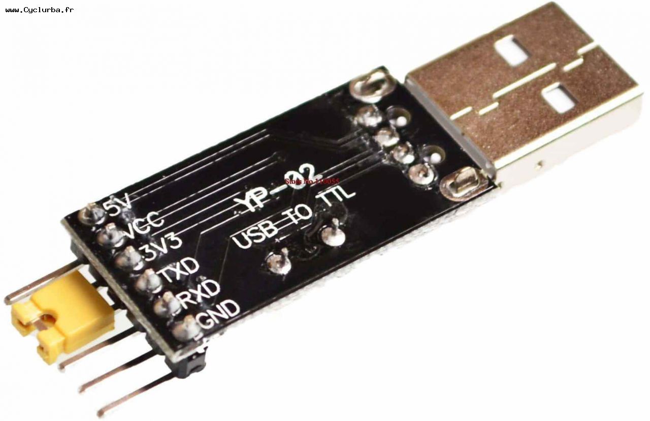

- USB TTL Converter CH340G CP2102 PL2303 UART FTDI Arduino 5V + 3.3V : AliExpress - ebay - Cdiscount_ - AliExpress - Amazon

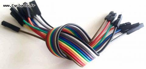

- Cable Dupont 10P male/female Arduino : ebay.de - ebay.fr - AliExpress
- optional : USB male/female prolongator, to put PC far from scooter
A. On USB TTL Converter, connect cap on jumper 5V and Vcc , in order to use 3,3V
B. Install driver (CH341ser.exe) / Connect USB TTL Converter to PC or laptop
C. Turn off scooter and disconnect battery
D. Optional : disassemble trunk under seat, to access and identify controler LingBo LBMC072122 HK2X
E. Open trunk under seat and search for 6 pins connector from controler
F. Connect 4 cables between USB TTL converter and 6 pins connector from controler on scooter, as explained
USB TTL Converter Code > Color on controler 6 pins connector
USB 3V3 > RED (3.3V)
USB GND > BLACK (GND)
USB Tx > BLUE (Tx)
USB Rx > WHITE (Rx)
GREEN and YELLOW cables remain not connected
If connexion error, switch pin Tx and pin Rx
G. Download and execute LBMC GUI 4.0.0 - drive.google - Dropbox - Lingbo-MC
1. Select English language with right top button (little fellow with bubble)
2. Select COM port used by USB TTL converter in Windows devices manager (ex: COM3)
3. Click on Connect button
4. Note values and backup parameters to a Backup.FOC file, with "Export" button
5. Go and modify "Speed Limit Func setting":
> "Speed limit enable" = 0:Disable
> "Speed limit ratio (%)" = 100%
6. Write parameters with "Download" button and check/read with "Upload" button
Version note LBMC GUI 4.0.0 - Modified : original "Upload" button modified to read, original "Download" button modified to write
7. Disconnect and test settings
LingBo LBMC GUI v4.0.0
