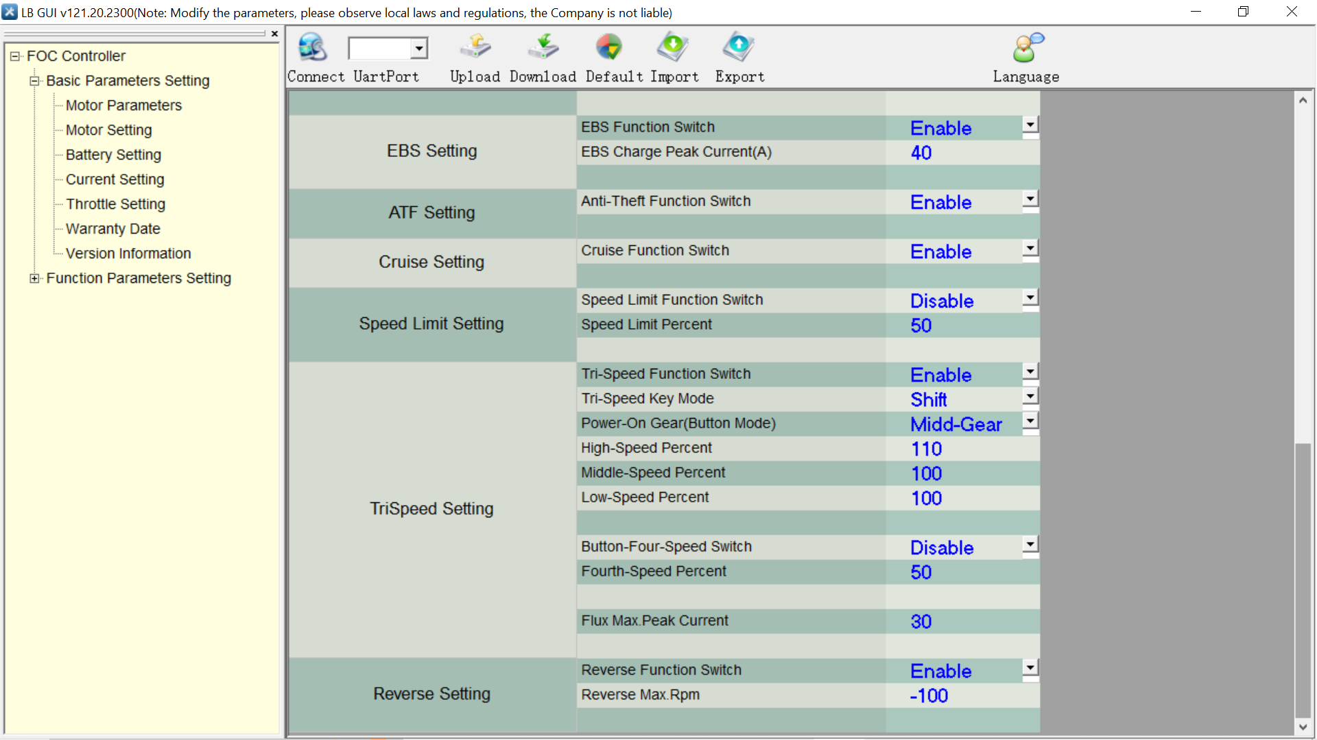

@deadropine
Can you provide the current settings of your 72122 HK3A controller?

Re: Tromox Mino
@vlad_vy
@derdude
Attached my setting for the lingbo 72122 HK3A. Main differences are the max rpm (3000) and the high speed percent (110 %). Do you think it would be possible to somehow build in a serarate GPS speedometer with R485 communication and connect it to the display or to the VCU?
@derdude

1. You can't use different manufactures devices to communicate over RS485 bus. Most likely they can't to communicate. The RS485 is physical layer protocol, we don't know high level protocol (Modbus or something else) and devices ID.
2. It looks like "Motor BEMF Constant" is way high for inrunner motor.
Ke = V peak / ω no-load = 1 / Kv
so Kv = 1 / Ke = (1 / 90) * 1000 = 11.1 (rpm/v), max. rpm = 11.1 * 64.8V = 719 rpm
It looks like LB GUI display Ke in V/krpm. Max phase voltage will be about: 72V * 0.9 = 64.8V. Motor BEMF Constant will be: Ke = 64.8 *1000 / 3000 = 21.6 (V/krpm)
You can try export the current settings, edit FOC file to change "Motor BEMF Constant" to 20 (offset 0206h: 00 14), then import FOC file. Check the "Motor BEMF Constant" is really changed to 20. Check "Motor BEMF Constant" after the Mino run, may be it calculated by controller at motor start.
3. Also, usually, to remove speed limit, the "Speed Limit Percent" is set to 100, then disabled.

Re: Tromox Mino
I had imported those parameters and used the Controller in the bike. Worked. BEMF was not changed. I think it has no influence.

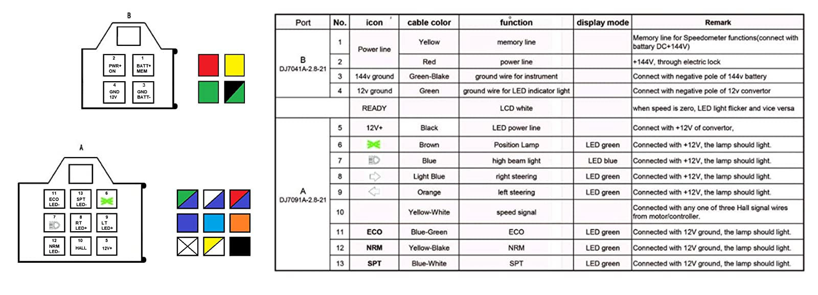

@deadropine
I'm planing to use QS Motor CT-22 48v 144v programmable electric motorcycle speedometer. ===============================================================================

I will not use backup power wire for RTC clock (yellow wire), so I added backup battery (CP2032) to RTC chip (DS1302). I unsolder pin 8 and solder two thin wires to pin 8 (red) and GND (black). Other wire ends solder to battery holder (from old PC motherboard). The speedometer PCB has not space for battery holder, so I wraped the battery holder with foam rubber and place it in bottom part of the speedometer body, under speedometer PCB.

It has the similar exterior, but very different inside. It use CAN bus. It has backup battery for RTC clock. And so on.
