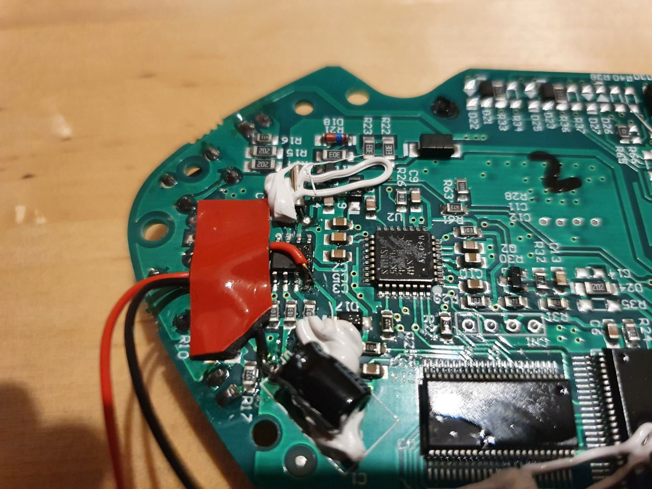

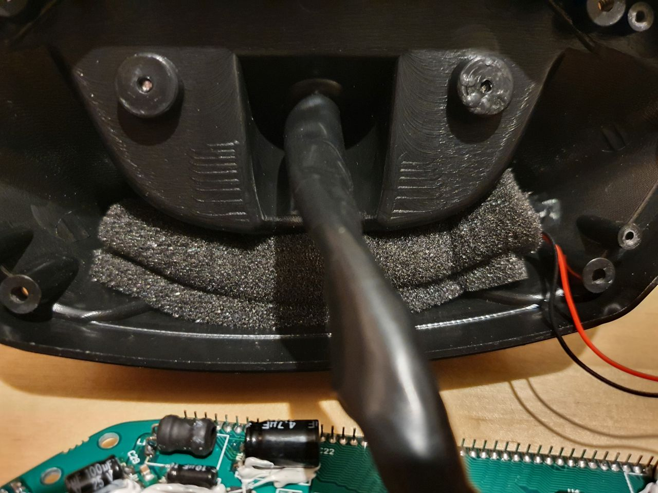

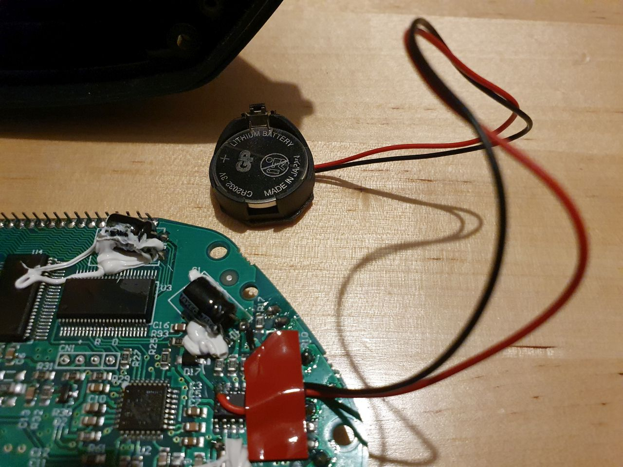

Pin 8 of DS1302 is desoldered from PCB and hangs in the air. Red wire soldered to pin 8, black wire soldered to GND ("-" of capacitor). The wires are fixed to PCB with 3M adhesive tape.deadropine hat geschrieben: So 20. Nov 2022, 20:46 @vlad_vy
Can you post a picture of where you attached the battery holder on the chip?
In time assembling the speedometer, one self-tapping screw ripped off the thread in the plastic stand. Replaced all self-tapping screws with M3*16 screws. Before tightening, lubricated the screws with grease, so as not to rip off the thread again.
