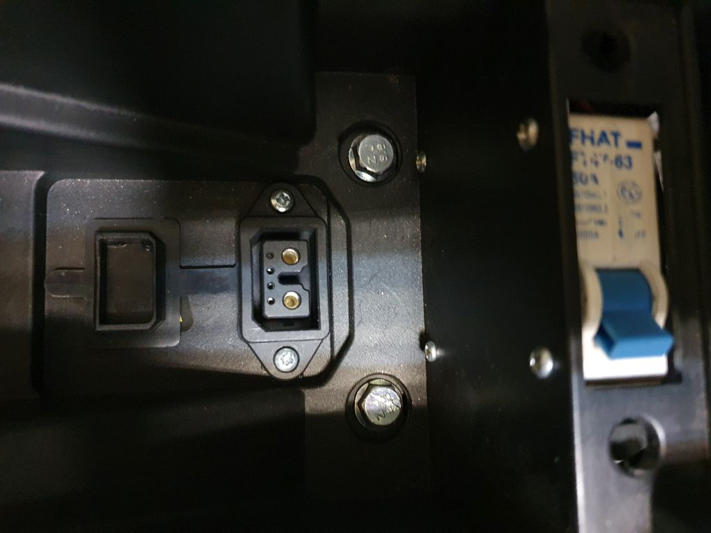

The charge connector under the seat fell apart for no apparent reason:
New connector:
New connector:

Thanks for the pinouts! So, if the charger connector only has connectors for + and - it doesn‘t send any other information (e.g. RS485 data) to the charger? My charger has a single data pin, which is most likely GND.

I think the charger has not any serial communication. I can check the battery connector pinout and we will know what can do that single data pin in the charger connector.

Battery connector pinout (cable, male connector):
________
1| o o |2
3 \ = = = = /6
1) +60V
2) GND
3) NC
4) GND
5) RS485A
6) RS485B
So, the single data pin (3) in the charger connector is not connected to anything.
