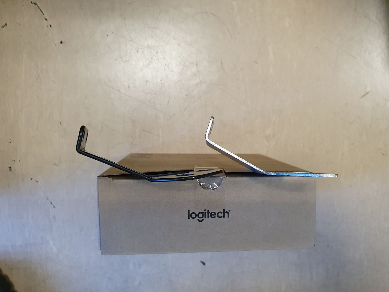

Manufactured the CT-22 speedometer mounting bracket. All speedometer indicators work, except Eco and Park indicators. The real-time clock is still running on a backup battery, the time is accurate.
By the way, the on-board computer (VCU) is no longer needed, it is dismantled and lies on the shelf.
The CT-22 speedometer mounting bracket was cut out of such hardware: A perforated angular plate 105x105x90x2mm.

Speedometer mounting brackets, original and custom.

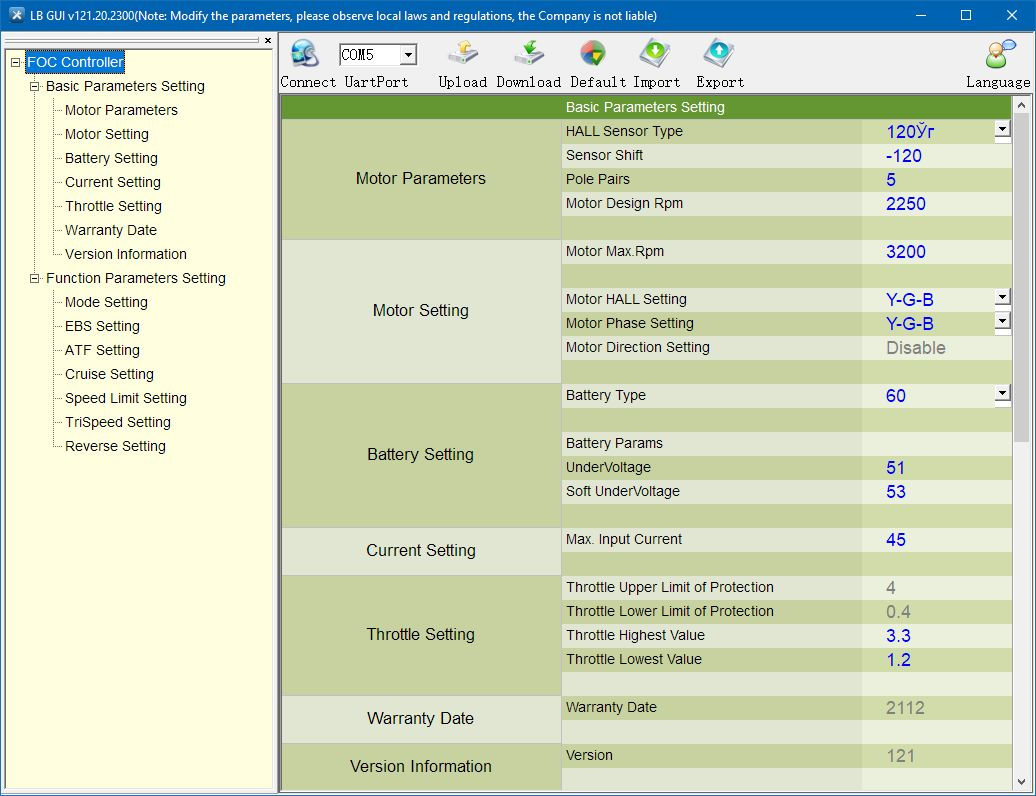

Successfully rearranged the contacts in the controller connector. Now the CRUISE button works as CRUISE, and the READY button works as reverse. During testing, I realized that the reverse speed was indicated not in percentages, but in RPM, I had to change the "Reverse Max. Rpm" back to -100 rpm, it is about 2.5 km/h.
Current settings of the controller LBMC072122SHK3AP-M29 (LBC100.029D)
